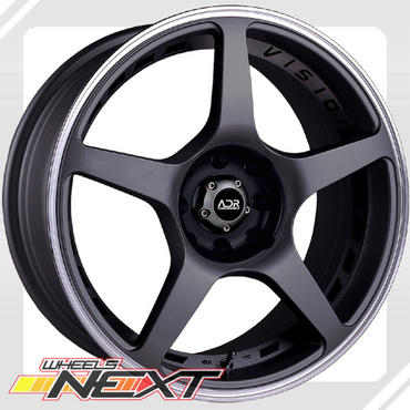

another option i was looking at this beautiful ADR vision that comes with package with tires and free shipping for $799. however its specs are 18x7.5(all 4 rims)
i really want the ADR visions cause of money and looks. but does the width really make a difference? is there a negative affect on the car when the width is only 7.5 in the rear?

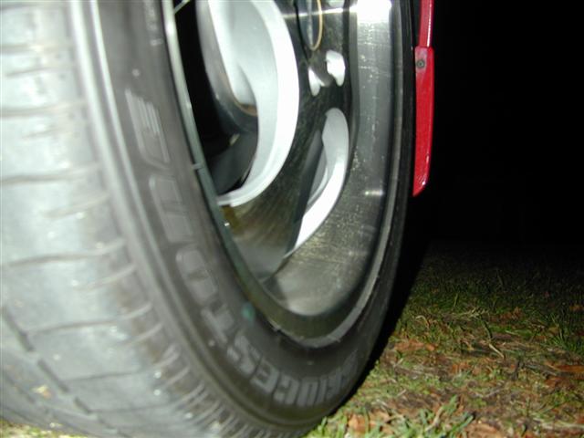

Here's a shot of rear 18 x 7.5 with factory potenzas 245/45. I actually found turn in easier, up front, because the sidewall sits up straighter. No problems with fitment. The tire looks a little meaty on the rim, but no troubles. Done donuts and took it to the 1/4 mile with no troubles. I'm replacing the whole setup though, because I want wider tires. If you plan on modding your Z, get the wider rims so you can run wider tires. 245 is max for 7.5. Its probably not even recommended.
