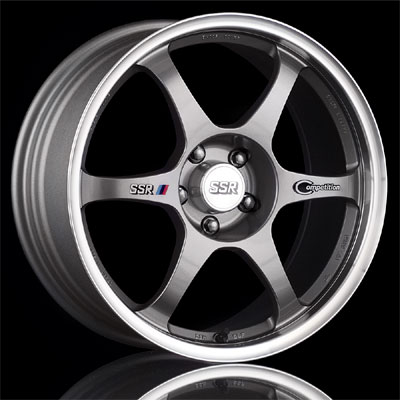

SSR Type-C /Competitions (forged)
Probally the lightest wheel for the money.
JDM Version: http://www.gruppe-s.com/SSR/SSR_z.htm
-will clear OEM Brembos
-lighter
USDM Version: http://www.tirerack.com/wheels/ssr/ssr.jsp
-dont really know if it will clear OEM Brembos?
-comes with centercaps
18x7.5 --- 14.5lbs (jdm)
18x8-------15.0lbs (jdm)
18x8.5-----17.5lbs (usdm)
18x9-------17.0lbs (jdm)
18x9-------18.1lbs (usdm)
18x9.5-----17.7lbs (jdm)
18x10.5----19.2lbs (usdm)
Comes in silver, anthracite, and gold for US version
Comes in a variety of colors for JDM Version:

Wow! I really like that wheel, looks and all. I may go with those.
Thanks everyone, for all the advice on this.

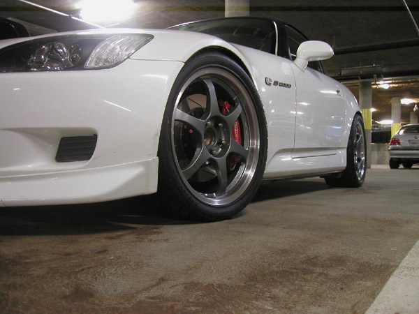

Keep us updated if you ever get these. I havent seen anyone that has done this setup, so you should be the first.
FYI: You may see bad articles about these on the internet about how they bend easily, but discount tire responded to these claims by explaining how it was a manufacturing error that has been corrected. Regardless, I would still get these. Just like any forged set of wheels, you should be carefull.
eml me if you want more pics.
