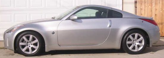

OK, I'll take your suggestion and go with it. Hopefully it will look OK even though I merely have the stock 17" wheels.
Pity, if they are $219 shipped, I wonder how much they would be picked up. A bunch was heading up to Performance Nissan today DOH! I have been feeling a bit under the weather or I might have gone.
