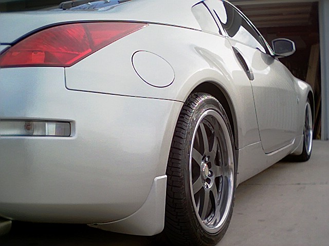

i have 1.5 inches adapter on my car and i think it looks perfect , rides perfect and had NO problems , had it for around a year , but everyone thinks what they are talking about... thats just my opinion..

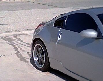

one more before i got them to the front , rear only
