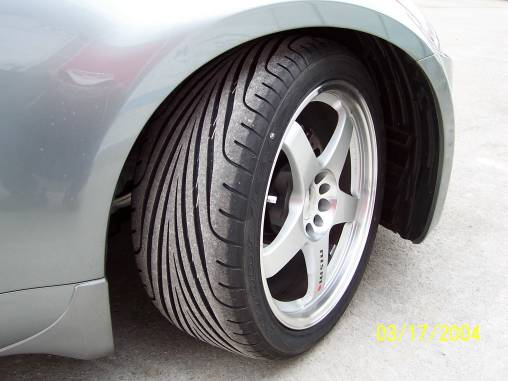

Can't speak for 19", but just put Eagle F1 GS-D3 245/40/18 & 275/40/18 on and the difference between these and the stock 18's were phenominal! Less road noise, smoother ride, excellent dry & wet traction, good grip and supposed to give very good wear for a hi-perf. tire. Expensive, but IMO well worth it.

Don't mean no disrespect, but a friend told me Eagle F1 is very noisy. Good to hear that they aren't. BTW, l love your tread pattern.

SirZ - The original Eagle's and F1's were a bit noisy, but the newest GS-D3's are sweet - no unruly noise at this point. We'll see after a few thousand miles......... I only have 200 miles on them now. Love the grip & handling so far as well.

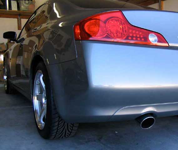

Again, I'm one who can't speak to the 19s, but I have Dunlop SP9000s 18s on my Nismos (245/40 and 275/40). I think it's a great performing tire, much better than the OEM Michelin Pilot Sports, IMO. I believe they they have cost/perforrmance factor out there. Needless to say, I am very happy with them.
