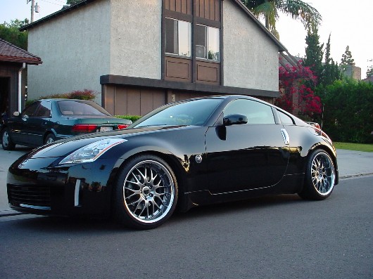

these are 19x8.5 and 19x10
you should go even bigger with the flare kit ...bigger tires if you already have TT these are 245/35 front and 275/30 rear
