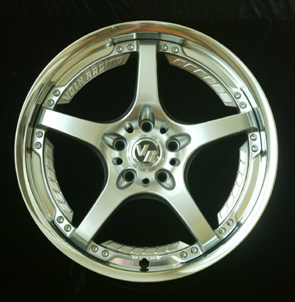

I just rec'd my 19" SF Challenge wheels, and included with the wheels are 4 hub rings part #73-6606. The G35 coupe 6MT isn't listed under applications....so, did anyone else use these hub rings when installing their SF Challenge rims?? The second question is that I ordered the Mercury Silver finish...on the box the color code is NS. Does NS = Mercury Silver??

maybe it was a typo because their other silver is spark silver so NS cant be spark silver
as far as the hub ring question...part #73-6606 means that the wheel hub size is 73mm and the car hub is 66.06mm
im not sure what your question is...are you asking if you can install these on the g35 coupe?....i guess you gotta find out what the wheel hub size is ... im assuming nissan uses the same size for infiniti and nissan..you should be OK

I didn't use the hub rings. I actually forgot, by time I remembered, I didn't feel like taking the wheels off again. I haven't noticed anything weird. No vibrations or anything. But try it, if they fit, let me know.
