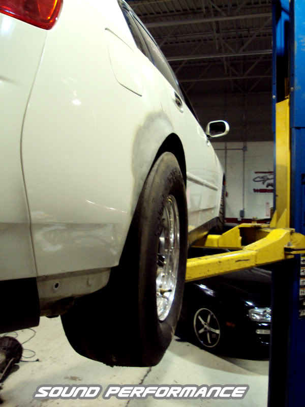

Vlad is very excited for the upcoming season. Before when the car was on the dyno, we couldn't do anything past 25psi without the tires rubbing. The fenders have since been very slightly widened and we had it back on the dyno to be sure it would clear the tires. All is good now!

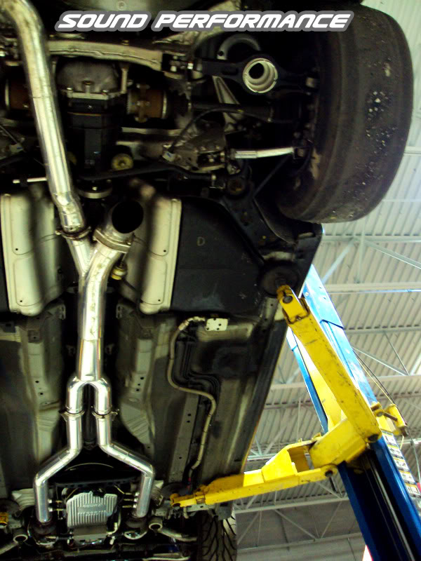

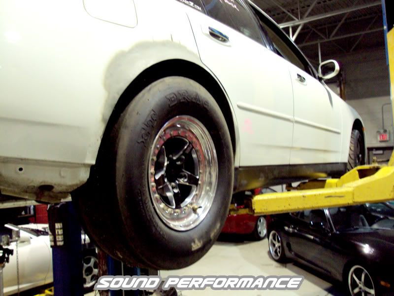

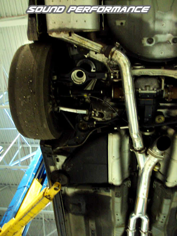

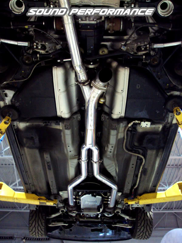

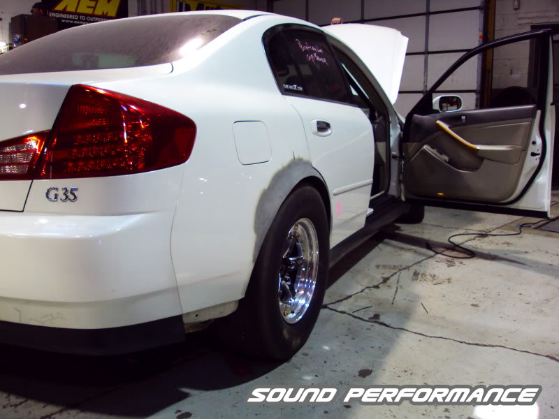

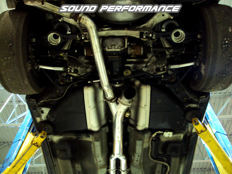

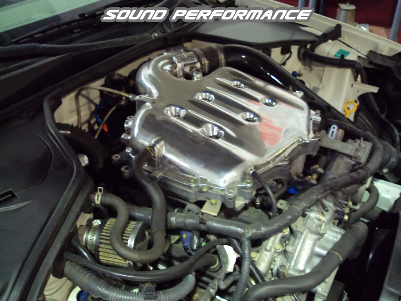

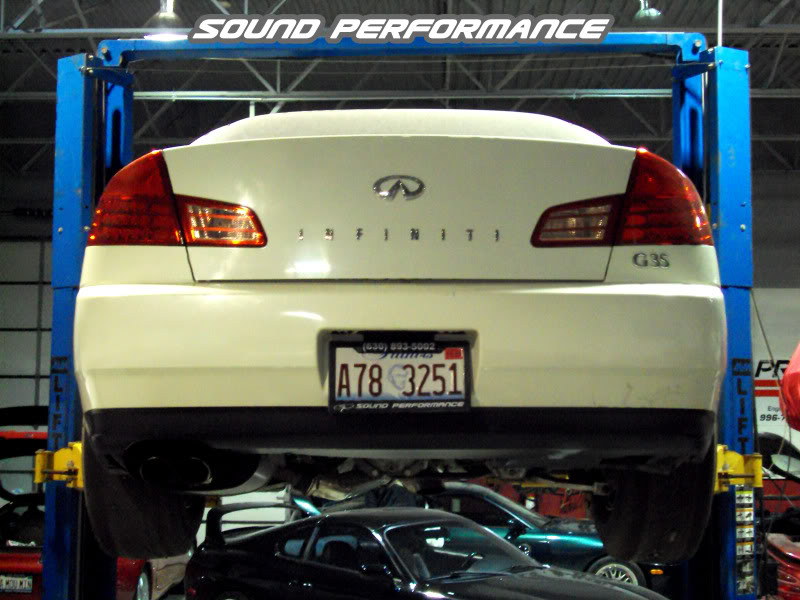

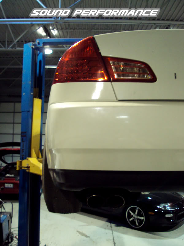

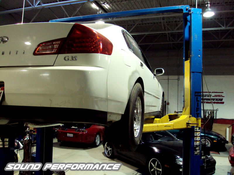

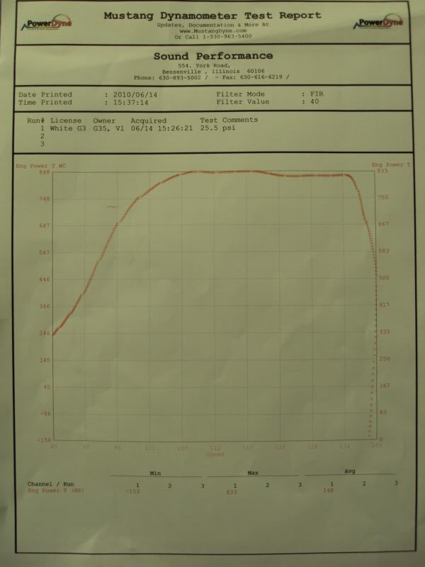

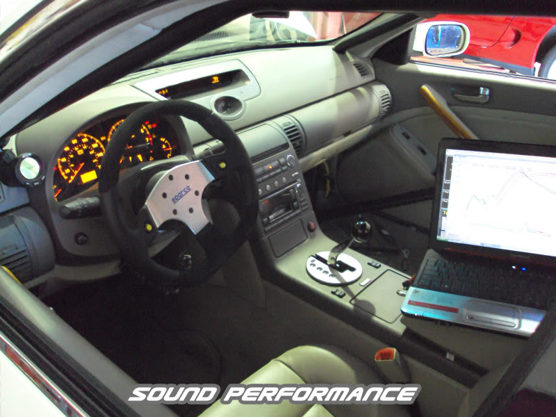

http://www.youtube.com/watch?v=jKdf6VOS7RY
The car makes approximately 1300HP to the crank with the TH400 trans!!
Final Number: 951whp @ 30psi
There is a lot of room left in this setup. The turbos won't lose their efficiency until well into the high 30psi realm if not higher. This will be an excellent start to get Vlad deep into the single digits.

awesome power thru that tranny! thats exactly how i have my exhaust as well
do you know the spring rate on those rear springs?. I wanna swap to those SPL toe arms as well. Toe bolts suck

This sedan picked up where the SP 350z left off. Will it run the same time or better? I see the custom diff brace with support on both sides. Very nice.
