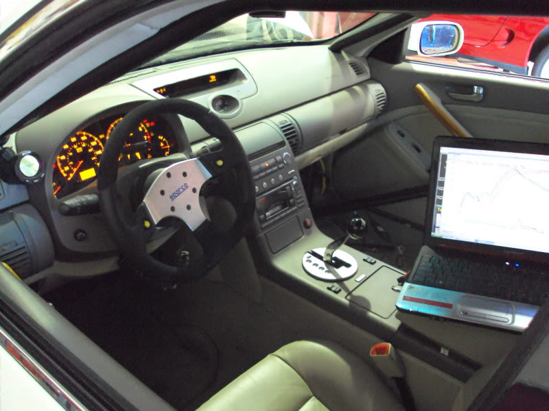

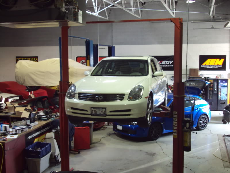

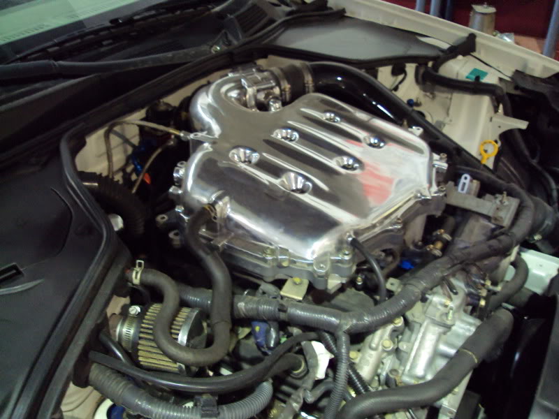

UPDATES!!!!

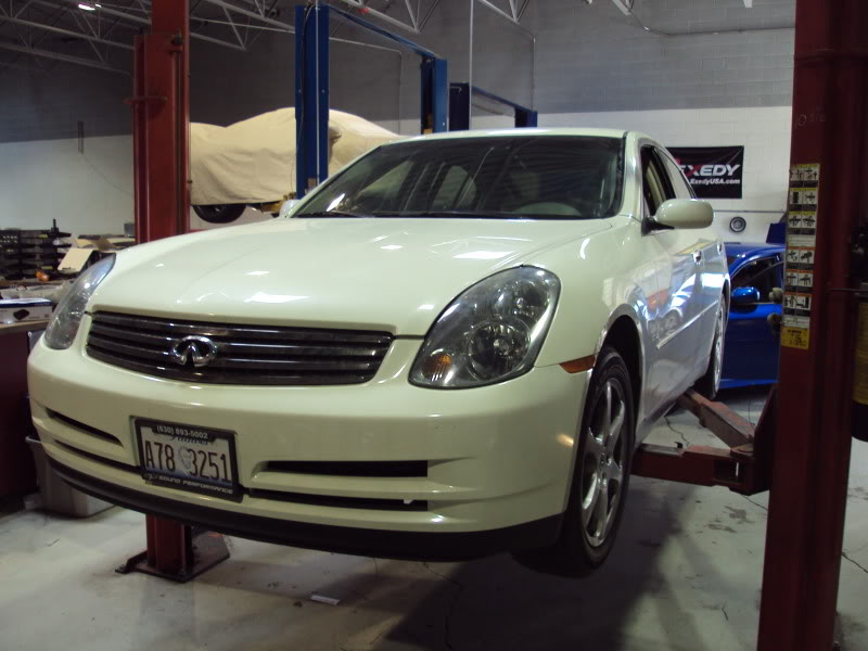

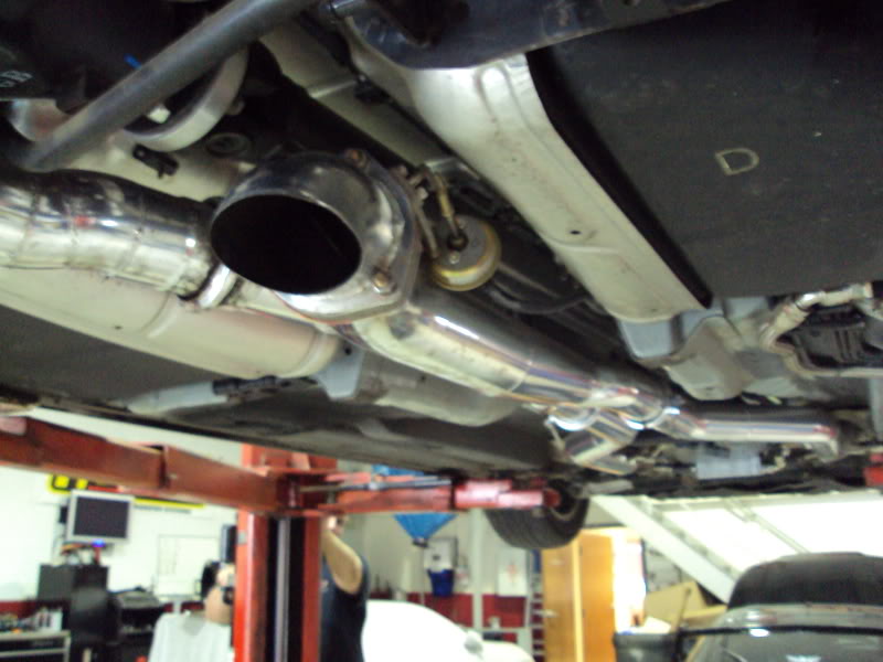

Vlad picked the car up yesterday. We finished up the CAN gauge relocation, iBoost control install, ProEFI software update, and did some final pump gas tuning. We also took all the measurements needed to see what we can do in the drag wheel department. I have the slicks and skinnies here but the wheels themselves have been difficult to track down. I am looking to Bogart and Billet Specialties with hopes of getting some meats under the fenders.
Vlad is getting his wheels and tires mounted and getting a professional drag alignment done and is bringing the car back ASAP so we can toss in some C16 Race gas and make the big numbers. Our Open House is next weekend on Saturday June 12th and expect to see this monster there!!
On 93oct pump gas, it made 640whp @ 17psi!!!! Larry was a giddy little school boy in the driver's seat on the dyno. I can't wait to see how Vlad likes it on the street. Here's a little video I put together as well as some pics:
http://www.youtube.com/watch?v=j6kuR7kS0J8

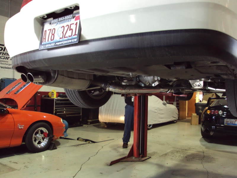

What is that on the differential. A brace?

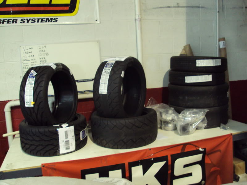

What street rims does he have to fit the 275 tires?

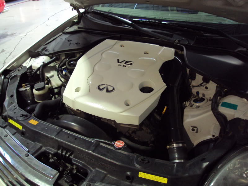

What is that filter by the battery cover?
Where does the hose from the PCV valve go?
Can the ProEFI with that CAN gauge be made to work on a stock Nav screen?

I think what is on the diff is two braces to try and eliminate wheel hope. My buddy has it on his Z but he just has one.

There is one of SP's Diff braces (same brace that is on the shop car, so it must do something right).
They made a real trick hidden catch can that is located where the battery was (battery relocated).

275? Thats it on the street, no doubt you will need more! You can get 285s or even 295s if you roll with the correct offset.

Originally Posted by Andrei
Thanks
What is that on the differential. A brace? SP Diff Brace
What street rims does he have to fit the 275 tires? 275 BFG Drag Radials
What is that filter by the battery cover? Catch can setup, battery relocated to trunk
Where does the hose from the PCV valve go? Eliminated PCV
Can the ProEFI with that CAN gauge be made to work on a stock Nav screen? No

The width isn't the most important part, it's how tall the tire is. Regardless, his tires will definitely be holding on for dear life!

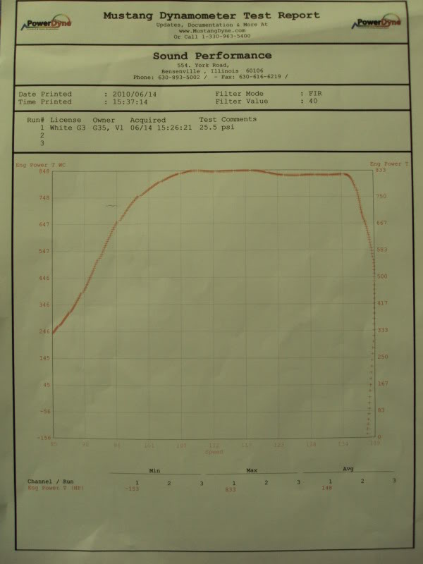

UPDATE: The car made 833whp @ 25psi (uncorrected) and 848whp @ 25psi (corrected). It was spinning the tires at that power level which won't do much for power numbers but it's going to be killer on the drag strip when it gets the power down. Look at that power curve!!
