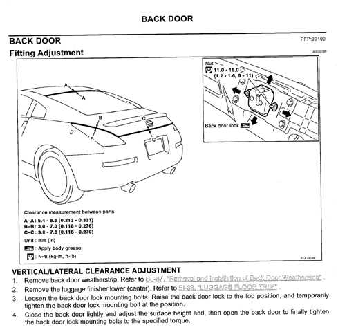

Can't you turn the 2 spring loaded rubber things that it closes on to adjust it. ( Not the technical term) The ones that are about 2.5 inches long. They are above the 2 main lifts.

Before you take it in check this page to see if the allowable gaps are within yours, if so they probably wont do anything, or if you can figure it out adjust yourself as described.

Good advice, I had the same problem w/my 240Z, but it was easy to get the proper alignment.
