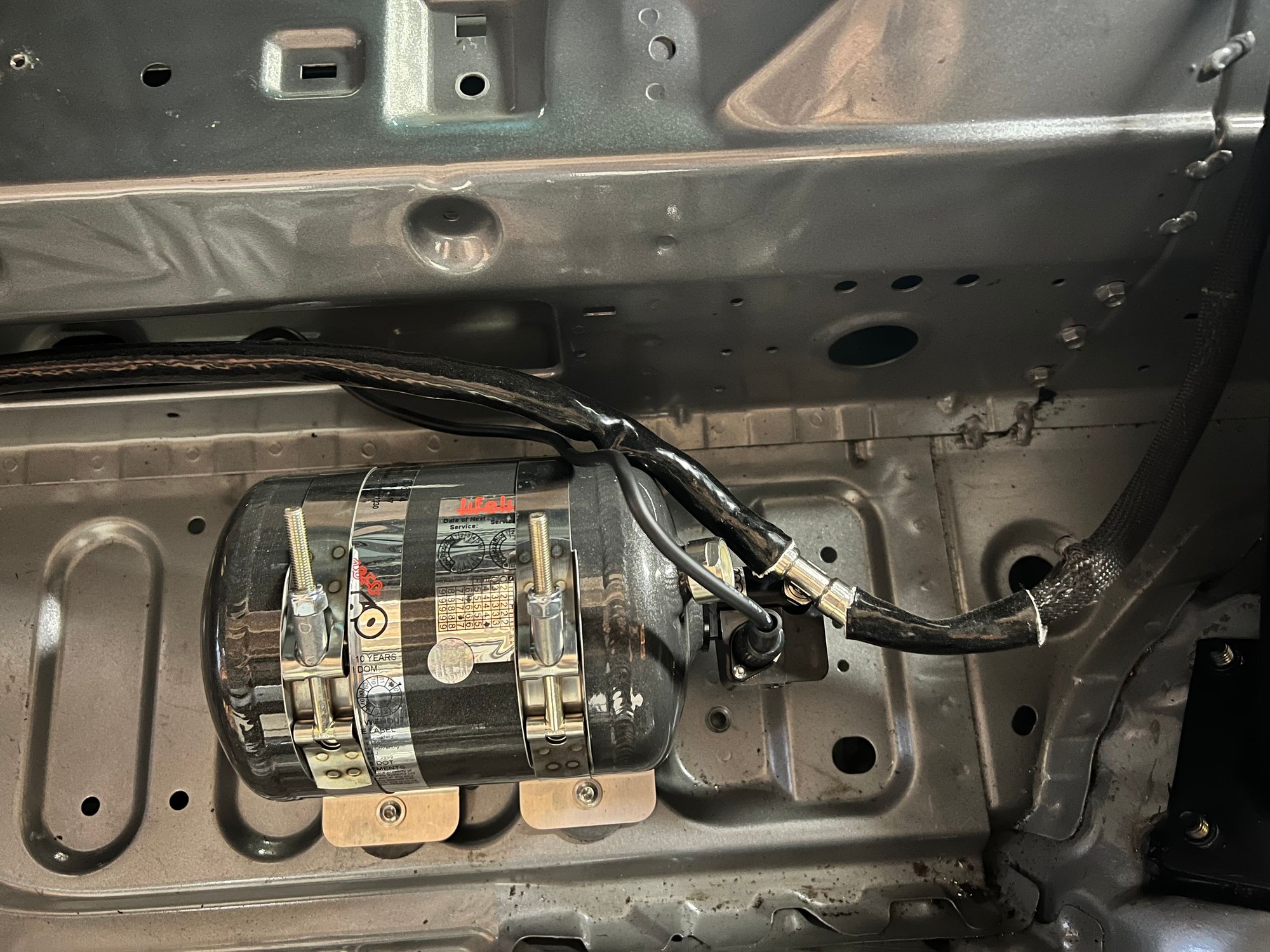

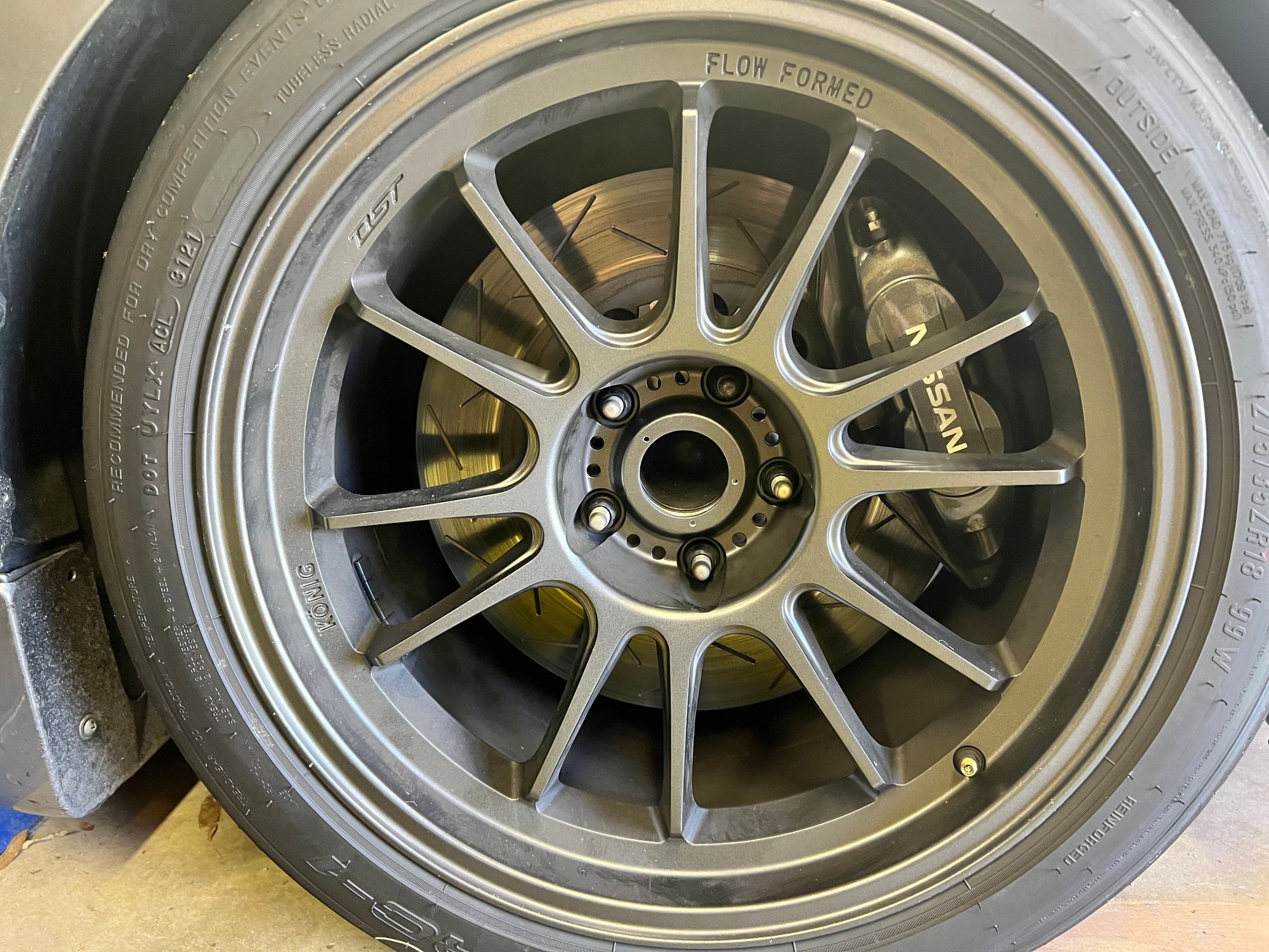

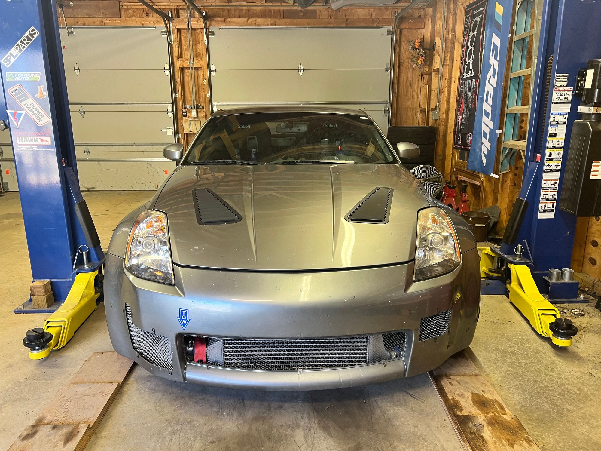

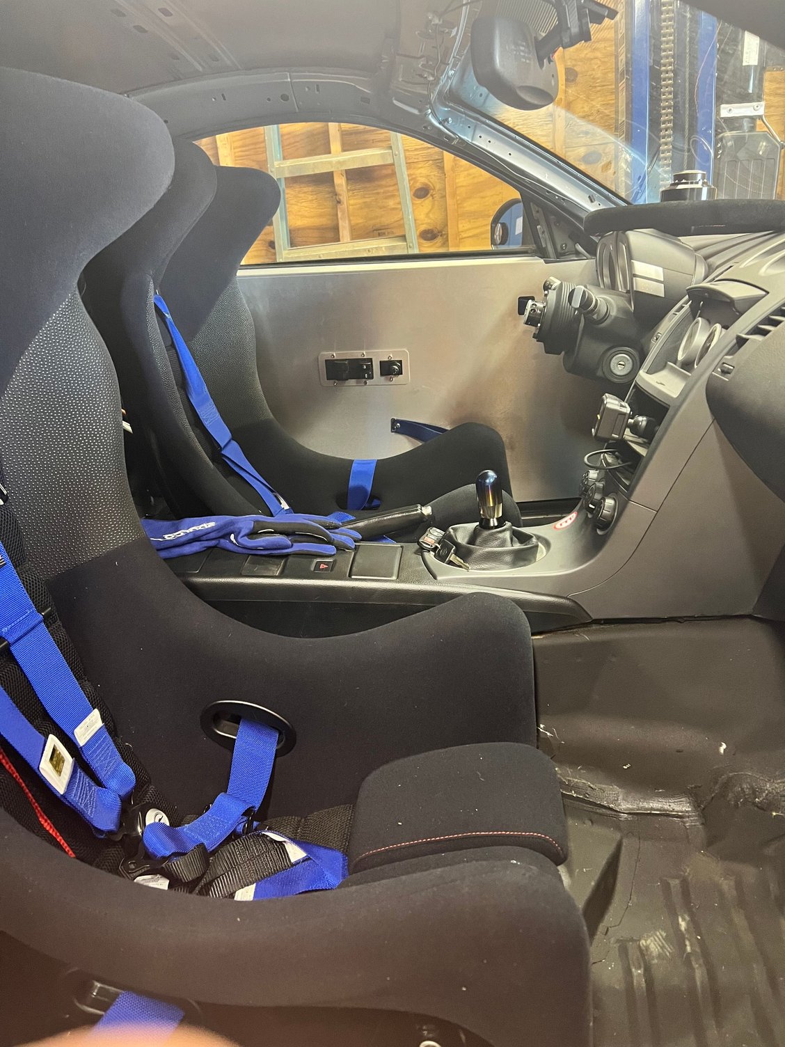

Figured I'd start a thread of my build evolution. The Z was purchased in 2005, never saw rain and was my baby. Put some bolt on mods and loved it, was my DD in college. Soon after I graduated I put a GReddy twin turbo kit on with all the supporting mods and made about 420 HP. I drove it rarely and mostly was a garage queen. In 2019 I decided to take it to the track and see what it can do and if I liked it. I was hooked and loved it, the car did well but I quickly realized how many problems I had with it, mostly heat related, I was seeing oil temps close to 300 degrees in 40 degree weather and tons of understeer with my staggered 19" wheel setup with no camber. George, a member on here was my instructor at CMP in NASA SE, it was good fun. Fast forward to 2023 and the car has evolved quite a bit. Its now gutted and a dedicated track car. Here are the mods so far I changed for the track:
18x10.5 konig wheels and 100 treadwear tires +15 square
Hawk DTC70 pads
Fortune 510 coils - true coilover in rear
All SPL control arms for camber for track, almost 4 degree in front
Various bracing around the car
Akebono BBK with Z1 2 piece rotors
ARP wheel studs
Gutted the entire vehicle
Lightweight lithium battery
Sabelt taurus seats
Works bell hub and quick release with a MPI wheel
Garmin catalyst
6 point harnesses with Kirk racing roll bar
Electronic fire suppression system
CD00A tranny
OS Giken diff 1.5
Koyo radiator and AC removed
Oil cooler / power steering cooler
Evans coolant
Hood vents
Brake cooling ducts
Im sure im forgetting some stuff, but you get the idea. Right now the car is at about 3100 pounds dry, Ive ordered a CF hatch and lexan glass for plastics 4 performance for more weight savings. I am getting more comfortable and getting faster on track, its a progression for sure. Once I get to the limit of the car, im going to start on aero stuff. Last week at VIR I ran a 2:11 so im getting better, considering I was running 2:20 at first. I'll upload some pics for you all. Enjoy
new turbo CHRA with jethot coating
rear, I have removed the mufflers and straight piped it
bracing
VIR last week
VIR paddock
lightweight lithium battery
engine bay
konig 18.5 +15 wth akebono BBK and Z1 rotors
Hood vents really let alot of hot air out
interiour
fire system

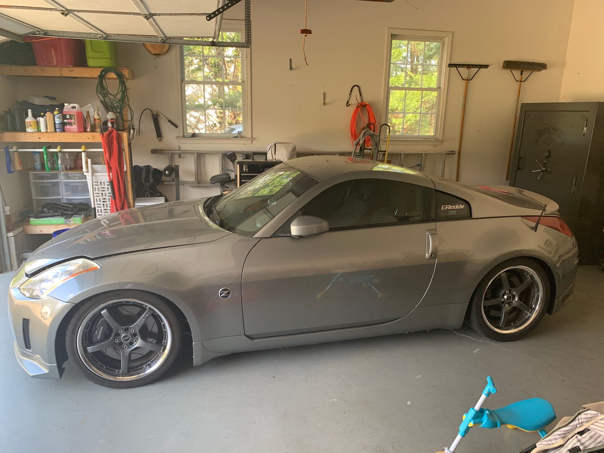

how it looked before it became a track car, never saw rain. Still only has like 45K miles.

those brake calipers look shaved. is that just lighting or did you do that yourself?
Old Apr 4, 2023 | 04:36 PM
Escobar's Avatar
Escobar
iTrader: (27)
Joined: Jul 2005
Posts: 3,579
Likes: 180
From: £ã§† CØÃ§† œ
nope just light, they are untouched. And yes im attached, I love the car, I do agree, I miss it on the road but theres no turning back for me!

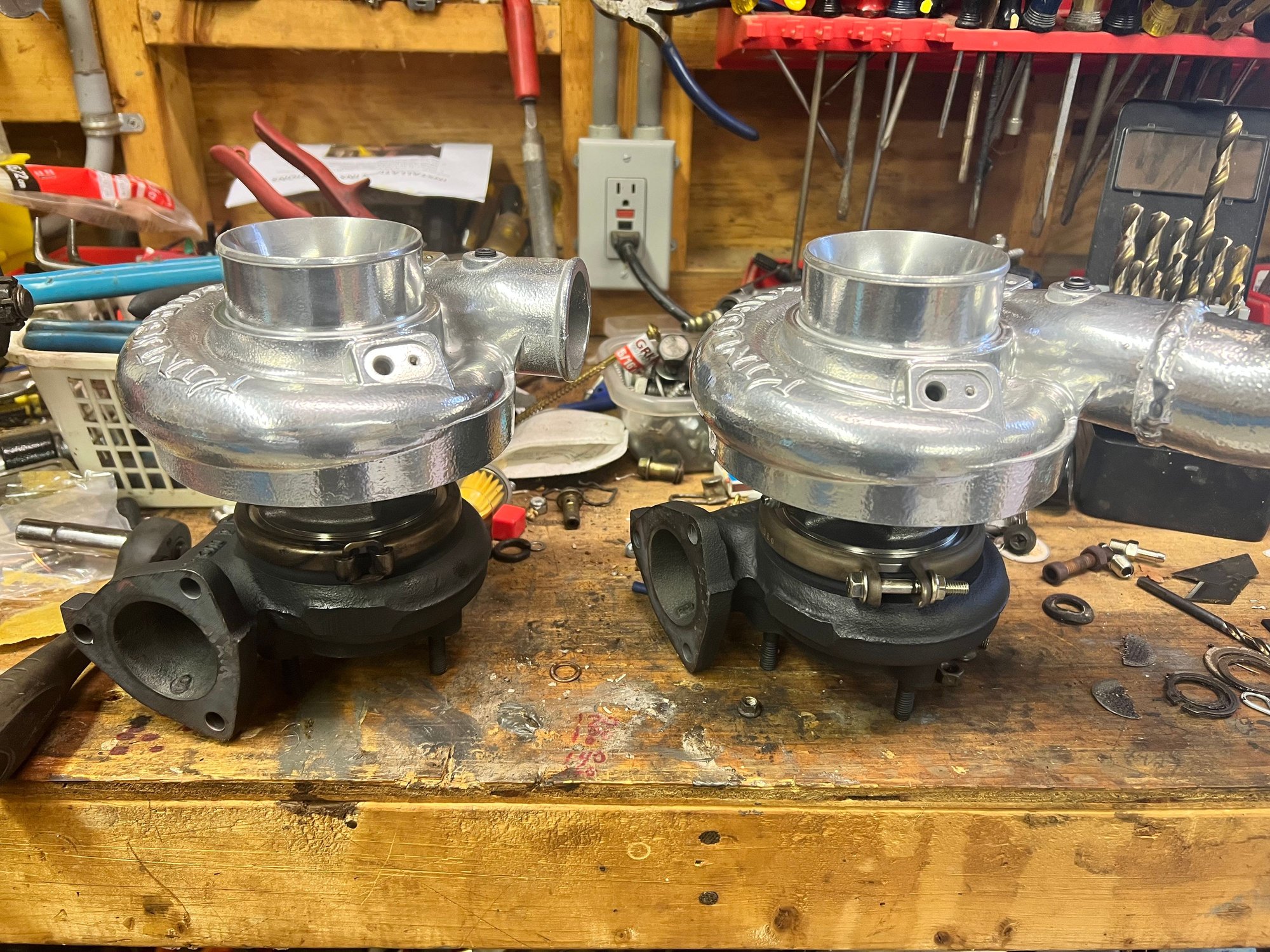

The two turbos look like a very tight fit in front! I can imagine sometime in the future crossing that tipping point but it's a challenge in California. The reason I'm considering the vortec centrifugal is because it is carb legal in CA. I think 400 hp (~350rw) is the sweet spot for this car. with bushing and suspension upgrades, this car handles better than a standard 911 or Cayman. I don't think a lot of people realize what a gem the 350Z is. diamond in the rough. I think it's a perfect track car. it really is just luck that this is where I started. based on my background I was more likely to start with a Mustang.
Old Apr 23, 2023 | 11:49 AM
Escobar's Avatar
Escobar
iTrader: (27)
Joined: Jul 2005
Posts: 3,579
Likes: 180
From: £ã§† CØÃ§† œ
yes I agree, I have always loved the Z but until I took it on track I didnt realize how quick it was. 400 HP is a excellent level for sure, enough to be fast but not ridiculous on track. The TT kit is extremely tight, in fact I had to pull the engine again this winter just to remove the turbos and service everything. The vortec is a great option, go for it!
