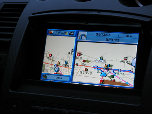

Default mine
Hi,
Here is my GPS navigation install. 7" LCD monitor with a separate GPS system component placed in the rear compartment. I control the navigation with this remote. I can update the map with the flash memory card. I'm in South Korea now, and Korean aftermarket GPS navigation products are far more advanced.
Later,
Jay
Attached Thumbnails Something about GPS Navigation System-113_1366.jpg   Something about GPS Navigation System-113_1356.jpg

wow thats nice leeboyny how did they u get a seven inch screen in there.

Originally Posted by leeboyNY
Hi,
Later,
Jay
So, you were in Yongsan when you took the picture? Are there many 350Zs in Seoul?
Do the Korean GPS systems include traffic information and re-routing? Traffic in Seoul is so bad, I wonder whether it would help.
I'm not Korean but taught at Yonsei University in 1974-75. My daughter is there now, attending summer school. She loves it.
