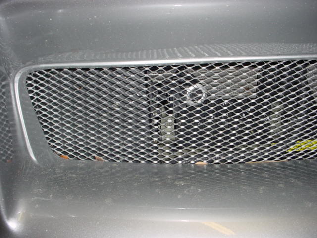

I have a camera mounted in the grille. This seems to be working out pretty good..have'nt hit since. I think it was $29 off ebay.
Here's a picture of it.

What do you search for (on ebay) to get that camera?

Can a camera like that output video on the factory Nav screen?

wow, more info on that camera please!

This is just a back-up camera(search on ebay for Backup Camera). The only problem was that the image was reversed. I run the image thru my DVD player reverse image option and it corrects it. I use a basic switch box to go from front cam, back cam, and dvd. Also, I mounted a power switch for the cams in this switch box which makes it easy and fast to turn them on.
Its painted silver because I was going to flush mount it under the front bumper but I just could'nt bring myself to cut a hole in the car...what was I thinking. The cam it strapped to the front mesh grill mounting bracket. The image thru the grille is very clear. The camera has been mounted for 3 or 4 months and I haven't had any issues.
