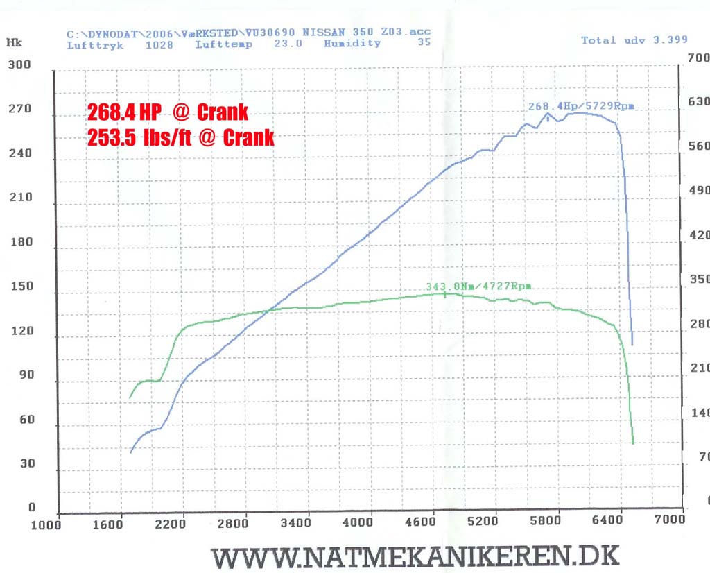

I've had it on the dyno and it does lack a little performance, but obviously not as much as I thought.. I'm not sure if it's because it doesn't act like on the road or what's going on, but I think it performs very weak on the street.
The dyno shows crank hp and torque, since thats the only way we dyno cars here in Denmark. The temp. and humidity has been corrected so it shouldn't be a factor.

I finally figured out what was going on!
It seems I have a bad Ignition coil (spark coil?). periodically cylinder No. 2 will misfire resulting in the car only running on 5 cylinders. It comes and goes. Yesterday the MI indicator came on and hte error code showed a bad ignition coil. A new one is on the way so everything is good!
