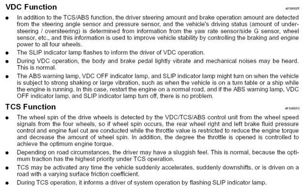

I think you are misunderstanding what is in the manual. The VDC does rely on wheel speed sensors, steering angle sensors, yaw sensors, lateral G measurements, acceleration measurements, etc. It then applies brakes to the wheels individually to keep the car going in line with the steering angle. I think it does what you are wanting it to do. The owners manual doesn't give the detail.
Also, TCS does control wheel spin with braking as well as throttle. See attached from the shop manual:

Good. That sounds more like what I was expecting. If you read the owners manual, its pretty clear the guy who wrote it didn't know too much about how this stuff worked.
