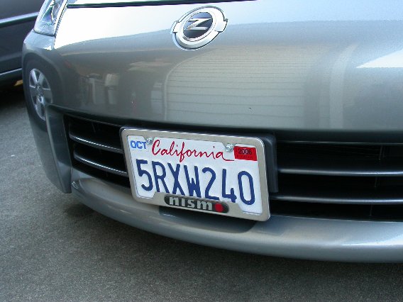

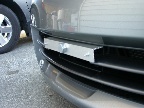

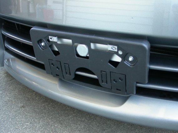

Here's pics of mine...

Your homemade license plate holder looks good. What did you use to make one? Do you sell them also?

sweet!

As you see in the pics I submitted, all I have to do is remove the plate (2 screws) and then undo the large center bolt and then clip the grill piece back in - 3 minutes.. tops.
Gives me the option to run or not run plates. If stopped I can put it back on quickly.

I used aluminum with stainless steel & plated hardware so it won't rust.
Once I test fit the one for the 2004 owner, I'll have the measurement for all model years (mine is 2006). If you're interested in one, PM me.

In my opinion the Z-Bracket is not the best option because the front grill will take any impact. Mine, similar to the Stillen, uses the tow hook receptacle which is welded to the front cross-member.
