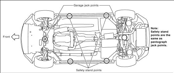

I've had mine up on 4 stands and it was no sweat. All you need is the stands and one floor jack. The Z has garage jack points noted in the manual (there are diagrams showing them areound here somewhere). The front one is just in front of the front cross-member, behind the oil pan a bit; it's a circular area right between the two cross-member bolts. The rear point is by jacking up the rear diff. I used a piece of wood as cusion at both ends, lifted the front first and got it on stands (low setting), then the rear. If you need to raise it higher and the jack has the height, just bump each end up a little at a time to keep it stable.

Default Z jackstand points
I have used these as a guide to give you an idea, I saved them from somewhere here on the forum. Once you look under the car it will make more sense.
Hi, I'm planning on installing an exhaust soon also and I remember having trouble with jackstand position when i first changed the oil. So i need an adaptor thing for the jack stands so that it fits at the recommended stand points?
