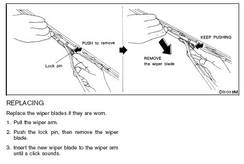

Hey, I tried using the search feature and couldn't find anything useful, so if this is a repost I am sorry.
I am trying to replace the wipers on my windshield but I don't know how to take the old ones off and put the knew ones on. Anyone with pics or a how to?

Look in your owners manual in the section "Maintenance and do-iy-yourself". Page 8-20 in mine, yours may be slightly different.

After pressing the button you need to jiggle them around somtimes.

Ok, I don't have an owners manual. But I did just spend some extra time figuring out how to get the old wipers off.
The previous owner put some different format wipers than I have ever seen before. Anyways, I got the new wipers on, thanks guys.
