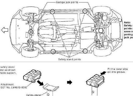

Default Where to place jack stands?
I need to jack up each corner of the car so I can remove the wheel and apply some liquid fatmat for soundproofing inside the wheel well. I hope to do this next weekend on all 4 corners, one corner at a time.
Can someone give a detailed description of where to place the jackstands, front and rear? Thanks.

there are 2 points between the tires. one near each tire, but they are both towards the inside of the car, if you get down and look youll see a lip, and near the tires youll see 2 indents in the lip, the jack goes right between those indents. if your letting it down onto jack stands, move the jack over a bit(keeping it on the lip the) so that you can put the car down onto the jack stands in the proper location.
my jack stands have a u shape cup, not the perfect fit, but it gives the ridge room so it doesnt get crushed. I havent found the adaptor yet tho.
There's a diagram in this thread or you can just click here for a picture.

Yup, that's perfect, thanks a bunch!
