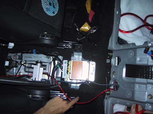

In the center consul near where the rear panel that covers the cubbies and the consol come to gather there is a airbag Sensor there:

hmmm...i didnt have the console out at all today, i only worked in the actual cubbies. do you know if the little black/yellow clips on the right side of the seatbelt box in the cubbies are airbag related?
and in that pic, are you referring to the silverish box with the big sticker right above your finger?
Normally any plug that is yellow or yellow and black has something to do with the SRS and seatbelts
Yea, the silver box... I am actually not pointing at it in the picture, just holding a wire away from the box....
