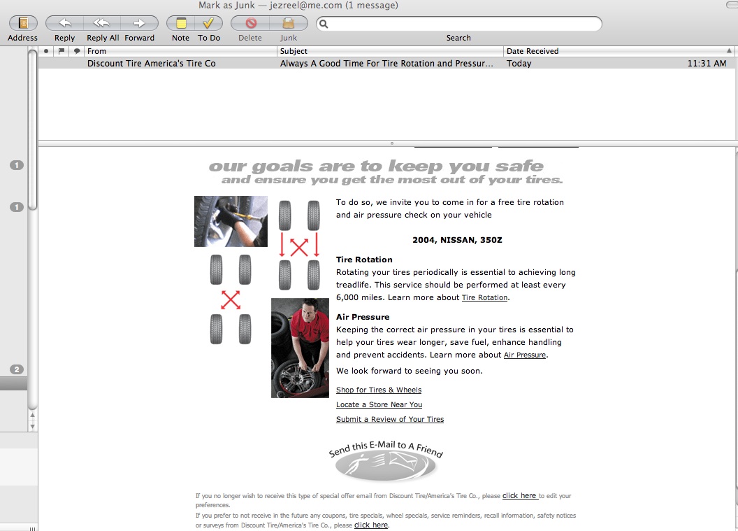

got this in my email. Now imagine if I didn't know better. They make money, I'm out of money, and I've jacked up my tires.

stock wheels on the 350z wont rotate they have a pin in the rotor to keep idiots like the jifi lubes from doing it. They are stupid though i went in for an oil change one day and i run 275's out back and 255's in font with 2 inch lip on wheels and almost 4 in the back the idiot asked me if i had rotated my tires in the past 6 months i just kinda stared at him.

Not sure why you lumped TireRack in there - and not sure why the post to begin with. Most cars can, and should have tires rotated - I don't see where it says EVERY car should do it. It is up to the owner/driver of the car not to be the idiot, and to either take their Z to someplace better than Jiffy Lube (like how about your own garage?) or let the place know that the Z is not a typical soccer mom vehicle. My $.02

side to side.
and they could still perform an air check.

03 to 05 non track 18's will rotate. They are the same wheels front and back.
Wheels yes. Tires, not so much. And OEM tires are directional so no side to side
either.

You can rotate the tires, you just have to dismount and remount.

Depends on the tires. With the Potenza RE050s they are asymmetric so they can't be flipped (dismout/remount). The RE040s aren't so they can be flipped.
