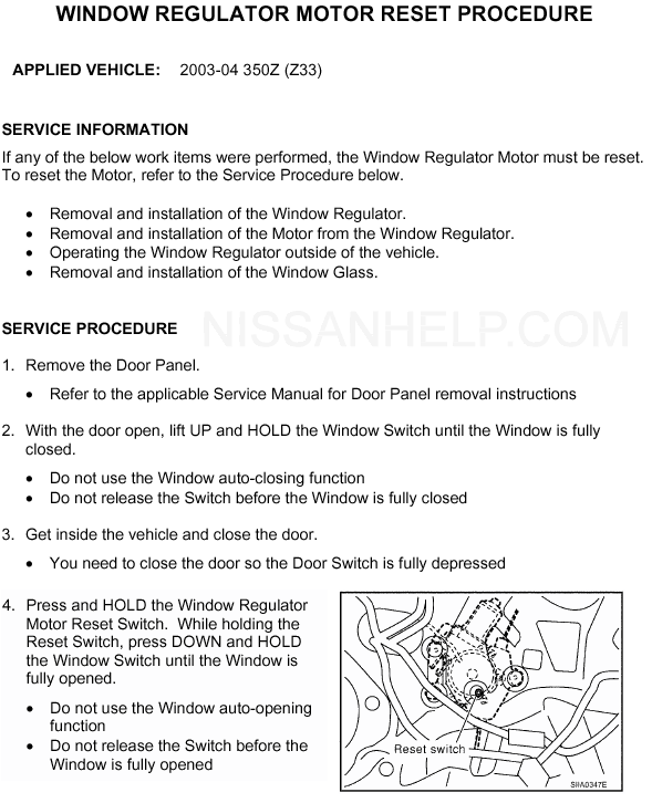

You can buy the window motor at advanced auto - limited lifetime warranty... ~$140 to $180.00. But before spending your hard earned duckets... Meander thru this thread - It suggests attempting to service the motor before replacing it - by cleaning it... If that doesn't fix it - Then replace the motor... Lot of how-to hints on making the task simpler
https://my350z.com/forum/maintenance...r-brushes.html
If after you've cleaned or replaced the motor - your window still does not move down slightly when you open the door - follow the recalibration procedure below.
