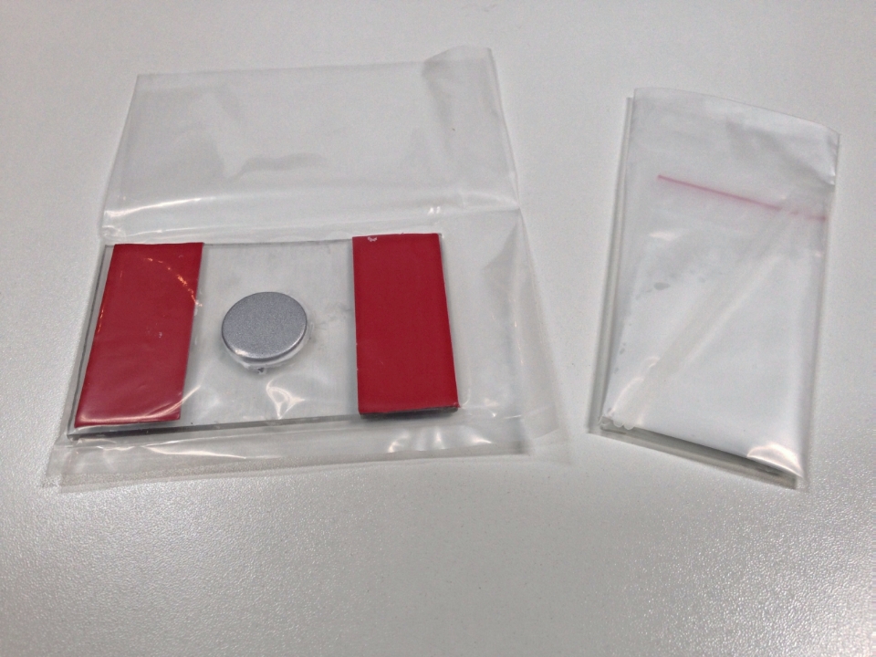

Received my color-coded rear wiper delete plug from Mike along with what looks like a bag of semen... Good times

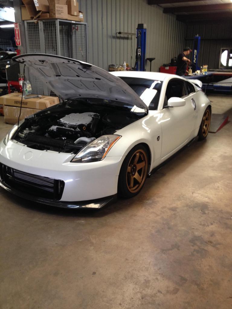

Brought the z to CIN for this bigger fuel pump.

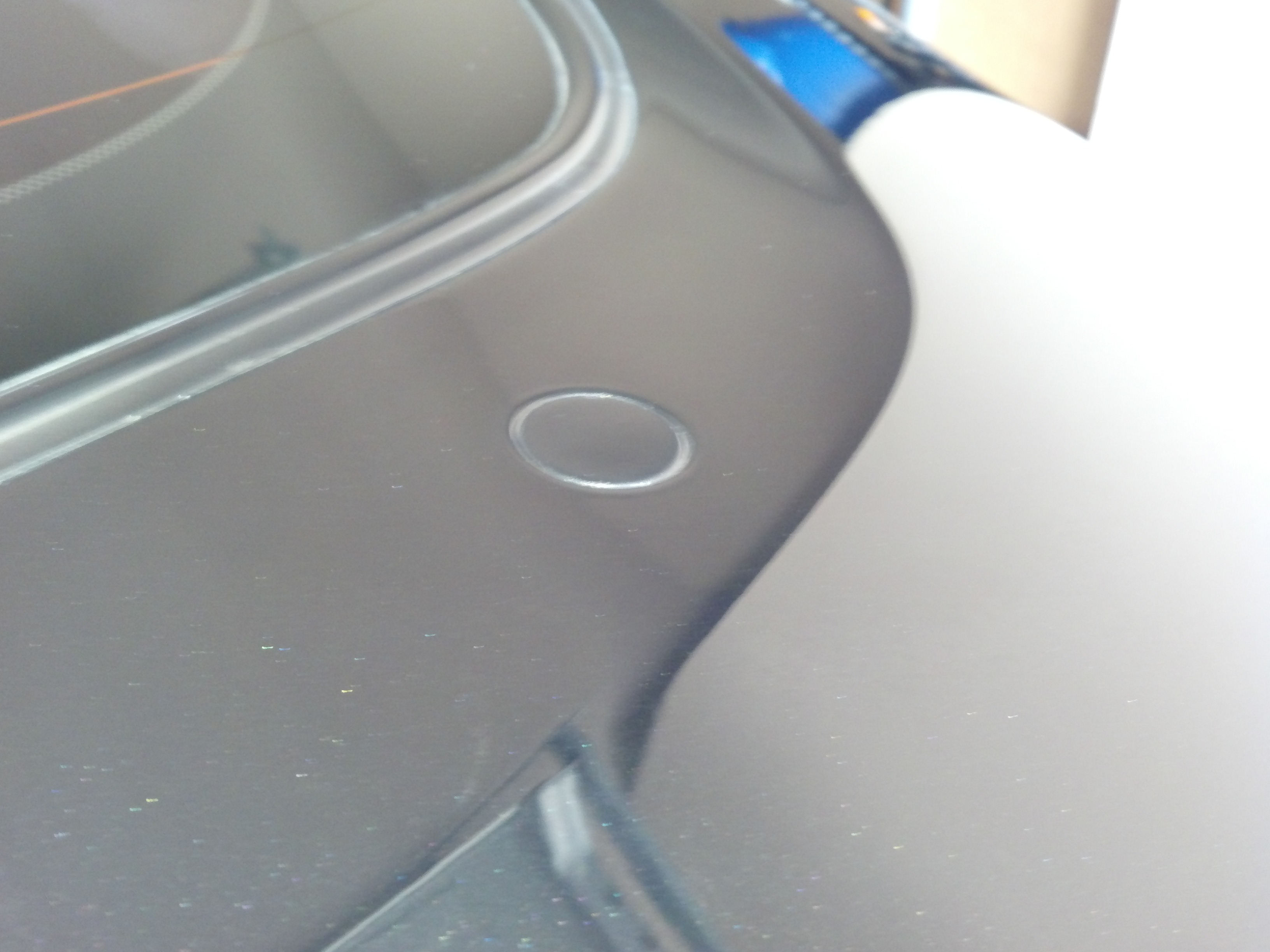

i have this, and it looks really good when you get it up there, almost factory. what i did (since my car is black) i went to autozone and got black silicone, and from the underside of it where the holes are that he has the plug attached to the plexi... i stuck the tube nozzle in each of the holes and filled up the entire area under it and it actually seeped up around the plug essentially filling it completely from the underside... this pretty much guarantees that it is water tight, and makes it look kinda like an o ring. i even laid a bead around the plexi itself (was worried about leaks)
sorry about crap pic, couldnt run and get a better one right now

^^^ Nice, yeah Silver Alloy may be a little harder to do that o-ring idea with but I'll put plenty of semen-cone on the plexi around the plug so it should be completely fine

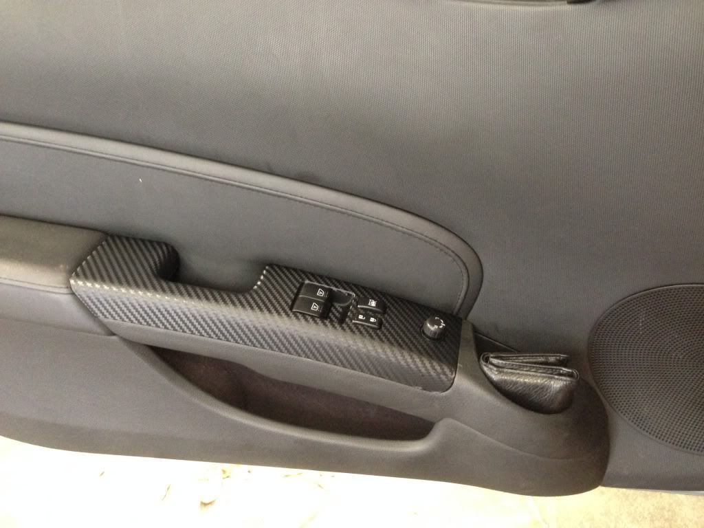

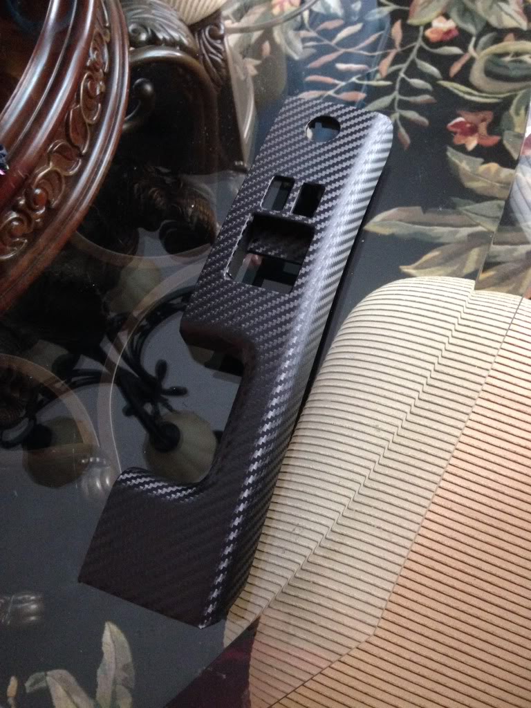

Started wrapping pieces of interior

Neffy wrap or vinyl? Either way looks great!

Looks great, B Money

Looks good B Murray. I'm telling you right now though, those pieces are 1000x easier to wrap than the center console. Good luck bud. Hope it turns out well.

Yeah I already found that out lol. Gonna try the center console again on Sunday when I have more time.
