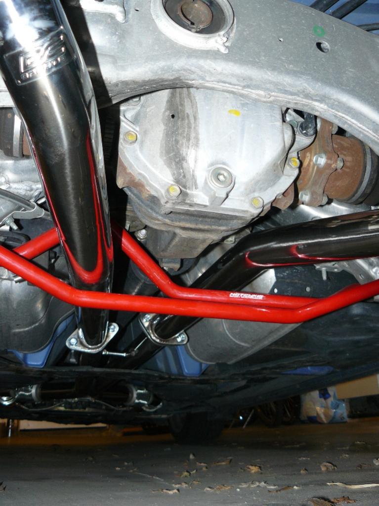

Stillen rear camber arm brace, Hotchkis sways, Powergrid endlinks, DC Sports exhaust, CNT HFCs.

Looks like you've got a blown rear diff bushing my friend. That fluid/dirt on the rear cover tells the story.

You need new diff bushings , and BTW that brace is pointless. If you want to stiffen up the rear a bit , get whiteline subframe bushings when you do your diff bushings.

I'm having resonators welded in this weekend, should make some vids after that.
Thanks for the advice about the diff bushings - I took it into the dealer and had a mechanic look at it, and he said he thought it was just overfilled at one point and dripped out during servicing since there is no residue on the subframe and because he couldn't feel a tear. But after searching the forums about the issue I'm not sure I believe him though. Is there anything you can tell from the pic?
I'm considering the SPL bushings and possibly the Nismo diff cover.

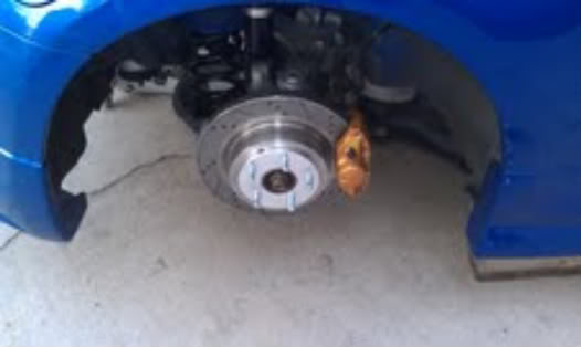

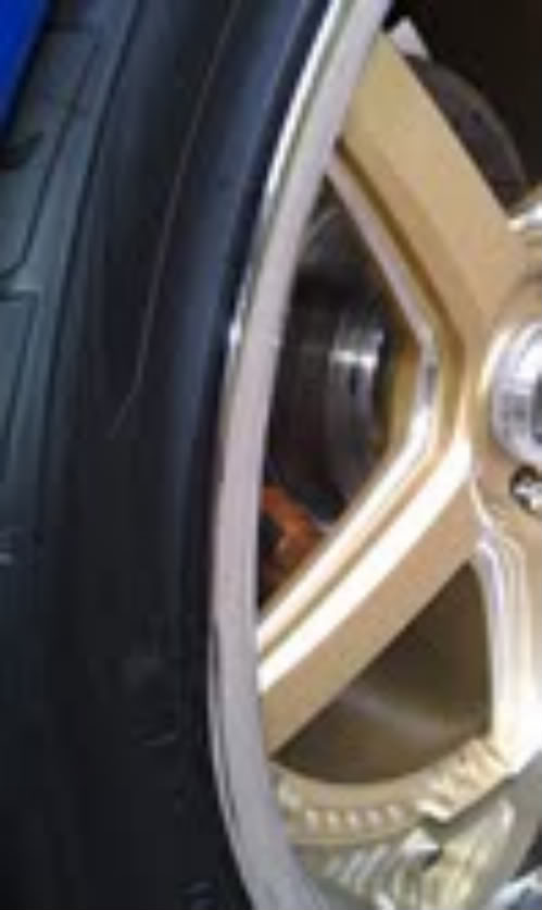

10mm spacers on rear. Love z1.. always receive items the next day. Computer is acting up. Will post pics later. Washed her for little chiefs car meet tonight.
