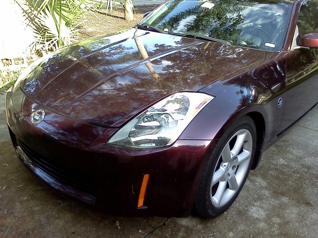

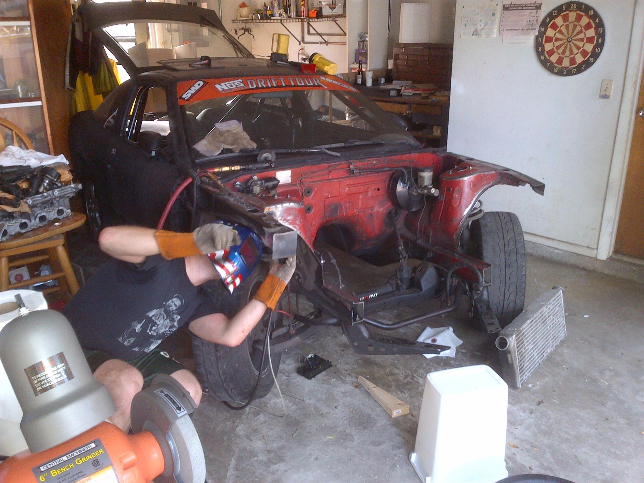

Worked on a buddy of mine's 240sx and polished his headlights with some toothpaste. His were really bad and they still came out great!

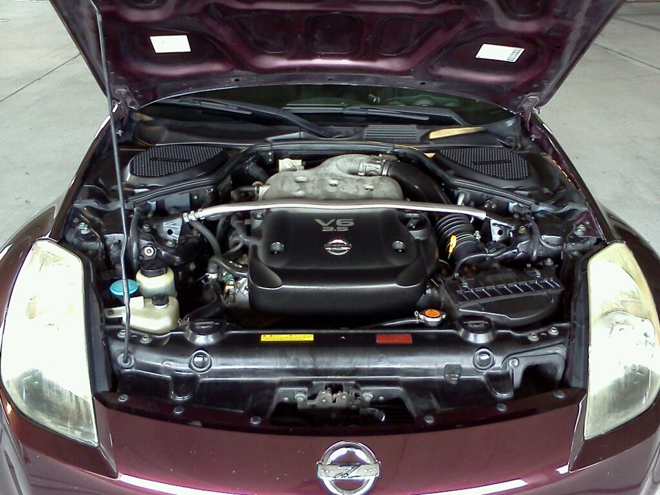

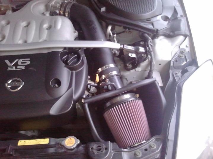

i searched for threads, but the only thing i really found was youtube videos with the 'typhoon' intake. I wanted a slightly more oem appeal.
I have the FIPK kit.
Here it is right after I installed it.
I bought mine from Autoplicity.com, never used them before but they had a great price and shipped pretty quickly, other car forums had reviews on the site.
I like it, makes noise, comes with bolt on airbox and isn't overly intrusive looking. Engine sounds crazy at WOT with stock exhaust right now @.o

Pic isn't showing for me but I put the link in my browser and saw it there. Looks really nice. What do you mean "makes noise"? Are you just referring to the CAI hiss or some sort of rattling? Also, any noticable benefits to this vs. the pop charger?

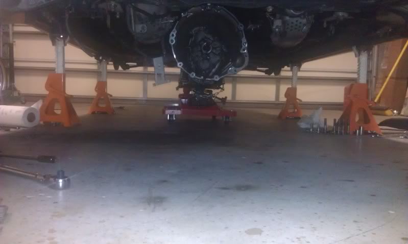

Dropped the transmission and removed all the garbage nissan clutch hydraulics.
Found the "orifice" that makes bleeding a nightmare (at least on the HRs).
Its a manifold that the two hard lines meet at under the driver side fender liner. The manifold has incredibly tiny in and out holes, approximately 1/16".
Its easy to see how surface tension of the brake fluid would have issues gravity bleeding past this or getting air bubbles forced pass it.
Not to forget the hardline coming out of this manifold goes thru a lovely loopty loop as well. Its likely a feature for bending / vibration resistance but not helpful to the bleeding process.

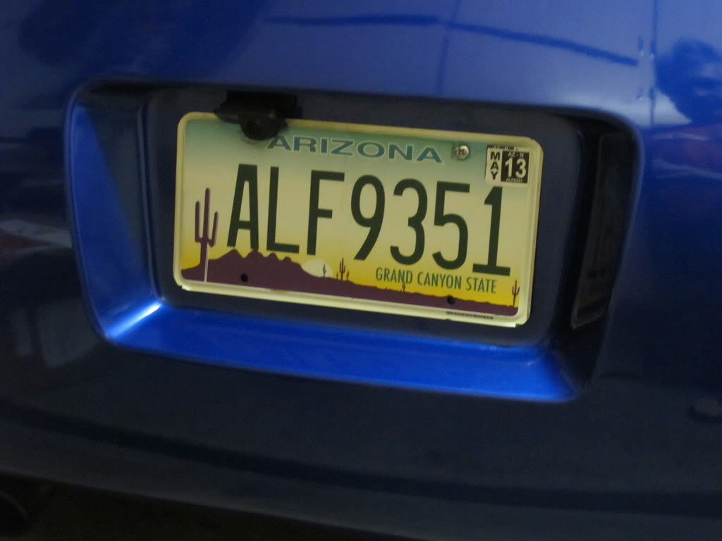

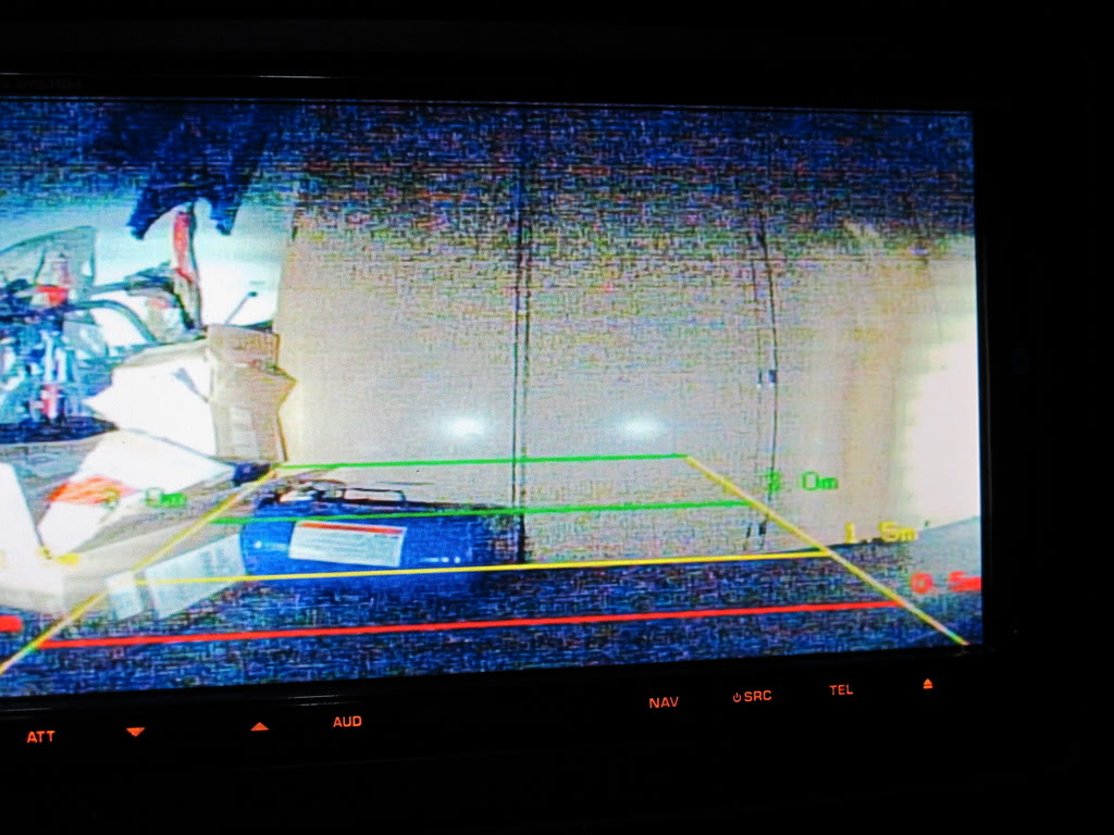

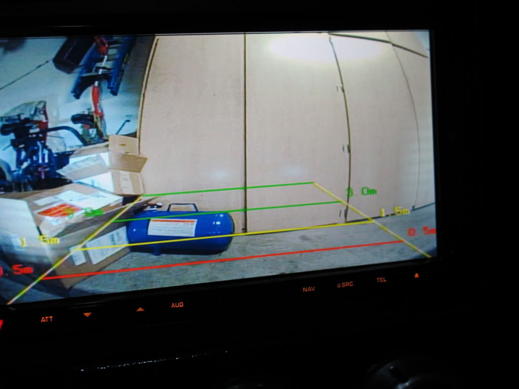

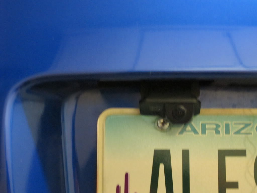

Friday I replaced the ugly license plate camera I had with a Corolla specific Pyle camera. I had to cut the bumper to install it but I like it much better and the picture is better on every level.

Closed garage no light but the backups.
