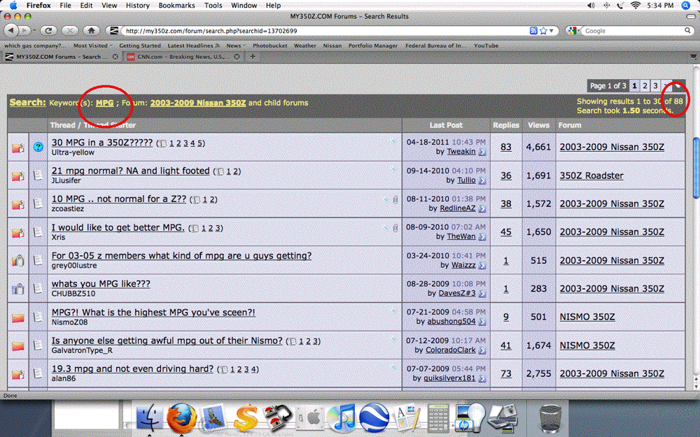

Old May 4, 2011 | 05:37 PM

Originally Posted by davidv
lol why do people take the time to search, then edit a photo, then upload it, and just to rub it in the OP's face??? I never got why people are so quick to say "search" rather then being helpful and just post up a link.
Old May 5, 2011 | 07:47 AM
08panna's Avatar
08panna
Joined: Jun 2009
Posts: 212
From: Toledo, Ohio
^ welcome to the forum Anthony. But after a while, you will see that the same questions gets asked over and over and it does get annoying. Plus I know davidv has used that picture before.
Overall, #1 rule is Search Search Search.
