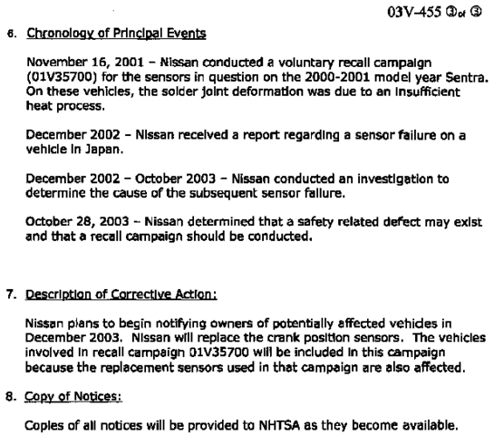

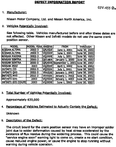

Make : NISSAN Model : 350Z Year : 2003
NHTSA CAMPAIGN ID Number : 03V455000 Recall Date : NOV 04, 2003
Component: ENGINE AND ENGINE COOLING
Potential Number Of Units Affected : 630000
Summary:
ON CERTAIN PASSENGER VEHICLES, THE CIRCUIT BOARD FOR THE CRANK POSITION SENSOR MAY HAVE AN IMPROPER SOLDER JOINT DUE TO SOLDER DEFORMATION CAUSED BY HEAT STRESS ACCELERATED BY THE EXISTENCE OF FLUX RESIDUE DURING THE SOLDERING PROCESS.
Consequence:
THIS COULD CAUSE THE "SERVICE ENGINE SOON" WARNING LIGHT TO COME ON, CREATE A NO START CONDITION, CAUSE REDUCED ENGINE POWER, OR CAUSE THE ENGINE TO STOP RUNNING WITHOUT WARNING DURING VEHICLE OPERATION, WHICH COULD RESULT IN A CRASH.
Remedy:
DEALERS WILL REPLACE THE CRANK POSITION SENSORS. VEHICLES INVOLVED IN A PREVIOUS RECALL CAMPAIGN, 01V357, ARE ALSO INCLUDED IN THIS NEW CAMPAIGN. THE REPLACEMENT SENSORS USED IN THAT CAMPAIGN ARE ALSO AFFECTED. OWNER NOTIFICATION IS EXPECTED TO BEGIN DURING DECEMBER 2003. OWNERS SHOULD CONTACT NISSAN AT 1-800-647-7261 OR INFINITI AT 1-800-662-6200.

Sorry, heres the link, and also the 630,00 vehicles is Nissans in general, not just the Z.

Recall Alert: INFINITI G35, INFINITI I35, INFINITI M45, INFINITI Q45, NISSAN 350Z, NISSAN ALTIMA, NISSAN MAXIMA, NISSAN SENTRA
Owner Notification Date: Dec 02, 2003
Number of Units Potentially Affected: 630000
Component Description: ENGINE AND ENGINE COOLING
NHTSA Campaign Number: 03V455000 Schedule an Appointment
Description of Recall Campaign: ON CERTAIN PASSENGER VEHICLES, THE CIRCUIT BOARD FOR THE CRANK POSITION SENSOR MAY HAVE AN IMPROPER SOLDER JOINT DUE TO SOLDER DEFORMATION CAUSED BY HEAT STRESS ACCELERATED BY THE EXISTENCE OF FLUX RESIDUE DURING THE SOLDERING PROCESS.

It was a cr4p load of cars overall, but only a couple hundred Z's (the very early ones).

Well, here's the info on my Z and Maxima
03 Z made Mar 03
02 Maxima made Jan 02.
Guess it means my Z is safe and Maxima needs to be brought in. However I have not received any notice yet from the dealer.
