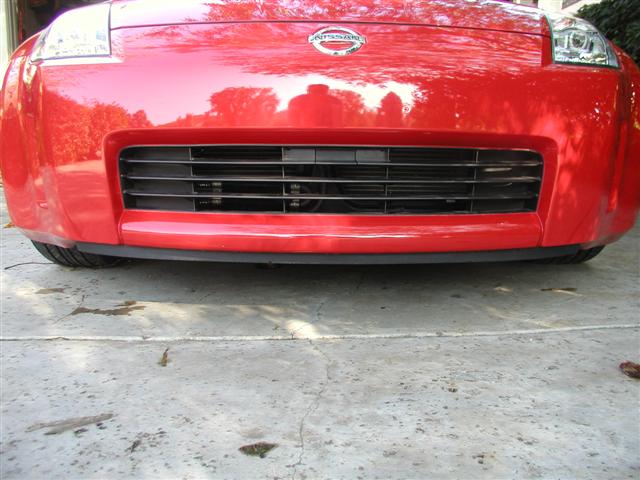

The front spoiler looks like this. It is as pictured above, I thought this low view shows it best. The part comes as MC350Z pictures above.
Attached Thumbnails Front and Rear Spoiler and diffuser installation-z-front-spoiler-s.jpg

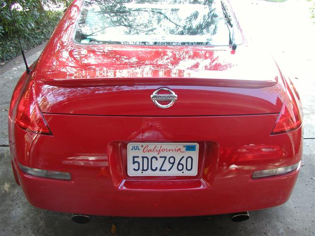

Here is the rear spoiler. As for the paint job, the spoilers are supplied by Nissan pre painted in all the Z colors. I was surprised at the perfect match.
Attached Thumbnails Front and Rear Spoiler and diffuser installation-z-rear-spoiler.jpg

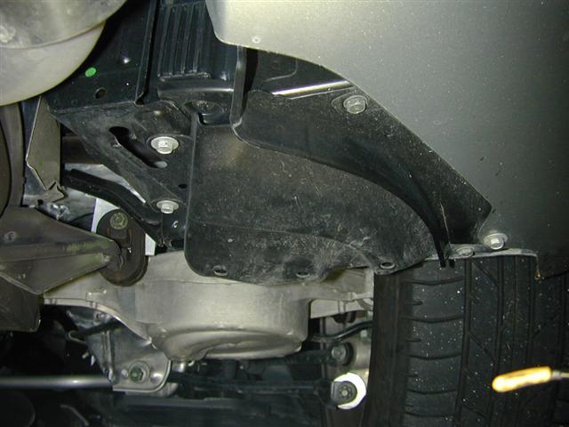

Here are some pictures of the right diffuser taken of another car.
Attached Thumbnails Front and Rear Spoiler and diffuser installation-right-diffuser.jpg

And here is the left diffuser.
I think it would be difficult to make your own, and not worth the time given what they cost. The pictures don't show much of the diffusers, particularly the left shown below. The left side extends about 6 inches upward into the wheel well out of the picture.
I too was surprised that the rear spoiler came painted and ready to go, that is one of the things that made the project fun!!
Attached Thumbnails Front and Rear Spoiler and diffuser installation-left-diffuser.jpg
