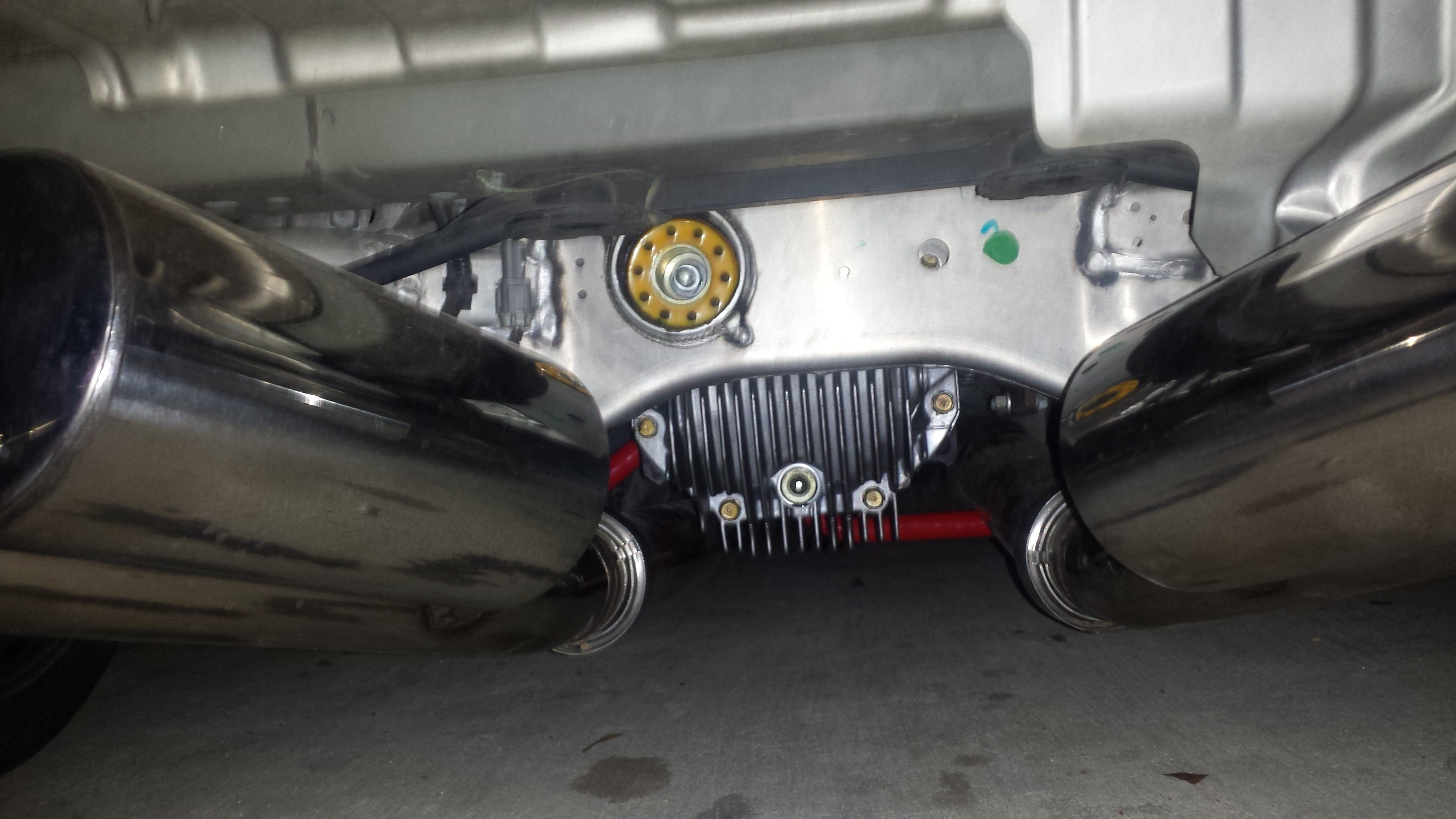

that do you like, quickly before the fog moves in, tell me.... that do you like (if you get that .... i will be impressed)
another thing you want to do, rear diff bushing (the yellow thing)
btw, DAAAAAAAAAAAAAMN, that looks sexy, oh that is my car..... EXPLAINS IT ALL

Lol, you stumped me on this one, but I'm gonna take a stab in the dark and guess that some idiot was trying to put fog lights on his z?
Got a link?
....It wasn't a total waste of a search though....I came across a hilarious thread about a girl ricing out her Z in pink (smh)
Btw...DAAAAAAAAAAAMN your suggested pumpkin mod is expensive. I think I might go for it though. I need to call around for some labor estimates first.
