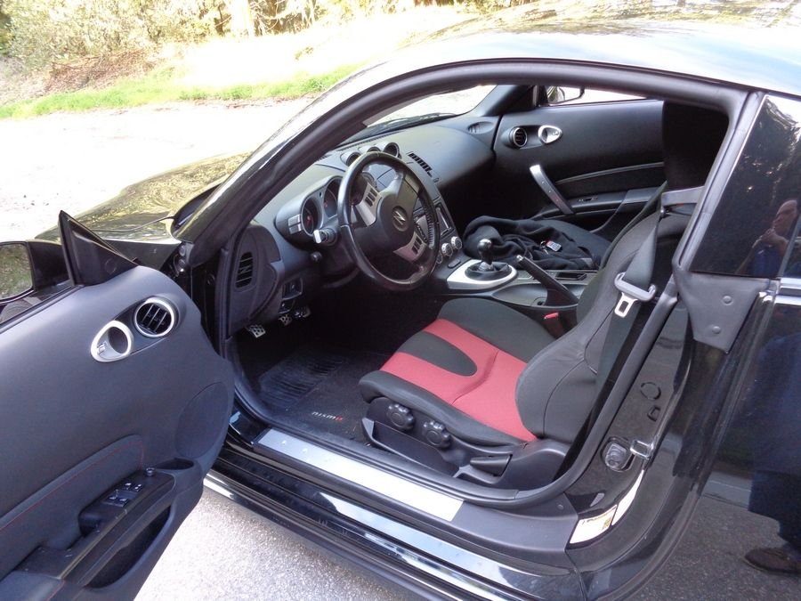

Well, besides the red centers of the seats and the Nismo tach, there really isn't a lot of interior difference to really talk about between my '03 and '08.
The previous owner did add a subwoofer with amp and new touch-HU. Differing from my '03 though is that the sub is a trunk mounted enclosure whereas I installed a free-air sub in the stock Bose location (where none existed prior) and buried all 5 channels of amplification in the well of the stock sub enclosure. Totally stealth.
Hate to say it but my '03's mid-level sound system sounds better.

And… Did I notice some beginning wear on the driver’s side seat bolster in your interior shot of the NISMO Z?

Good catch but no, the seat's not wearing but the edge covering does get a little deformed now and then. Weird but it's not a bother.
