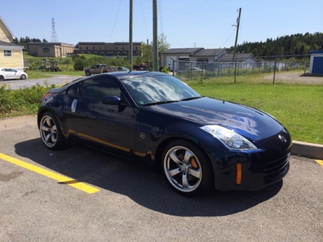

I recently sold my 03 Touring and bought a 07 Grand Touring and love everything about the 07 except the clutch feel, too high engagement and very light feel.
I wasn't happy with the 03 either (too heavy) so I bought an RJM and was quite pleased once I dialed it in,
I see on the RJM site that their version 4.0, not yet released, eliminates or greatly reduces the chance of having the "CSC issue" with the 07 and 08s so it makes it doubly attractive for me.
Does anyone know how the clutch pedal change could resolve that CSC problem?
