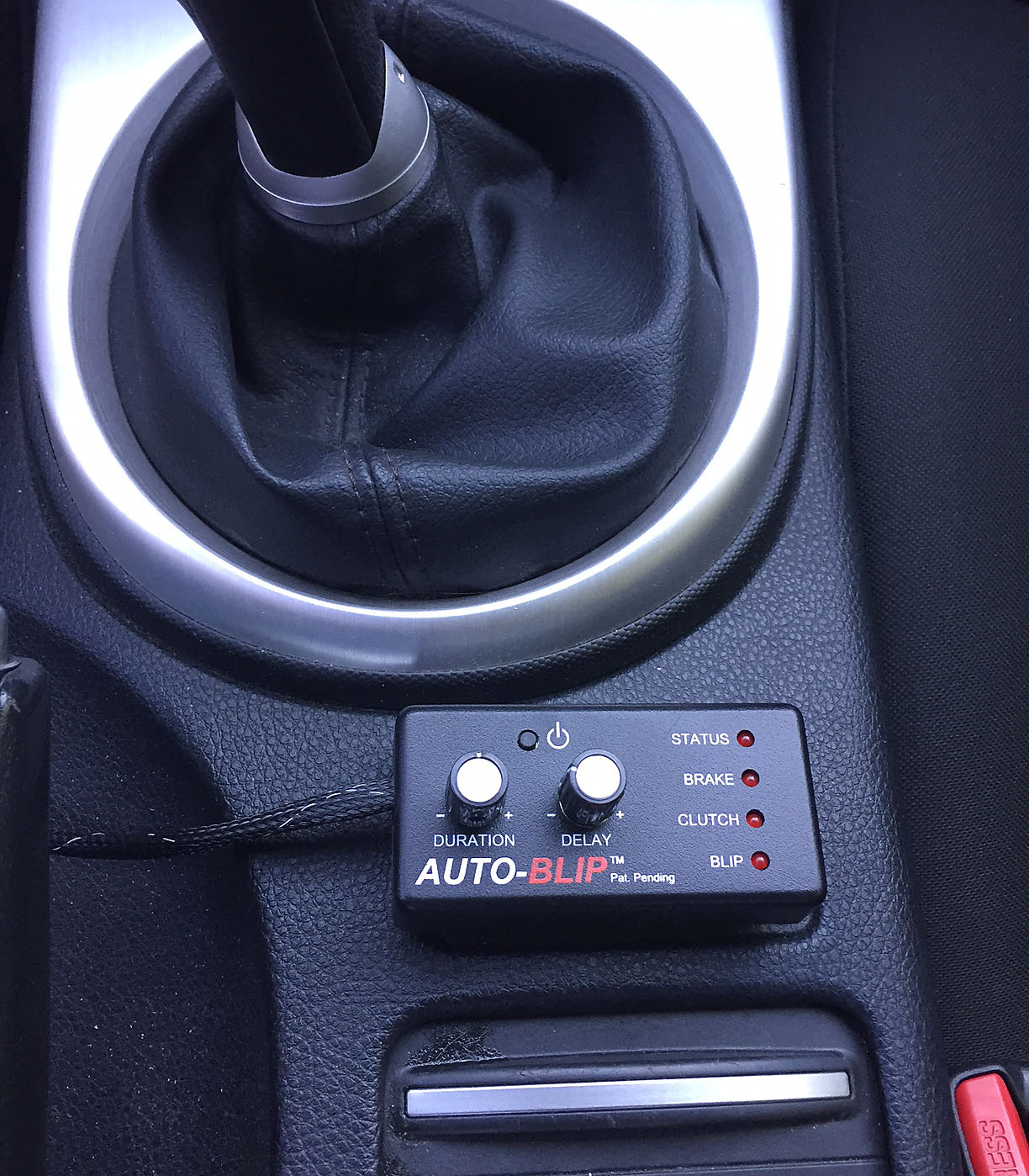

So I decided to buy and Auto-blip and find out. Here are my thoughts.
Installation
Auto-blip has an installation manual dedicated to the 350Z available in the support section of their website. The manual is excellent and shows complete step-by-step photos.
The Auto-blip is installed fully inside the driver’s area of the car. The wiring harness has six connectors that tap into six wires connected to the throttle, brake, clutch and OBD wiring harnesses. The installation doesn't require removing the seat and takes about 30-60 minutes. Specifically:
Two wires tap into wires on the accelerator pedal position sensor (APPS) harness - these control the blip
Two wires tap into wires on the lower brake sensor harness - one for 12v power, the other to sense the brake being pressed
One wire taps into a wire on the lower clutch sensor harness - to sense when the clutch is pressed
One wire taps into a wire on the OBD port for ground
My 350Z had different colored wires on the APPS harness than in the diagram in the manual but a quick email exchange with the Auto-blip support confirmed that the taps attach to the indicated positions on the harness rather than by wire color. For all three harnesses I cut the black wrapping back about an 3/4" to better attach the taps. I unplugged each harness as I did the installation to give me more room. Once the taps were installed I plugged them back in. If I had to do a second installation I could do it in about 10 minutes.
Once the taps are in place you then mount the control unit. It ships with two adhesive Velcro strips which gives good flexibility in deciding where to mount the unit. I choose to mount mine as shown in the attached photo.
Once the installation is complete, you need to perform a calibration. This takes only about two minutes and it records and verifies the correct sensing of the accelerator, brake and clutch. My calibration worked the first (and only) time I did it.
Once done, if you start the car, put it in neutral, press the brake and then depress the clutch and the Auto-blip will blip the throttle. Very straightforward.
On the track
Since installing the Auto-blip I've done two track events. As mentioned before, there are two adjustments - delay and blip duration. After my first few corners I realized that I was releasing the clutch before the blip had occurred. Thus I needed to shorten the delay. Everyone will downshift at slightly different rate but for me I found that I needed the delay set at 1/4 or the 9:00 position. I found that this worked really well for me and I got very consistent results - nice smooth downshifts with near perfect rev matches. The other adjustment was blip duration. I found that the 1/2 mark or 12:00 position worked best for me.
With the settings dialed in I was able consistently downshift smoothly and focus on my braking zone, pedal pressure and release. Depending on the corner, my entrance speed and the desired exit speed I developed a feel for where in the braking zone to best perform the downshift. For corners requiring a two-gear drop, you need to downshift twice as the amount of blip is set for only a single gear change. This still worked fine, each release of the clutch generates a blip even with the brake being constantly applied.
Off the track, the Auto-blip turns off and stays off. Their website isn't perfectly clear on this point. If you leave the Auto-blip switched on, it will remain powered when you shut off the car because the power line that it taps into at the brake pedal has power even when the car is turned off and the keys out of the ignition. To prevent battery drain, the Auto-blip will power itself off after 6 hours. However turning off the power button turns the unit right off and you don't even need to think about it until the next track day.
Conclusion
I really like the Auto-blip. It does exactly what it claims and it does it well. Installation and calibration is easy and it only takes a lap or two to find the right settings for delay and blip duration. My lap times dropped but more importantly for me, my enjoyment of lapping greatly increased. I felt better control of the car as I was able to brake later and deeper and yet transition straight to the gas to modulate the throttle between turn-in and the apex. I was able to manage my vision into and through the corner better. I found it easier to settle the car and my turn-in was smoother. I found I had better headspace to find those corners where I could start accelerating before the apex. In short, my lapping got a whole lot better.
