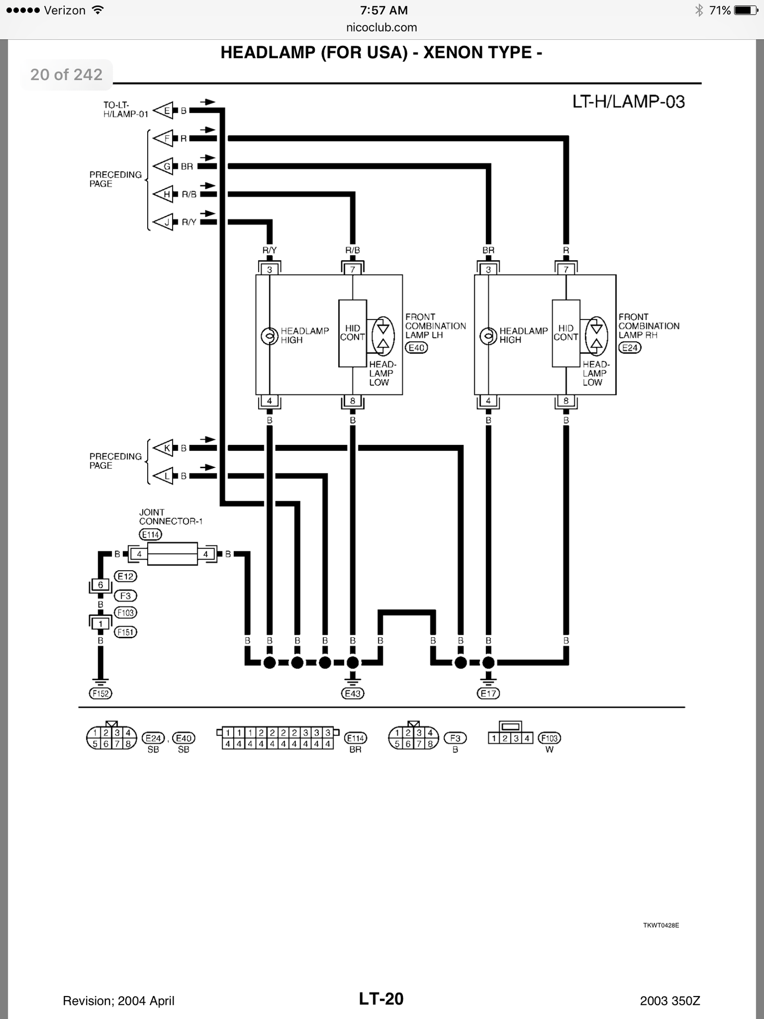

So I checked all the fuse and they all looked good. But I noticed a wire was loose when I got under and was checking everything out. It' looks like the igniters ground to me but not 100%. This is the wire that is loose, I have it taped up just so nothing shorts out. But I'm assuming it's the ground wire. Would this cause both sides to go out or just the side it came loose from?? I'm hoping this is my problem but I didn't have time to hook it back up today and check because it got dark on me.

Could the the ground from the ballast to the igniter be the problem? I noticed the passenger side ground isn't connected it must of came loose. And would that cause both sides to not illuminate??

The pic you posted looks like the disconnected ground. When you connected it, did it light up when you tried it again?
I don't think that would cause both sides to not work. If the low HIDs on both sides don't work, then it sounds like the headlamp low relay or maybe the shared ground.

Where is the shared ground located? I'm not any good with that diagram. I also tried to change the relay but couldn't get it out. I'll give it another shot today.

Your best option to resolve this issue, is to remove the entire headlamp assembly. It looks like the loose wire you found terminates/grounds itself inside of the headlamp housing. For easier access and making your life a whole lot easier, removing the headlamp assembly is the best course of action IMO.
I would also compare with the driver's side to confirm.
