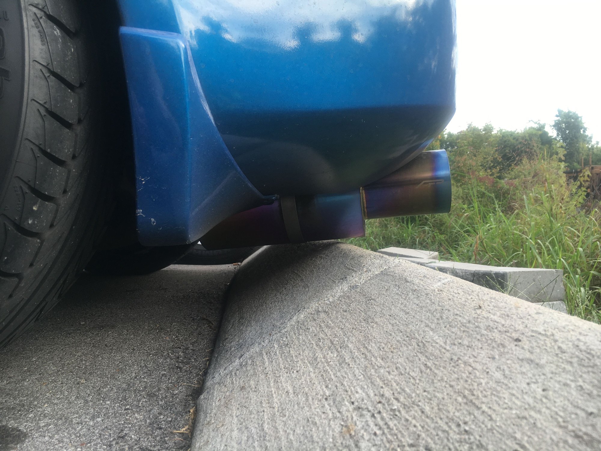

thanks, car was originaly blue but this blue is lighter and more flake in it engine bay is only place can tell, but blue on blue its not really noticiable unless your acually looking for the differnce, got abit to go still needing black housing headlight options doing the 370z turn signals an redo the tint and tail lights ill be done looks, but as above looking at the finaly options cause gunna get it bolt ons an tune for good wile befor swap/turbo/supercharge wayyyyy down the road. love the z lol much fun
