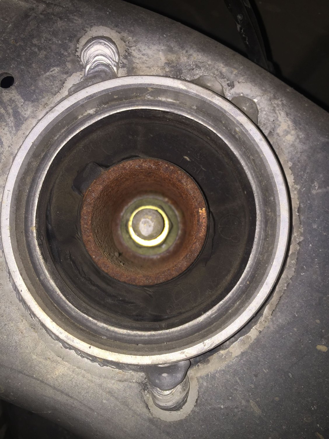

I need to see a pic of this contraption you made, along with rear diff bushings

You can’t see it that well because I’m having troubles getting the rubber off but that silver rod is what I made because the single disk I put in made me need more length the engage the clutch

Hard to tell on my phone, but diff bushing looks dry rotted but no goo...
Take off the slave and see if the fork has alot of slop in it, wondering if you need a new pivot ball and fork, hell i would also replace the slave because cheap and easy
