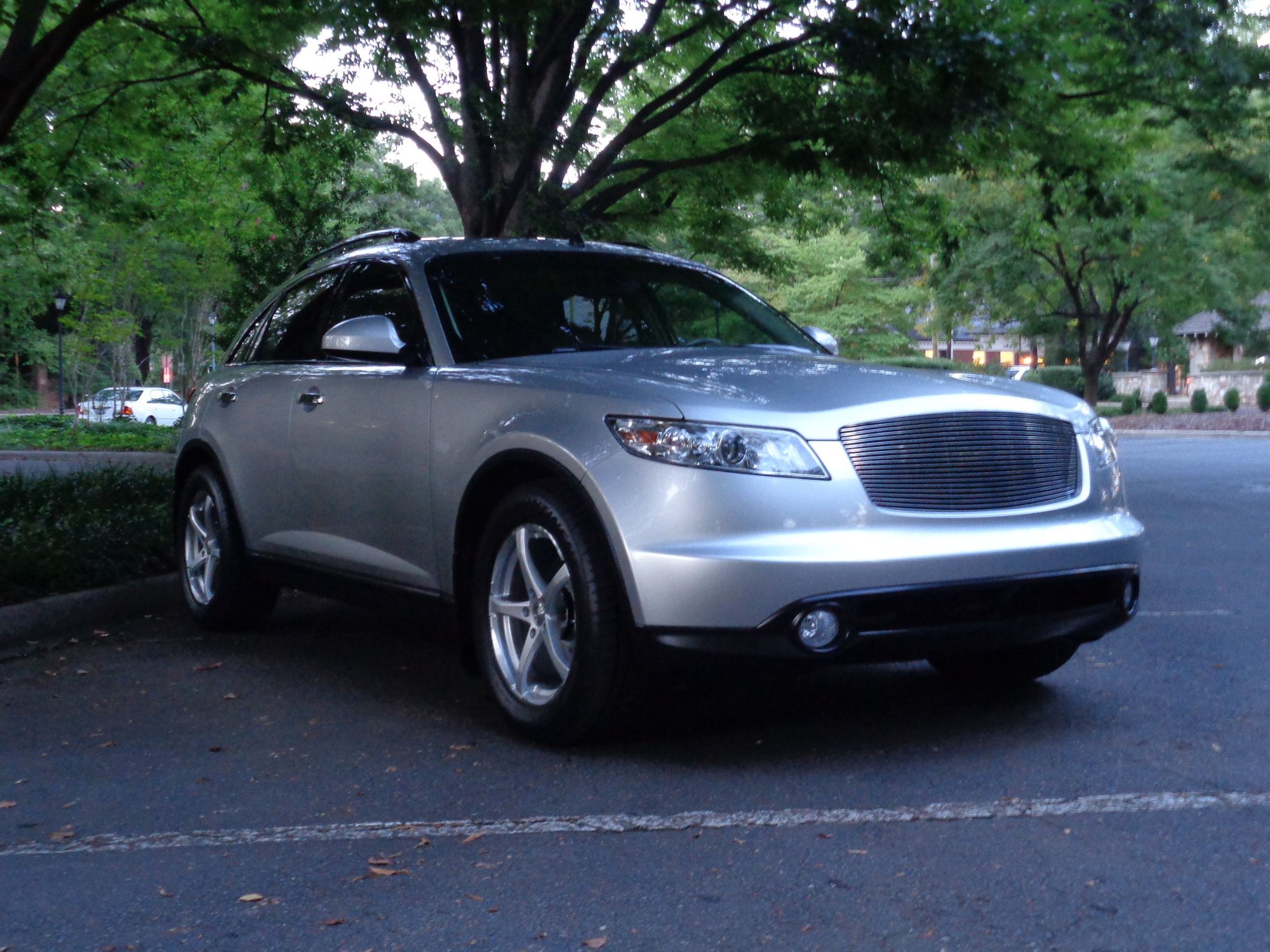

I figured the z would have the same system. I imagine it's very similar to VDC which does it's thing ***** nilly. The G has the rear brake issue, FX (mine below) had the same issue and apparently the Z does as well. Coincidence? I did what I did and it appears as though the problem's been solved.
