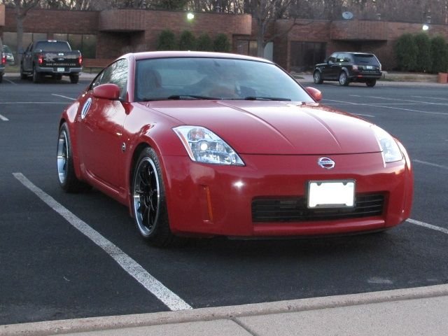

That will look good. If you get "too flush" in the front, you spray debris along the doors.

Here is a picture of my front 8.5 x 18" +25 mm offset wheels. To me, the fronts are a little "too tucked." But, I'm getting used to them (and more accepting).
Your 9 x 18" +25 mm offset wheels will protrude another quarter inch and will look better.
