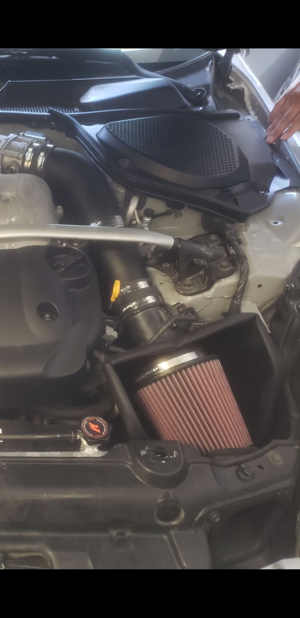

So I think I did what you said to do and it's STILL sagging and barely rubbing off on that white thin tube right under the heat shield... It's so annoying
What can I do to prevent this ? Here is a pic of how it's installed in my car
I found this ancient thread where the owner had the same issue. Honestly, I'd return it, and either get a used revup air box, or some other intake.

To go back to the original question though, is it safe? Besides this rubbing issue, I'd say yes. I've run a K&N filter on my z since I bought it nearly 4 years ago. I installed a K&N drop-in panel filter on my wife's '07 Patriot in 2011. We have probably 100k miles on that filter. They're definitely safe, if you maintain them properly. K&N addressed one issue buyers raised, people arguing over-oiled filters would soak the MAF sensor, causing issues. I've never seen this happen, but I oil our filters according to the instructions.
