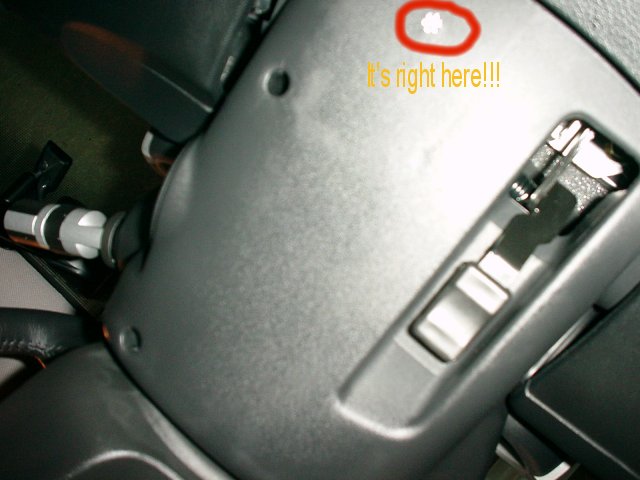

Here it is... sorry for the past confusion...

good find now for the test

Originally posted by ZforFun
where in the car is that?
under the steering wheel

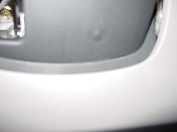

another shot

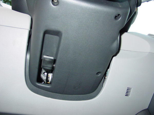

Old Sep 20, 2002 | 02:43 PM
BRONXWARRIOR's Avatar
BRONXWARRIOR
Posts: 1,614
From: BRONX NY

Could you please post exactly where this is?? Take us step-by-step! Please!

Look on the at the bottom of the stearing column. Just before it goes under the dash. Can't miss it.
