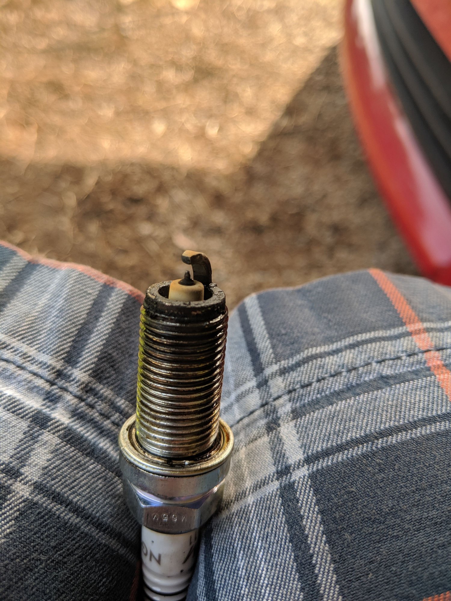

Is there oil in your plugs ? If so that can cause a misfire aswell thats why i just replaced both my valve covers actually.

This is more or less what my plugs look like. I'm not sure what you meant by "is there oil on them?" I know it doesn't look great but, honestly I thought they didn't look too terribly bad. Any opinions on it?
