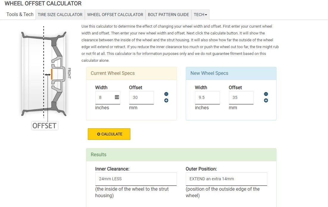

Hi viper1. 15mm offset works well with a 9.5' wheel on the 350z (front and back).

From: Lawtown
