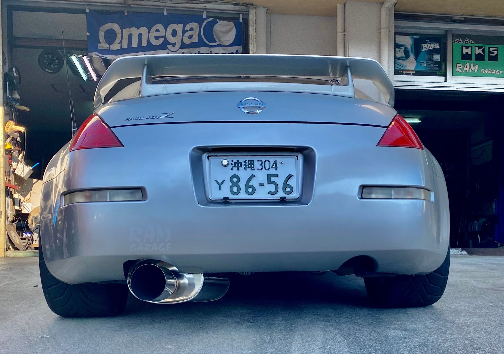

Originally Posted by Z33_1965
ooohhh wheee!! Not a bad looking rear! Idk why, but I just love Jap plates although with only 4 alpha-numerics how do you not have duplicates?? I assume it has to do with the jap lettering up top?
I never really researched them lol

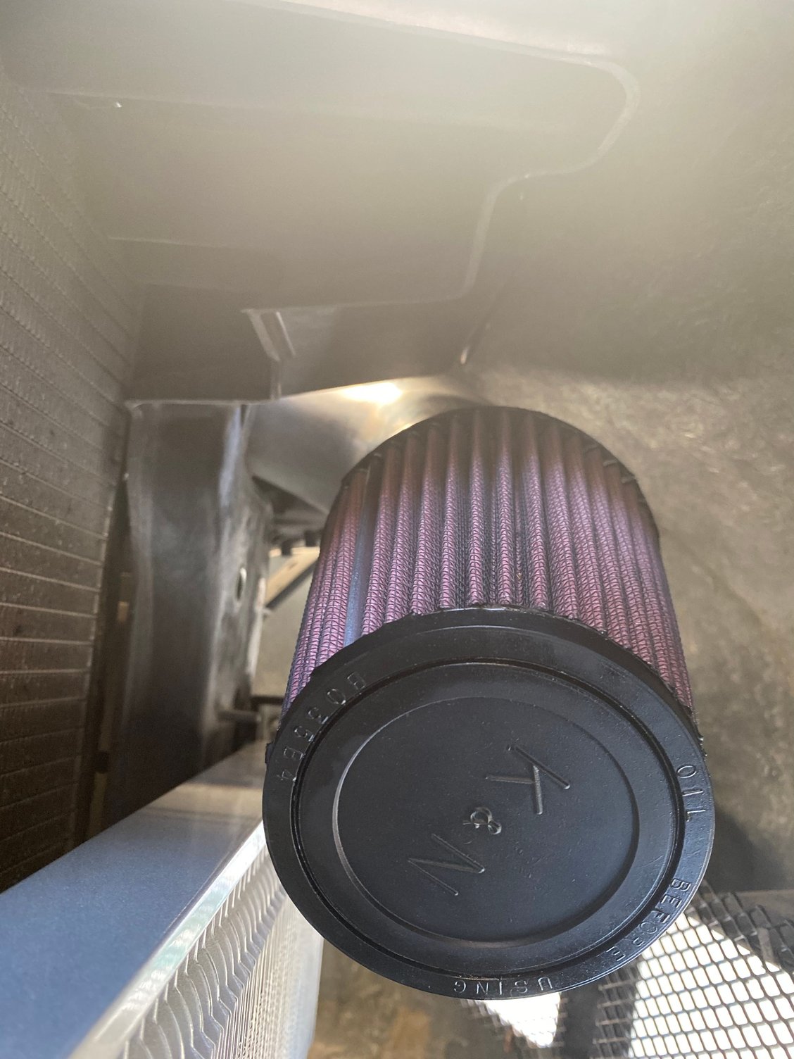

Agree with you about the negatives of the AT intake. I have a velocity stack at the end of mine which makes it a tight squeeze with the air filter, but it still fits. I routed the PCV on that side to a vented catch can. Once the weather isn't so miserable here, I plan on making a heat shield out of carbon fiber to block the engine bay heat. I have the V2 bumper with the scoop which funnels air to the filer, but I plan on making a long radiator diversion panel to better direct the fresh air to the intake. It seems like a lot of the panels out there stop short of the air duct behind the bumper. The hood prop was in the way, but I have some struts now, so it's no longer an issue.
Nice, I do believe there is still one that extends over the duct, wouldn't that bottleneck air travel?
I rather keep PCV for now, my injen should have similar (if not better) ait temps, the filter is dead on the middle of the grille and not hidden like the admin extension. On average my intake temps are only 5-7 degrees hotter than ambient air.

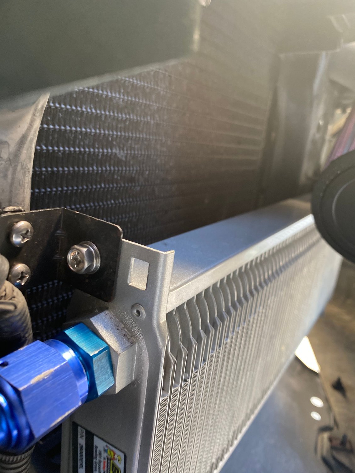

Default Pics Engine/Earl’s AT and Oil Cooler

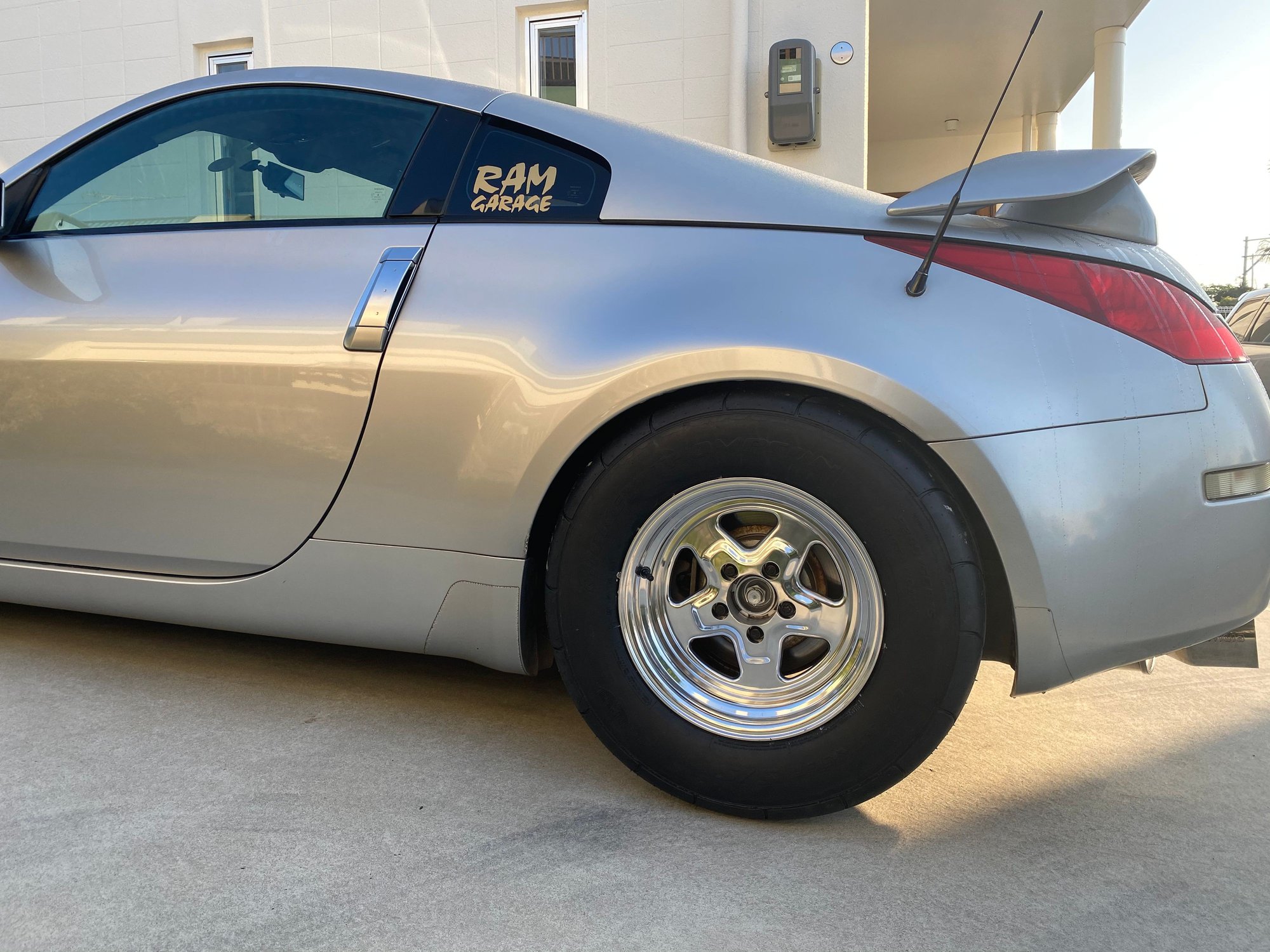

Default 305/35/19 Nitto NT05R Drag Radials
I got the DR fever so I bought a couple of different DR setups😁
Wheels are 350Z Nismo OEM 19X10 +30 offset

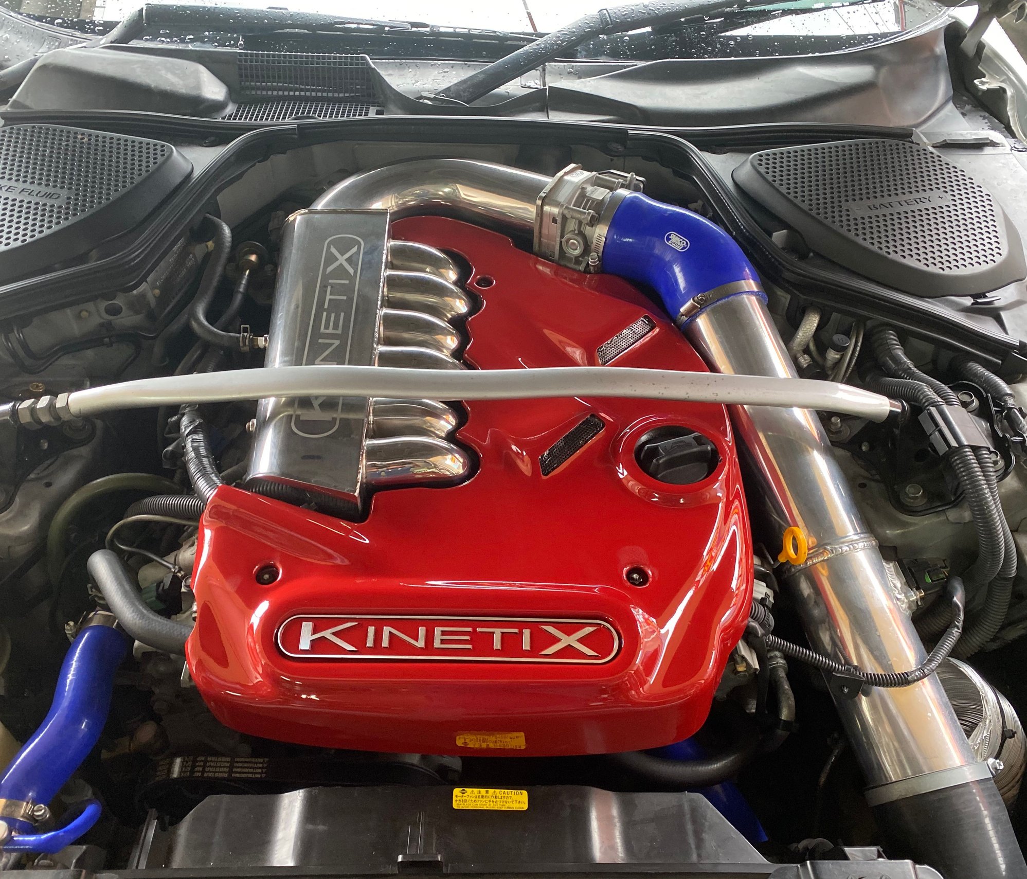

Default Bored
Inea
Got bored with the black cover so I painted it fire engine red 😁 not too shabby using rattle can caliper paint 😆

Nice job with the paint, I have been wanting to do mine in carbon fiber.
