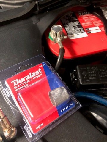

Guess just to bump this up a bit - resolved an issue the other day. Basically, my car seemed like it had a dead battery. Except it didn't. I was able to figure out it that one of the clamps on the batter posts was loose. I tightened it as much as I could but it would always just slip off. I was going to replace the clamp but found an easier solution - Duralast Battery Post Shims. Basically, its a boot that goes over the post. Worked like a charm. Paid like $3 at Pep Boys. Maybe this will help someone someday that reads through the thread.

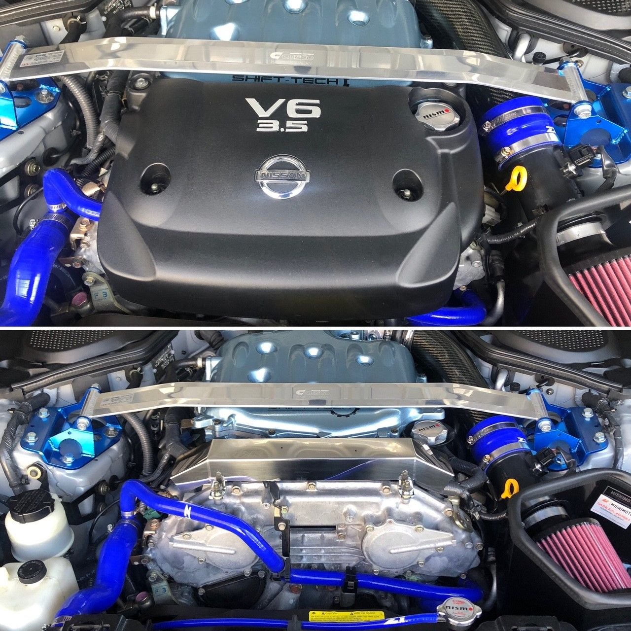

Bought an EVO-R engine harness cover from CZP during cyber week and had some time to put it on the other day. Here's a before and after pic. I'm hoping to paint my valve covers and timing covers some day too. I looked for a RareJDM cover but couldn't locate one. People always complained about the installation of those anyway. This one was really simple. I'll be replacing the acorn M6 nuts w Titanium nuts soon so it should look a little nicer.

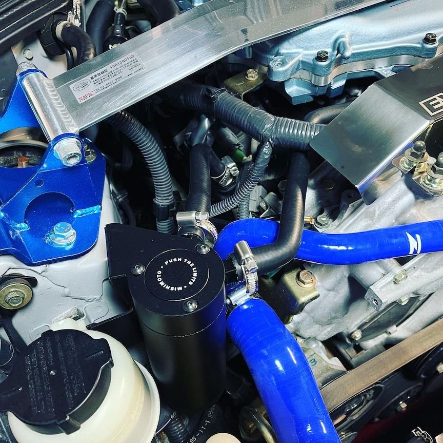

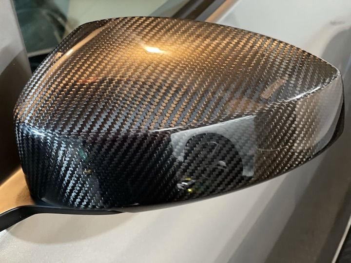

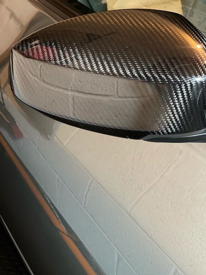

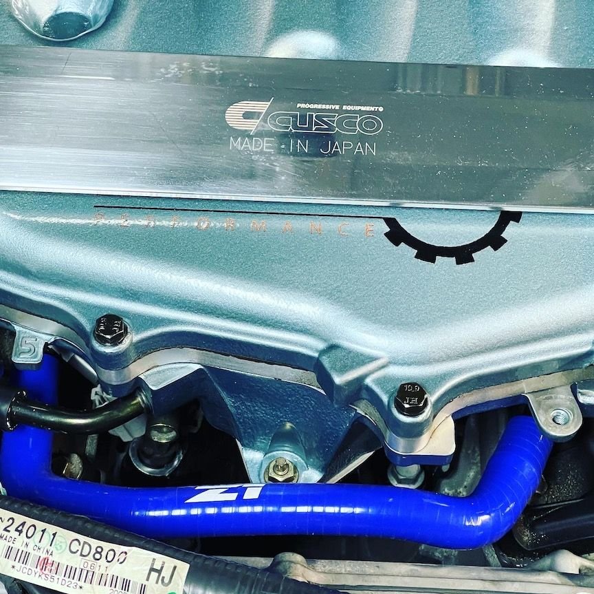

I installed my Mishimoto Catch Can last Saturday morning. Was pretty simple. I installed it because when I replaced my intake manifold back in October I noticed i had a bit of oil in there. While i was in there i replaced my front crank case hose w a blue Z1 silicone hose. A couple weeks back I installed my Carbon Fiber Mirror caps. Those came out pretty nice.

CF Mirror Caps
Oil Catch Can
Crank Case hose
