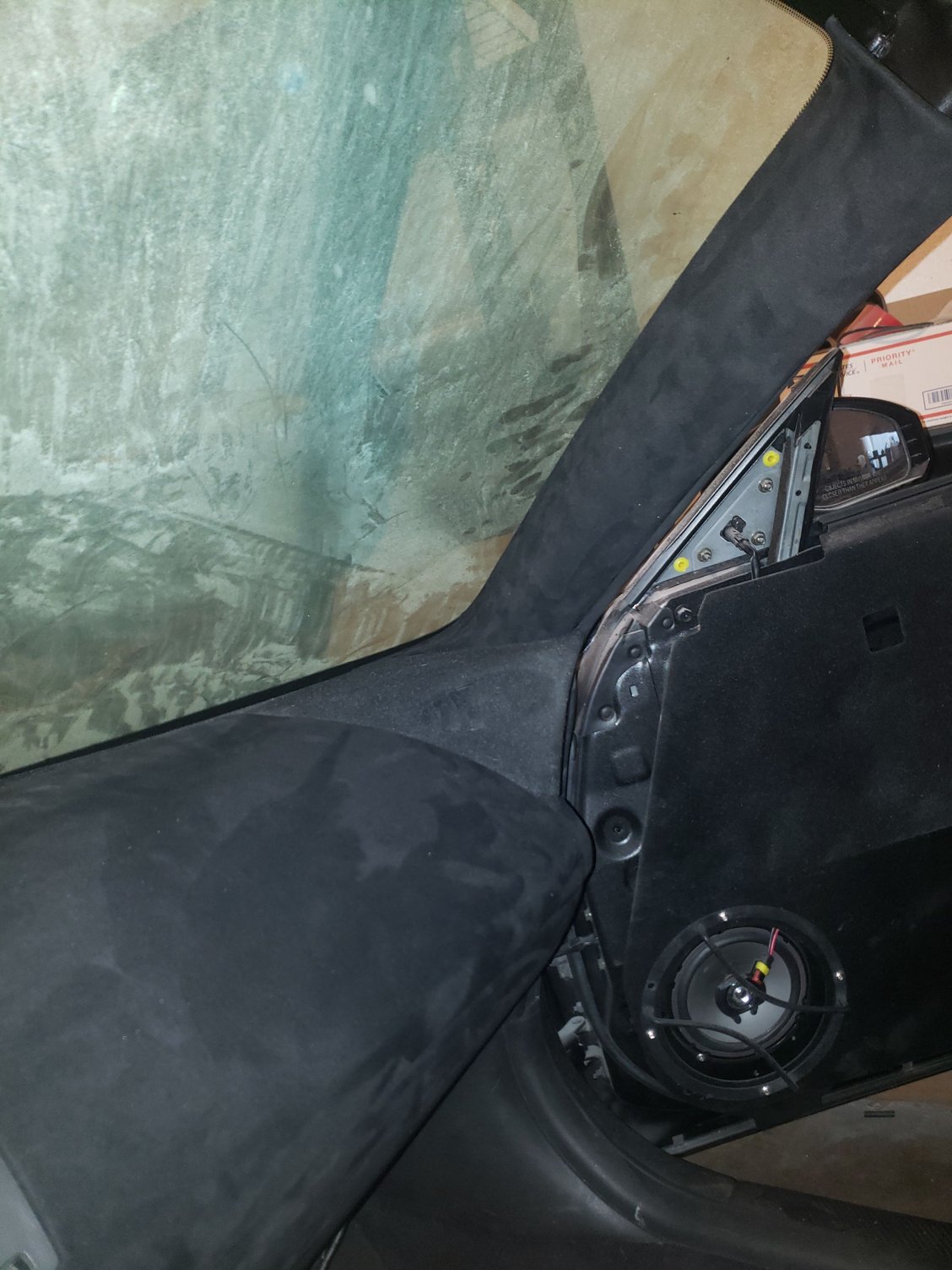

Finished with the suede wrapping. Very happy with how everything came out. No wrinkles or ugly corners/sides at all. The biggest issue was making everything fit again as clearances got smaller between parts.
Interior is almost done. Have to finish the passenger door/window, passenger wiring harness, sub mounting, and cleaning. Next is the hatch and hood. Have to grind away at the hood hinges to get better fitment, and will be removing the washers to even the hood out and making spacers that match the shape of the hinges. Tunnel hatch needs to be adjusted, need to find a solution for hatch struts that work with a carbon hatch, and going to see about new springs for the hatch as the stock ones are too strong and raise it even while closed. Next will be the engine, rechecking connections, new PS connections/hoses, fixing the zspeed undershroud, cleaning underneath up as there is PS, coolant, n oil everywhere from spills/leaks.

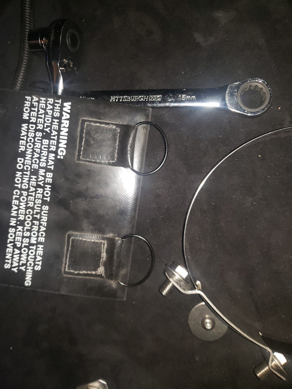

Bottle warmer rings were rusty and they were already leaving rust dust before taking everything apart. Cut them off and used some coated stainless line instead.
Also upgraded to a Nitrous Outlet bottle bracket that is full stainless. Sucked enlarging the bolt holes on the brackets.

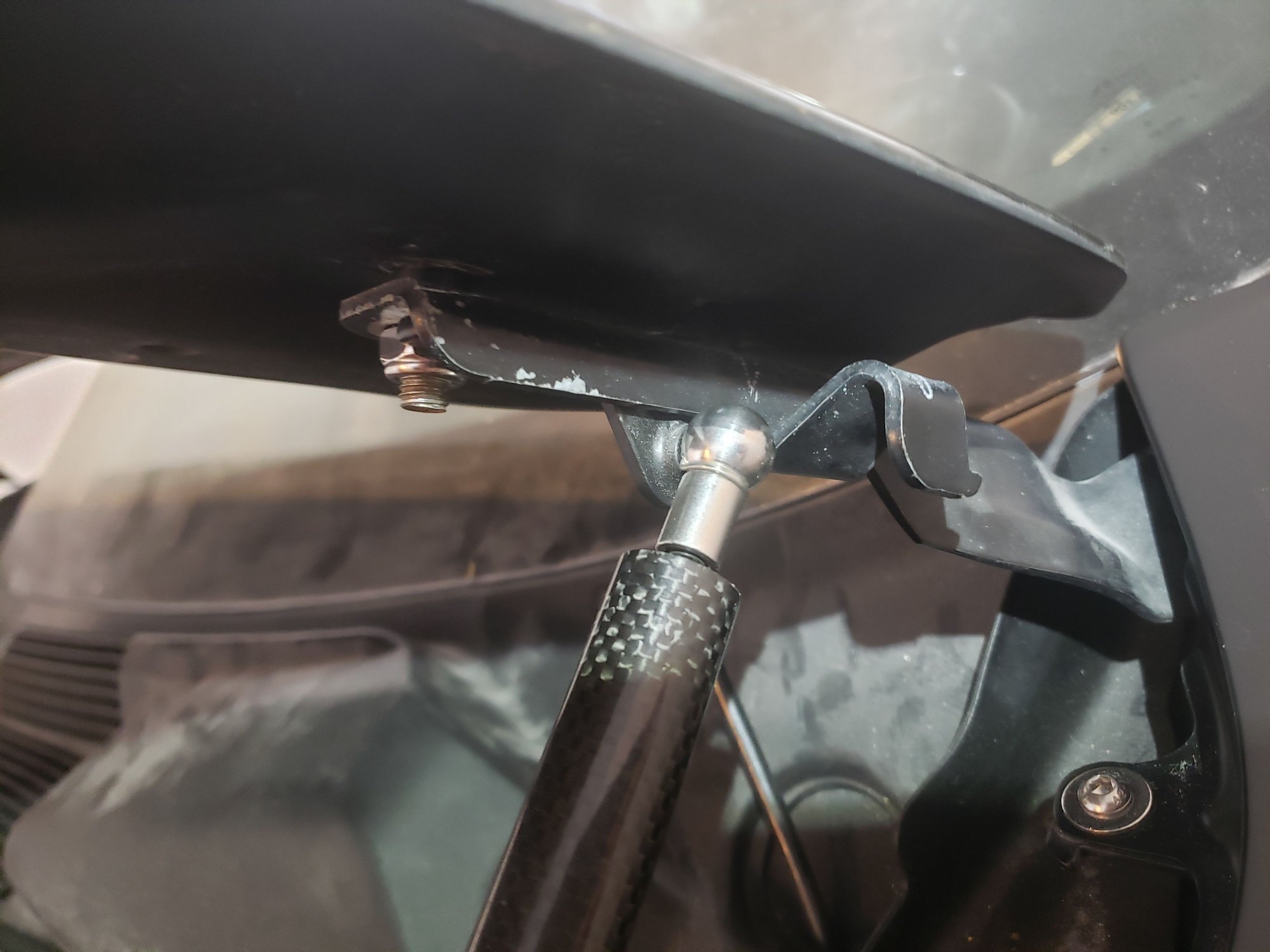

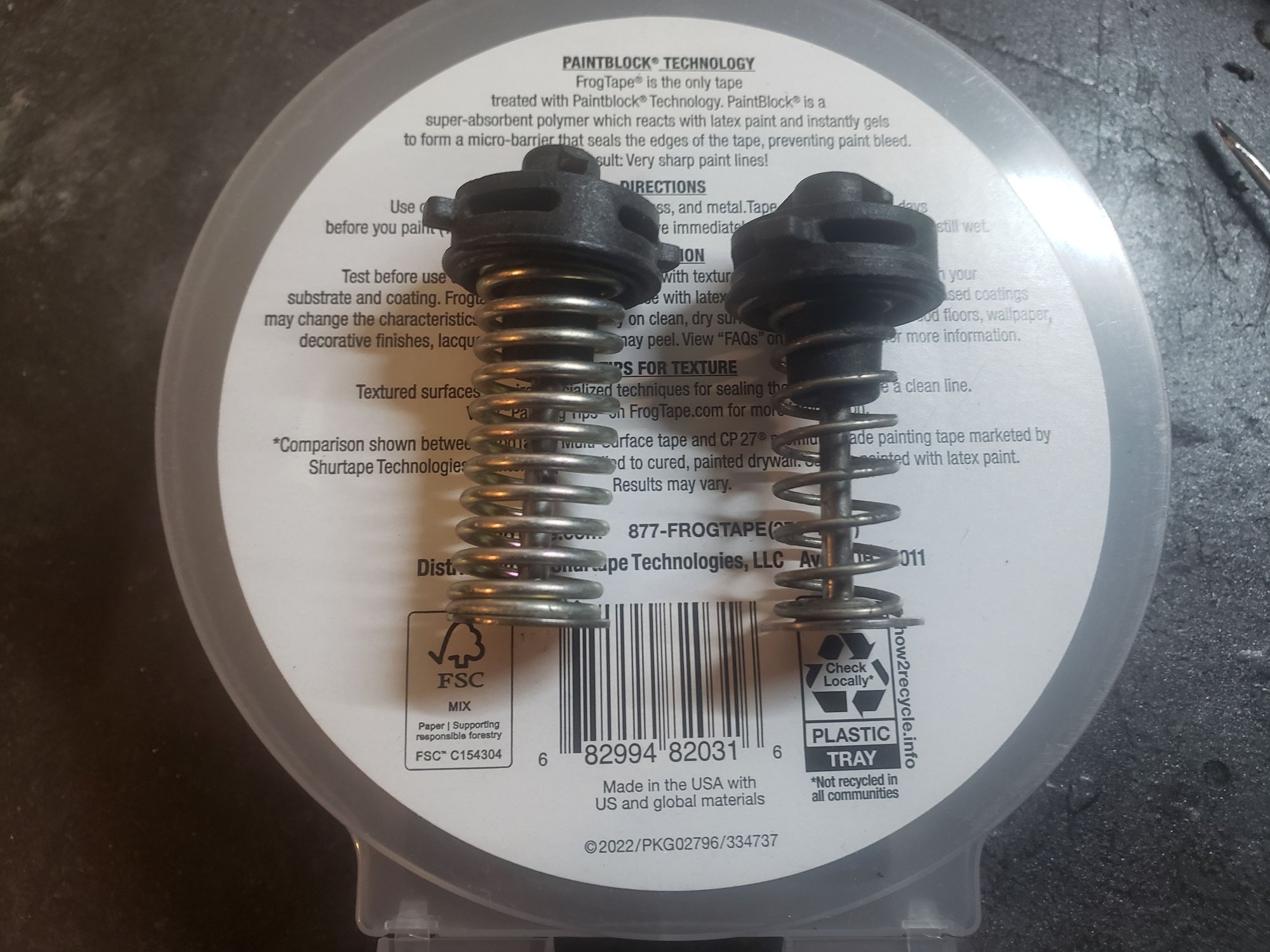

I took apart the hatch springs to go get new ones, turns out, I found 2 springs in my box of random hardware. Seems to work, added some M6 fender washers to the inside due to the length of the spring being shorter. They no longer hold the hatch open, even when it was closed and latched. Pops up the hatch enough to get my fingers underneath. OEM Left. NEW Right.

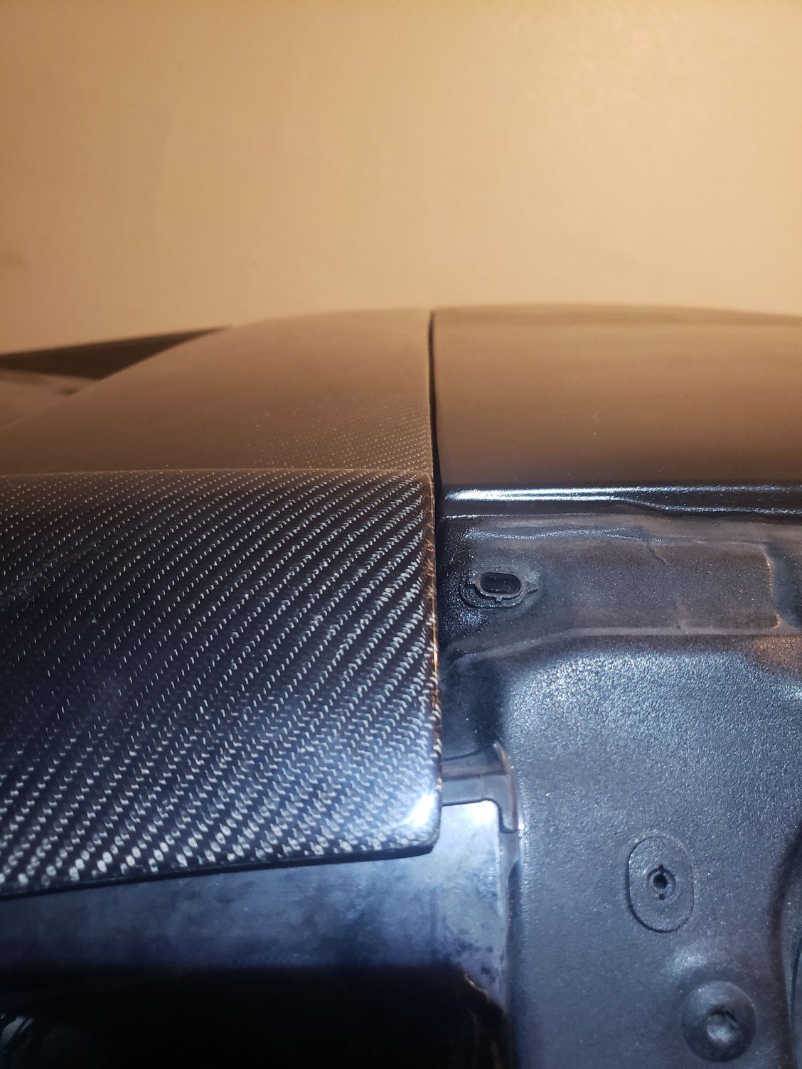

Got on the front bumper, kinda. It was extremely warped. I spent over 2 hours heating and pushing it back into place. The bumper wouldn't even fit on the car before hand. Once the car is drivable and out in the Arizona sun, ill fit the bumper again.

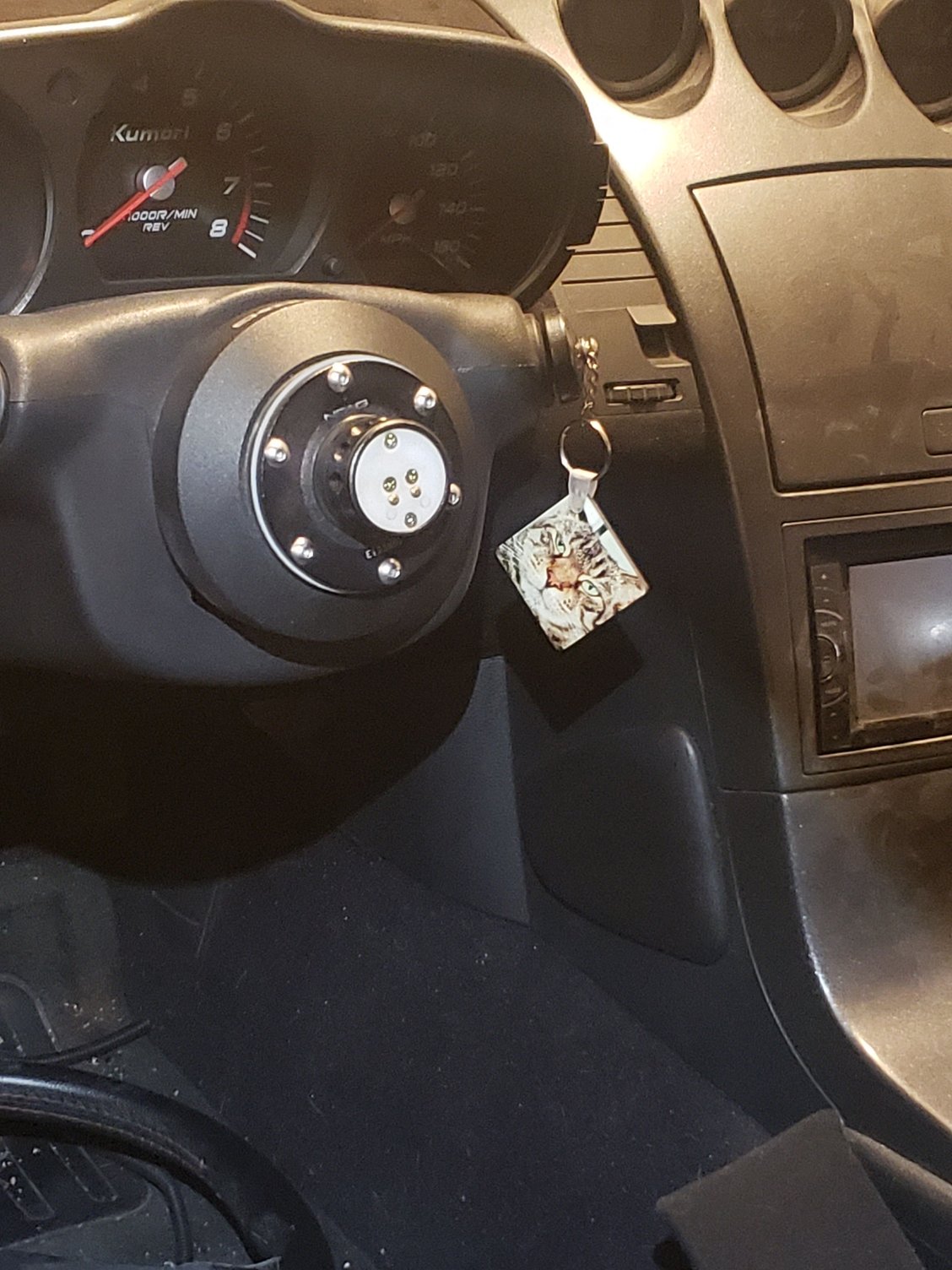

Got rid of the red tacky quick release and threw on some black. Car will be wrapped gloss black, so I rather them blend in.
Tomo - Gotta get some double sided tape today for the spoiler. Fits a lot better after a lotta trimming; although compared to when it was on an OEM hatch, the fitment is worse. Also will be taking off the hood n drilling out the brackets a bit more for better fitment and clean up the hood latch cuts I made years ago.

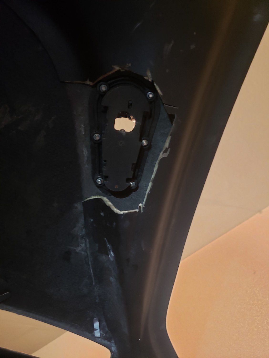

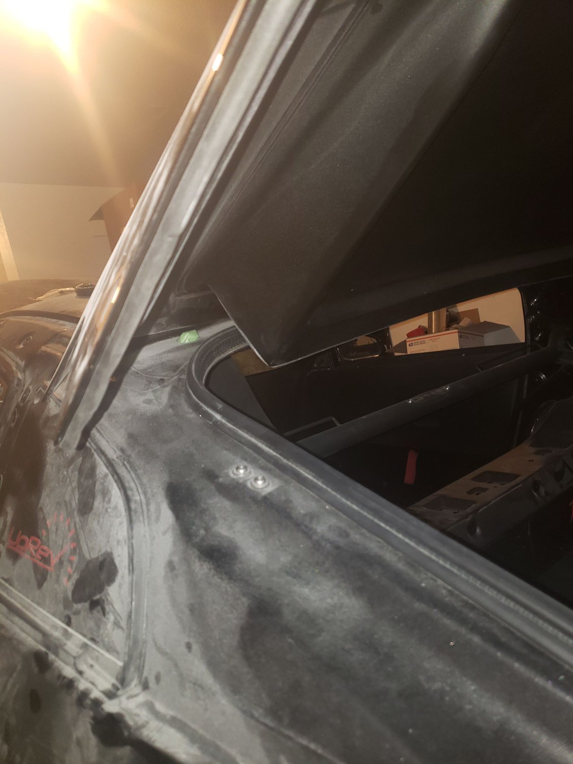

Removed the hatch and sanded off the little bit of surface rust on the roof from rock chips n sanded everything smooth, ready for paint. I never plugged the hole from where I believe the hatch wire harness came from, so some aluminum and seal sealer fixed that. Glad I ended up doing this or I woulda had a water mess once I washed the car.

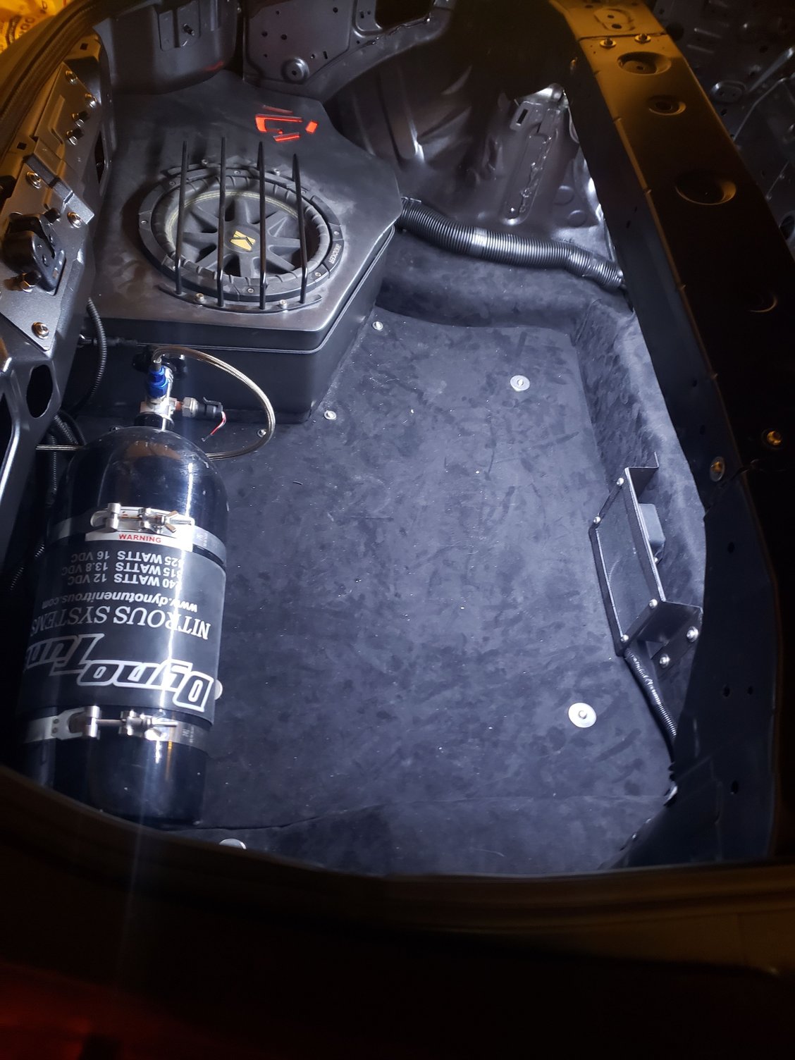

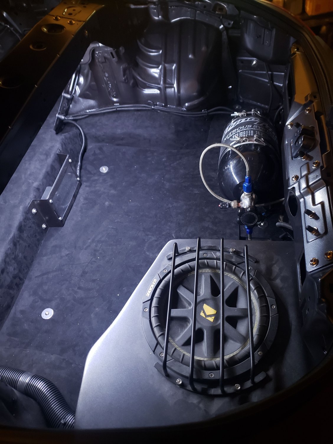

Trunk area is finished! Happy with how it turned out. Nothing is being cleaned till until the car is rolling. ~ Later on I'll redo the sub enclosure and would like to make some trim for the rear strut bar.

Get someone to weld up that hole. Also, turn the nitrous bottle 90 degrees, so the low side faces the rear of the car. The pickup is at the bottom of the bottle. When you're accelerating, the nitrous gets push towards the rear of the car.

It would have been cleaner to have it welded, but I figured the patch I did will suffice. I use to have a welder I could go to and have him do anything I needed quickly. Theres a few spots I need welded, that I figured will get done once the car is down for a while again.
I mounted the bottle sideways due to routing/simplicity and when I originally mounted the bottle, I tried to orientate it the way you suggested but was having trouble with the bottom side being accessible due to the frame/subframe. Woulda been much easier with a false floor. If I do have issues arise, then I will change it. Appreciate the advice!

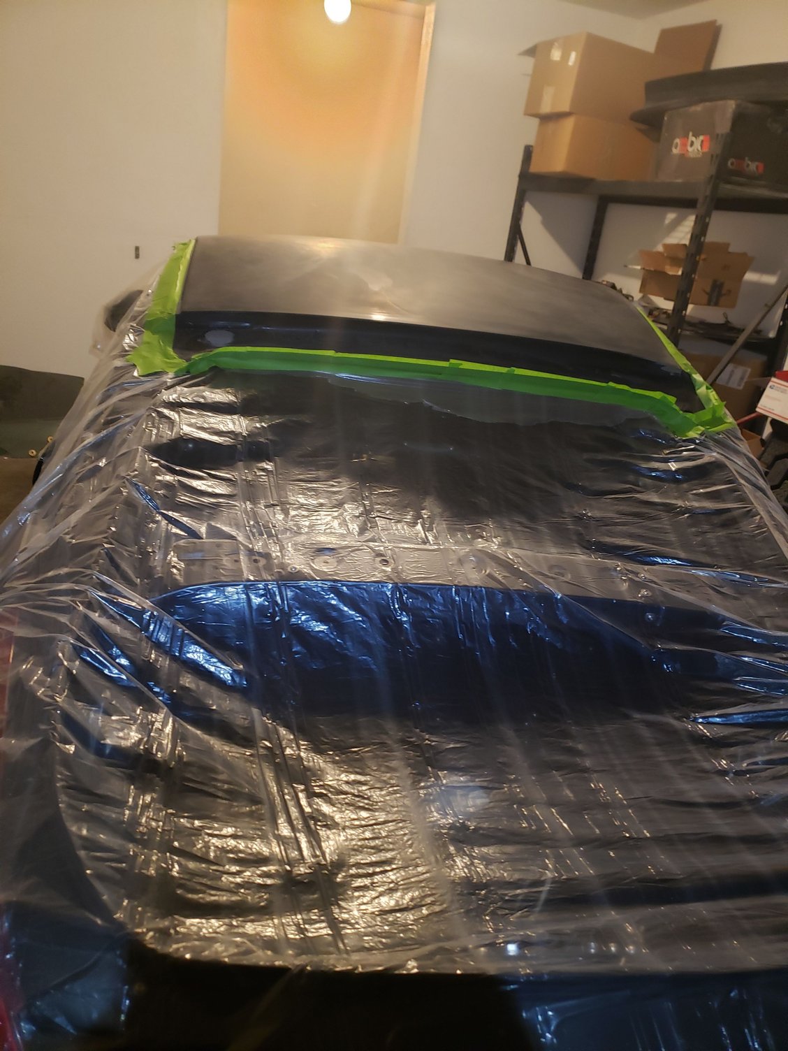

Painted the roof area. Striped a bit as expected. but its all one color, no rust/bare metal, so I'm happy. Gonna be taking off the sideskirt and fender so I can align the door better and repaint the fender. Fender got banged up from not being on the car for over a year.

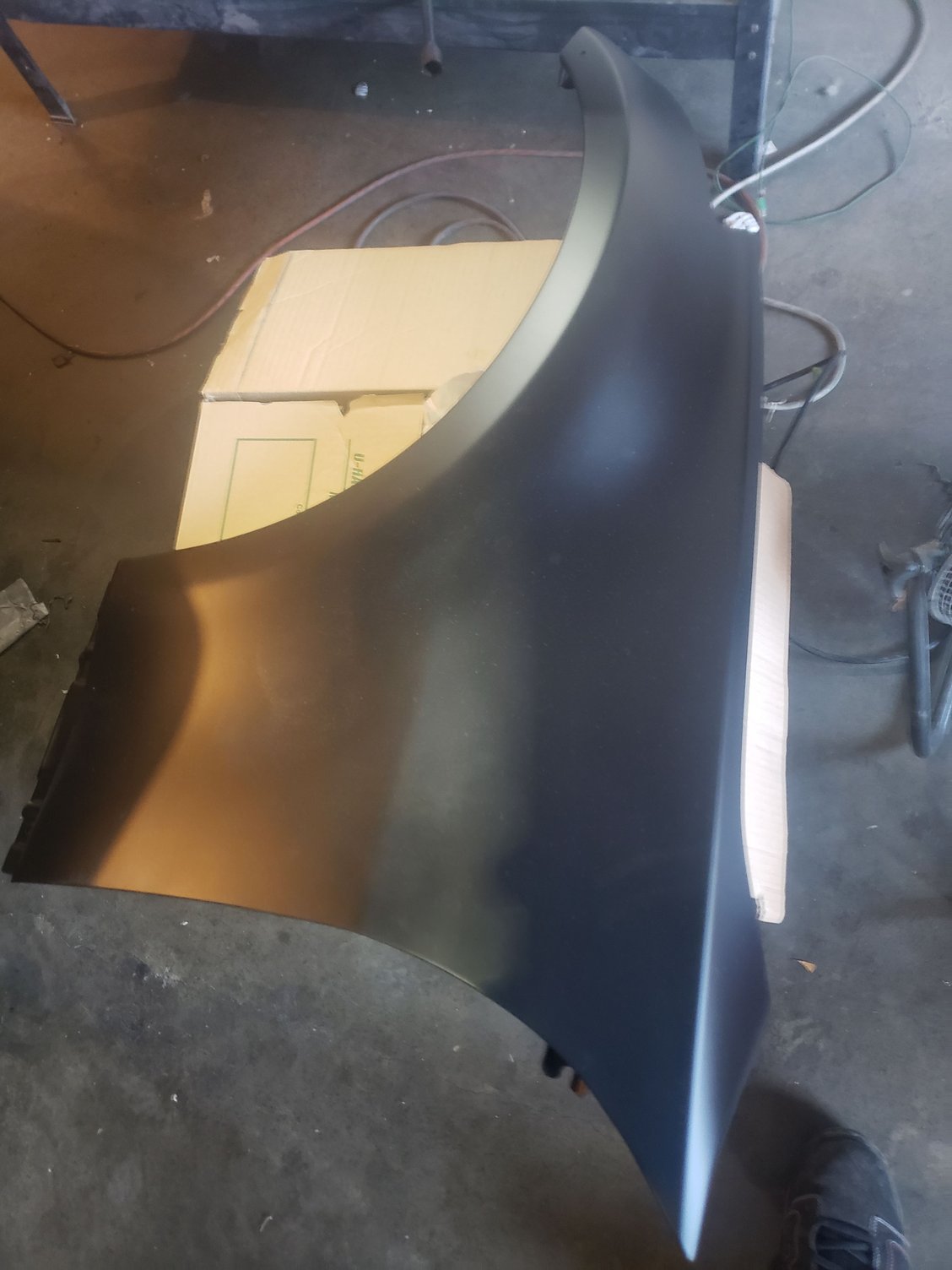

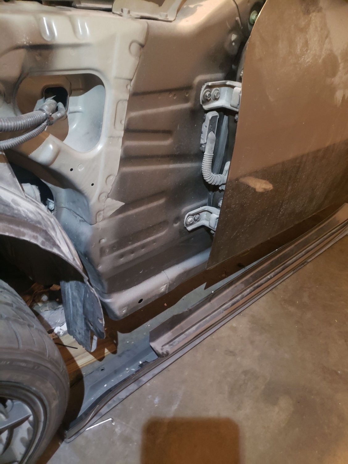

Fender off for paint!

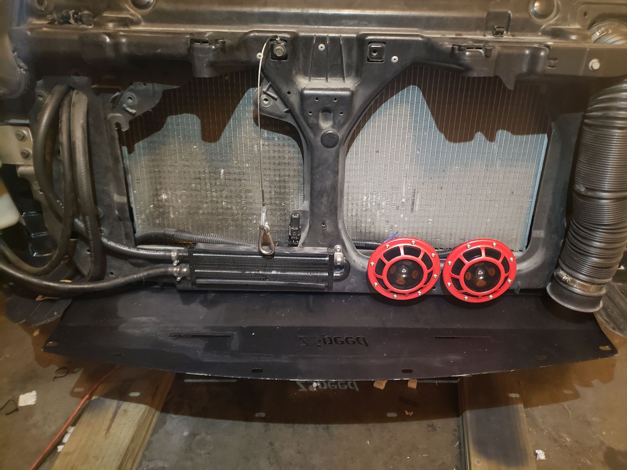

Horns assembled with new hardware after repainting. Will be making a bracket for the secondary latch tomo.
Got a keychain made to replace of the doge. Use to make my money streaming and this was a commonly used emote, so I used the original picture.

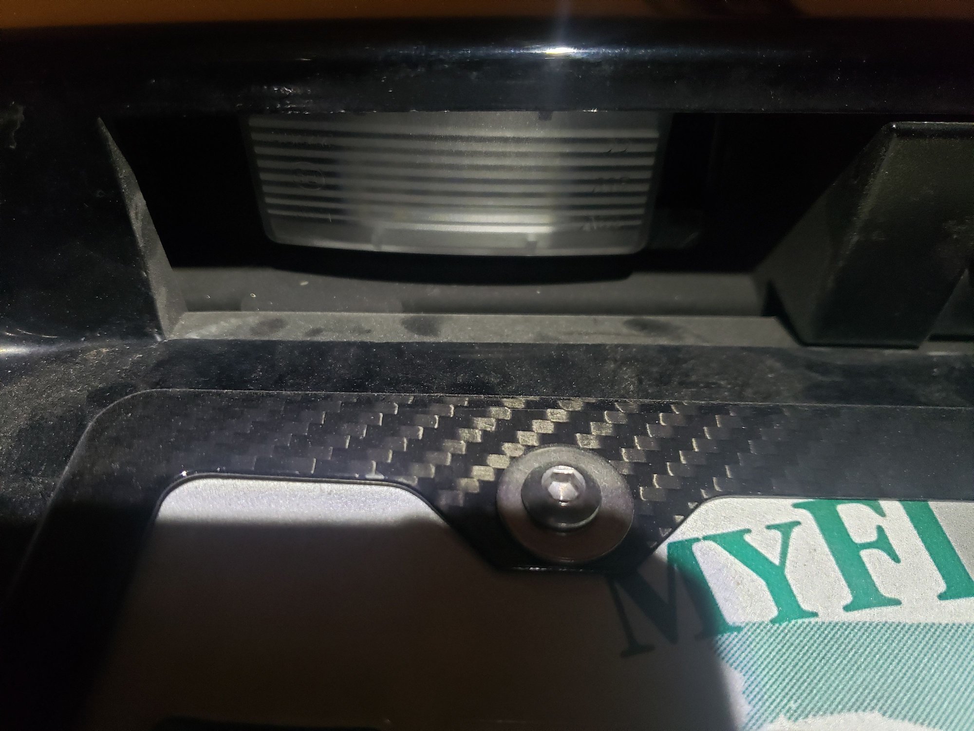

I lost one of the license plate light assemblies, so I purchased new ones for like $15 with the led board already installed. Still havnt tried them.

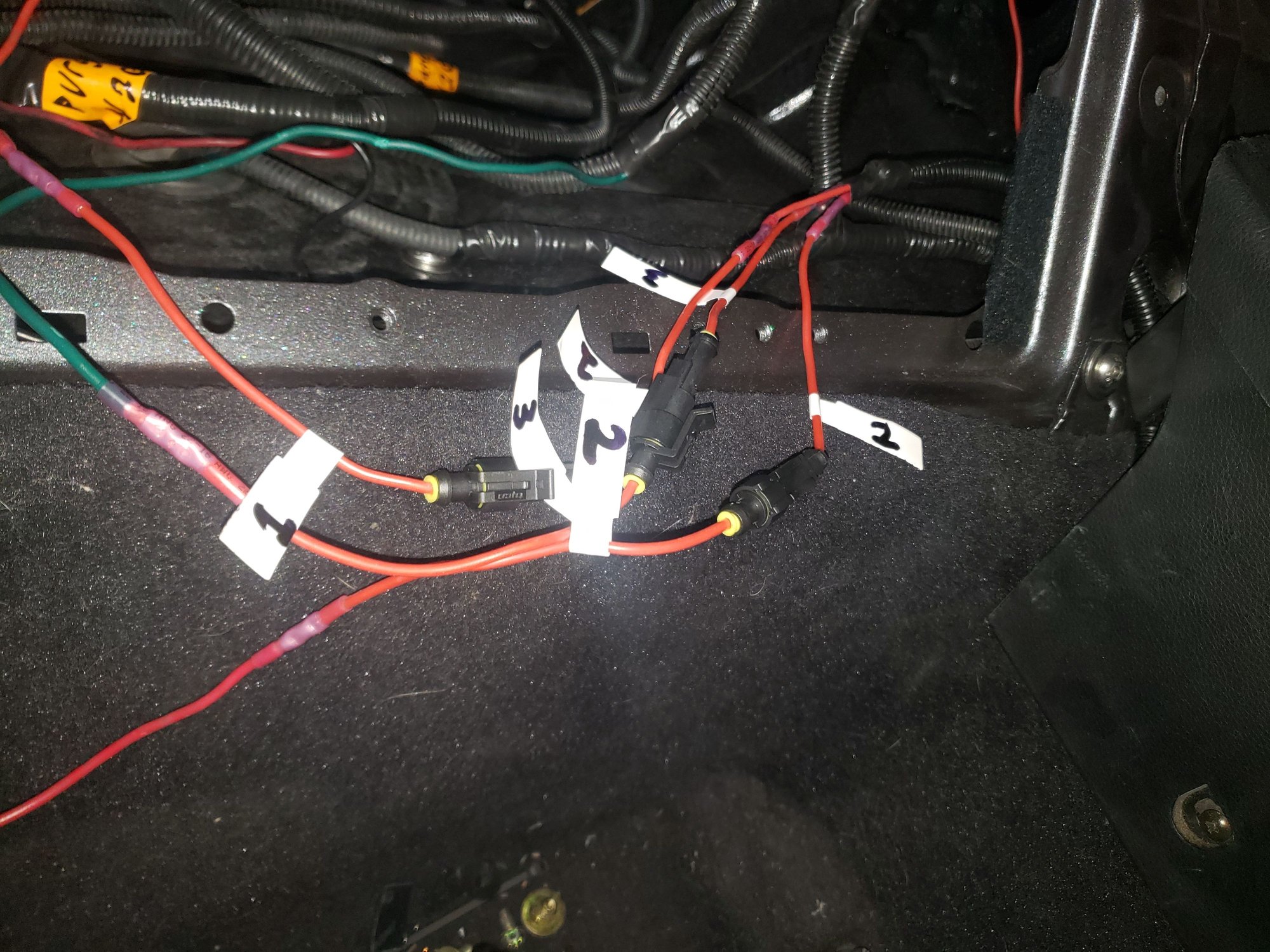

I spent hours yesterday fixing a wiring issue. I pretty much always have the hatch/doors open slightly and just disconnect the battery; so I didnt notice till yesterday, but the hatch light would not shut off. I gave the hatch light a constant ground, which was a big nono. Got the hatch back on and put a washer under the bracket, fits much better now.
Still experiencing hyper blink for some odd reason, did not have this issue before hand. Gonna buy some resistors n hopefully tht fixes it.

Fender painted.

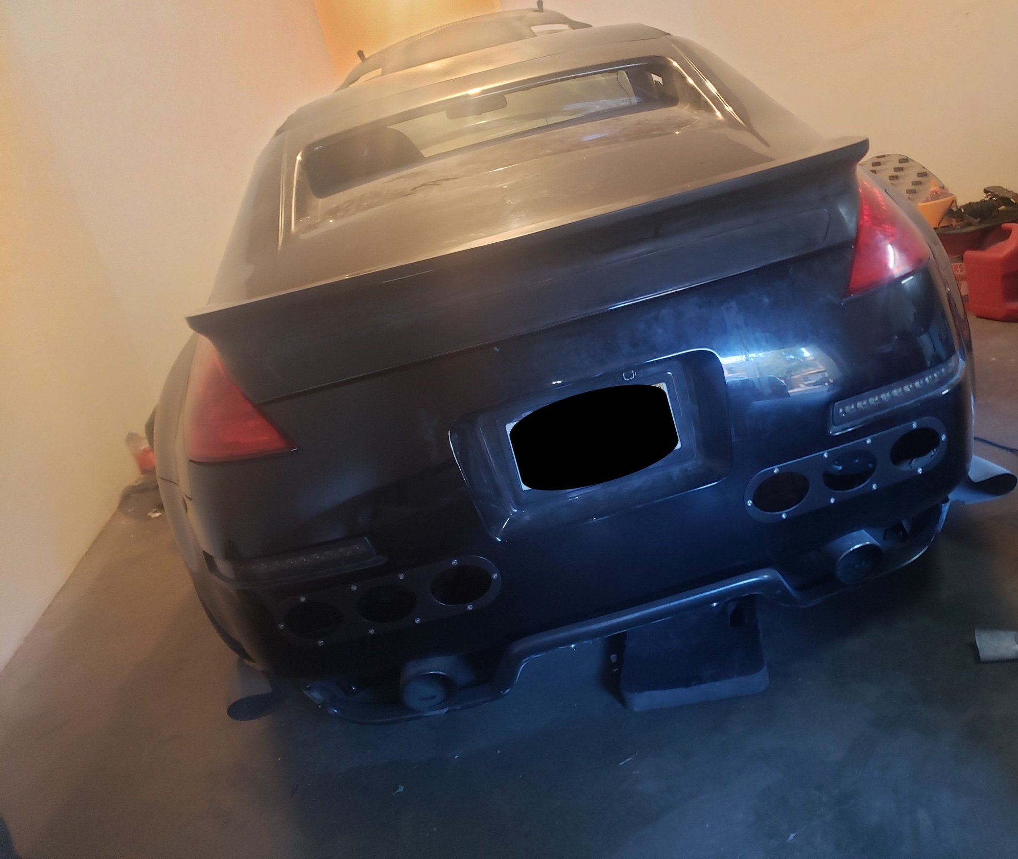

The car and tools are pretty much all that is left at the old place. Waiting on my base map to turn it over.

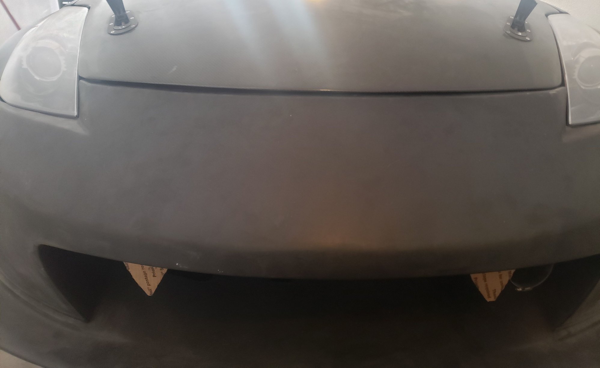

Fixed the fender/door gap and afterwards spent a long time on the hood. The hood is a Seibon TS HR, fits pretty badly tbh. I made the best outta it. I enlarged the hood hinge holes, added nylon nuts and black nylon spacers. Looks much cleaner than washers n steel rusted nuts. I closed the gap on the front bumper but it lead to the hood sinking below the fenders BADLY. Added a small rubber stopped on the hood and adjusted the hood latches and I am happier with how it looks and latches now compared to before.
Hood is way more centered now, no more massive gap near the passenger fender. The Driver side gap is a lot closer bc the bumper was not secured for the pic.
Had my younger brother come out to help me with the hood, always made fun of the catfish/nurse shark bumper n decided to add some teeth.
