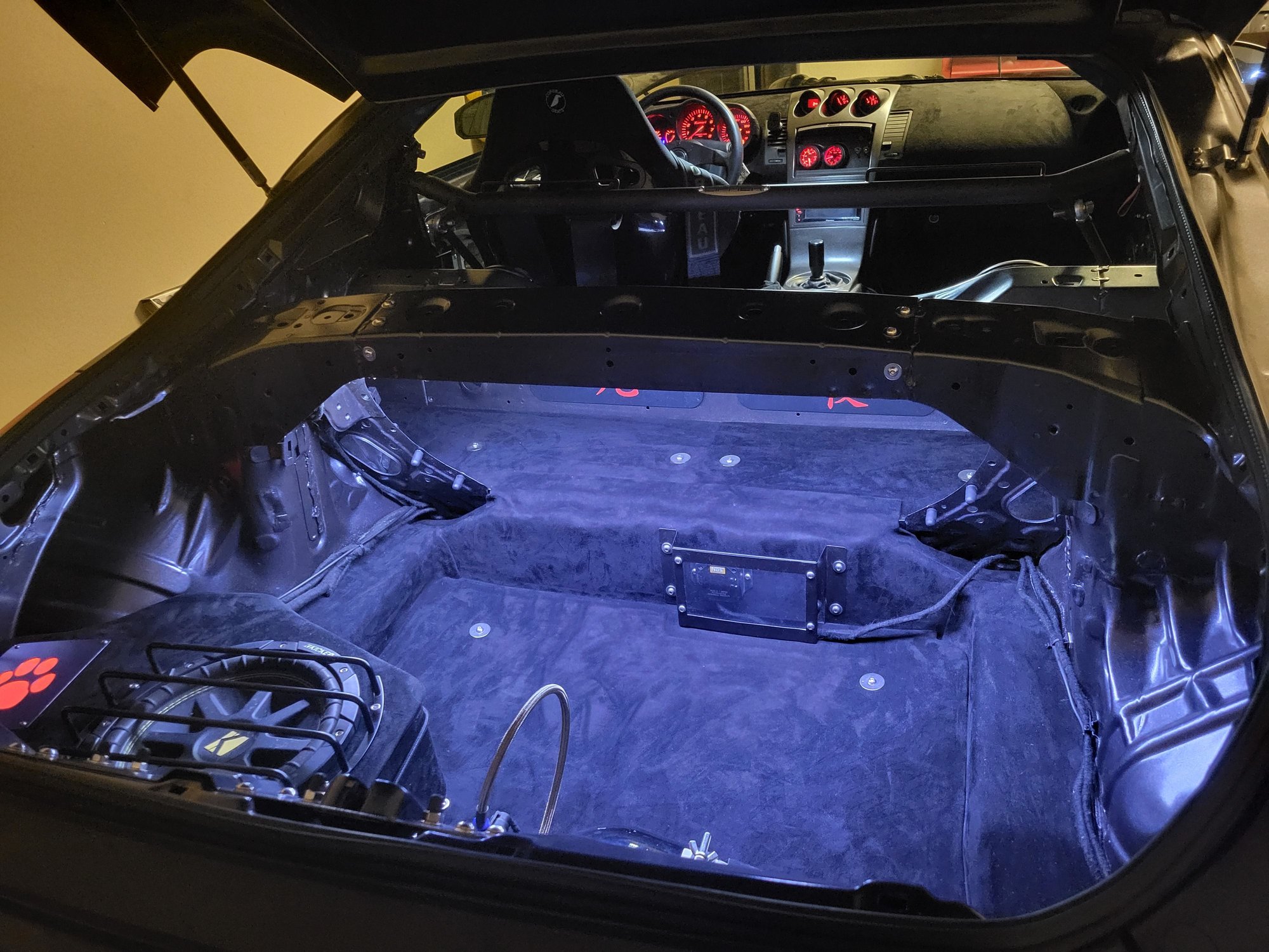

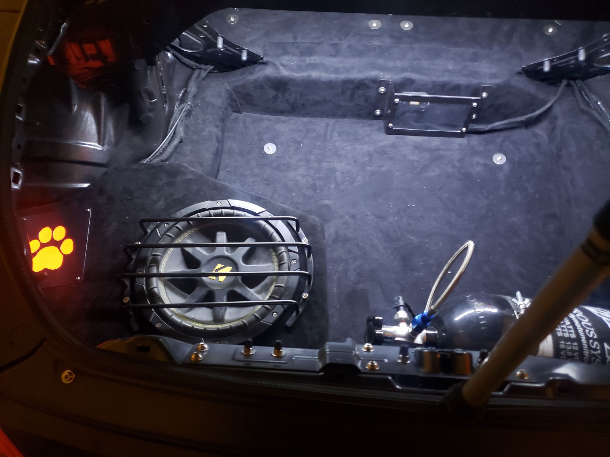

Sooo an update lol. Got through the hour drive to the new house (months ago now), was overheating randomly for the last 20 miles and had to pull over a few times. Turns out there was a leak on the passenger coolant pipe and another issue. I drilled a 1/8'' hole into the thermostat and replaced the coolant pipe with a silicone hose, seems the overheating is fixed now.
Bought a new OEM oil pressure sensor. Oil pressure is now accurate to the oil pressure test I did. NEVER buy non oem sensors for this car. This was the first time I did not, and it caused a lot of issues.

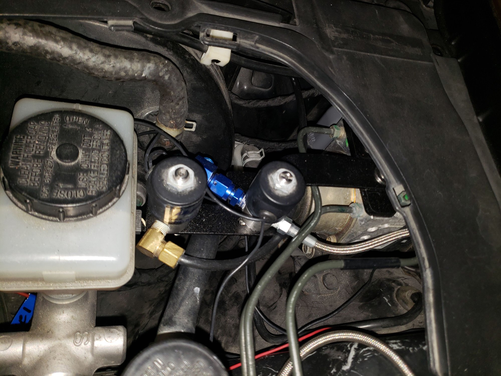

Finally made new brackets for the nitrous solenoids. Something I have put off for a while. Old ones, n then the new ones. Tried the alumiweld, it made the brackets easy to make. These are the old janky ones.. New ones are already installed.
Got rid of the rubber and replaced them with carabiners and spandex. Tight seal and no more issues. Gotta get new shrink wrap to cover the ferrules instead of the tape.

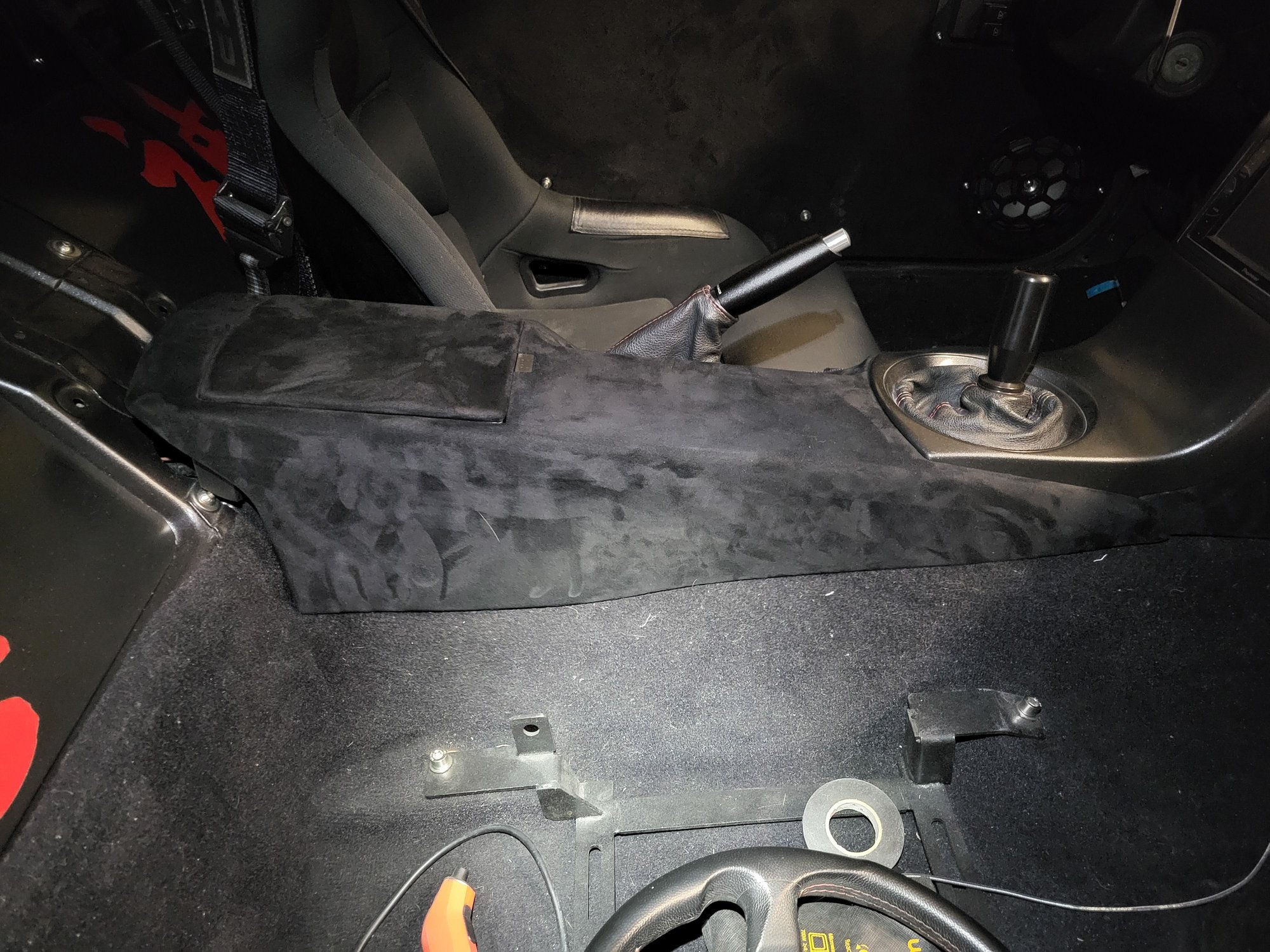

How the interior sits now. Also finally relocated the OBD2 port to the passenger side. I wanna redo the Door panels completely soon

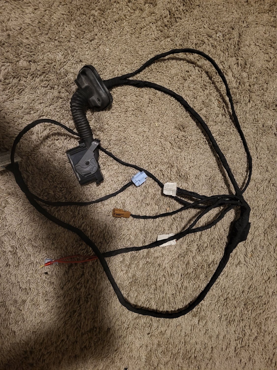

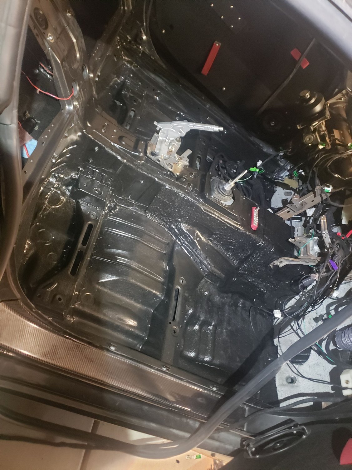

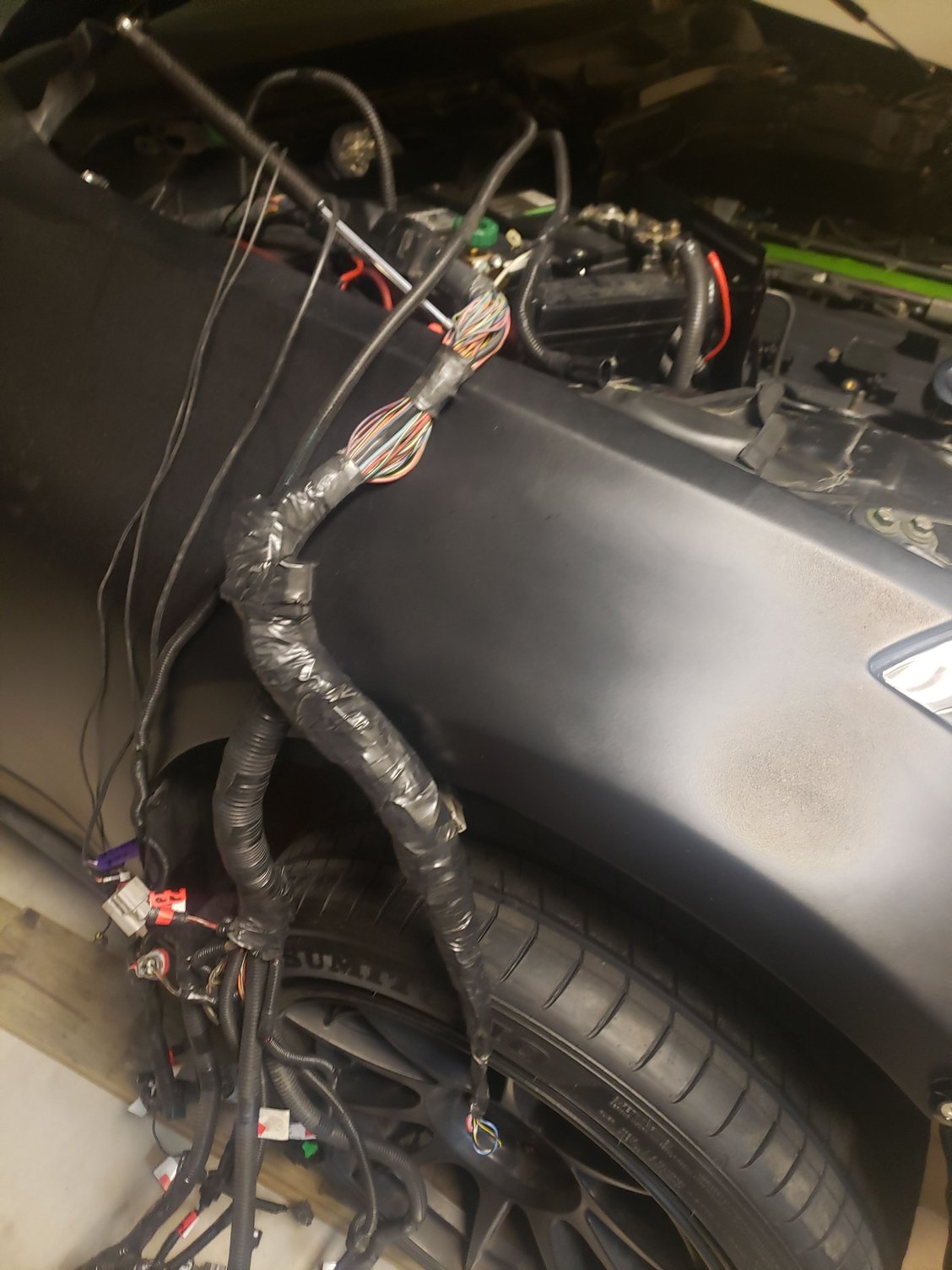

This took a while.. I took out all the harnesses (EVERYTHING), labeled, unwrapped, removed/rerouted wires, and finally wrapping it all up with Tessa tape. Was not a fun job, but everything is so much easier to access and remove now, slimmer, and cleaner. Below are some before and after. The center console area I messed with before, was horrible. I fixed all connections but it was very messy and the loom was trash and bulky. Ending up removing a large amount of wires in this area too. cleaned up the floor and got rid of any surface rust, then bed linered. Some before and after pics.
You can see the ebrake handle reinforcement on this pic, there normal is a large gap near the button. Painting the floor, after finishing the wire looming.
Had to redo the spoiler for the 4th time? FINALLY happy. used primer this time on the spoiler, made sure to use VHB tape, and used the AZ sun this time.
With the Brake handle cover, I had to cut and trim a lot off the ebrake handle. Yanked extremely hard on the Ebrake on accident and snapped it after years of use... Bought a new one though, trimmed it up, and used the alumiweld to brace it on the sides, so it wont snap again. Only have a pic of it snapped.

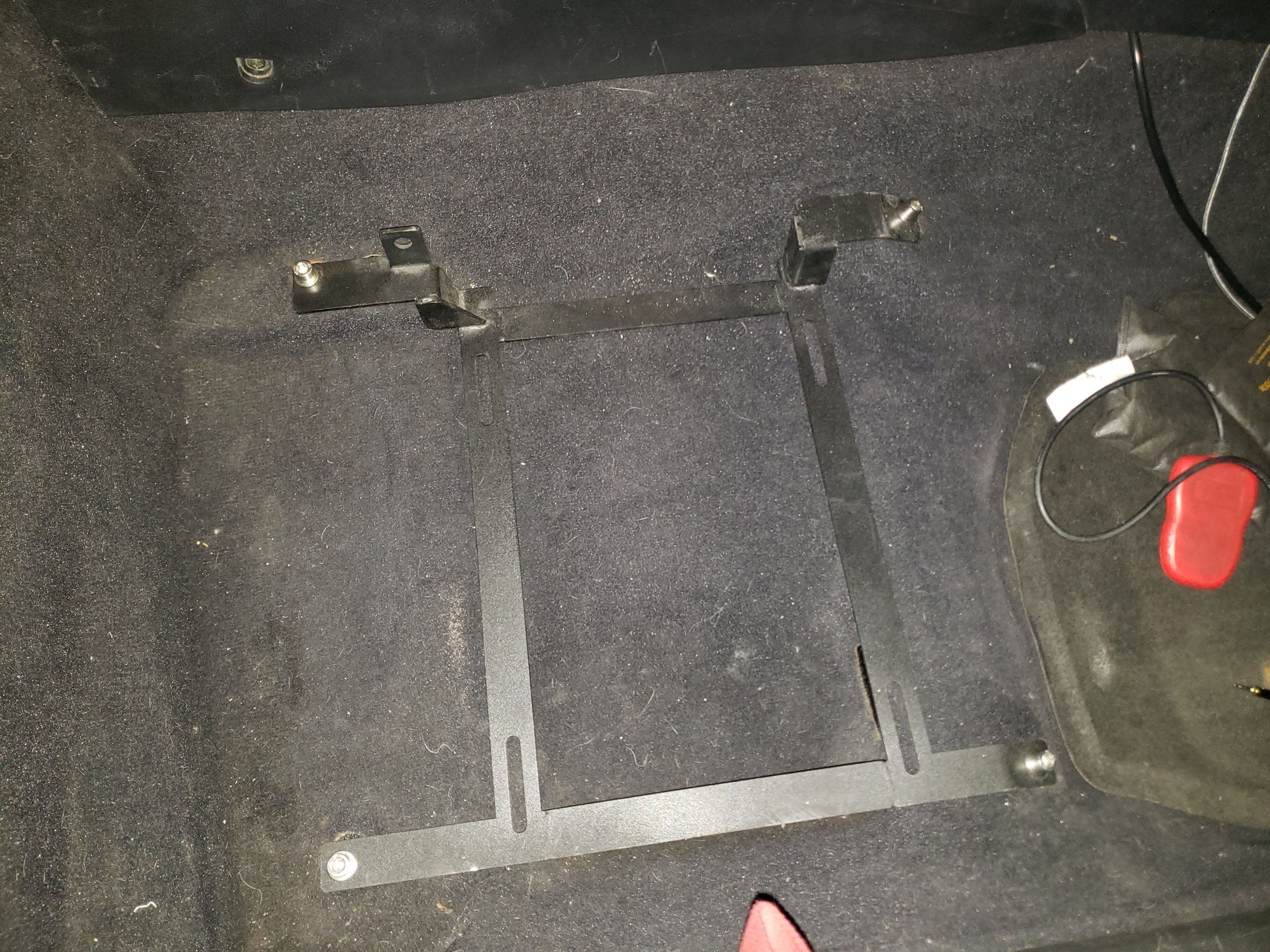

Fixed the passenger seat bracket, had to put the proper bends into it to fit without resistance.
Next up, few more fixes, sub box, Carbon A pillars, new door panels, wrap, getting off a base tune.

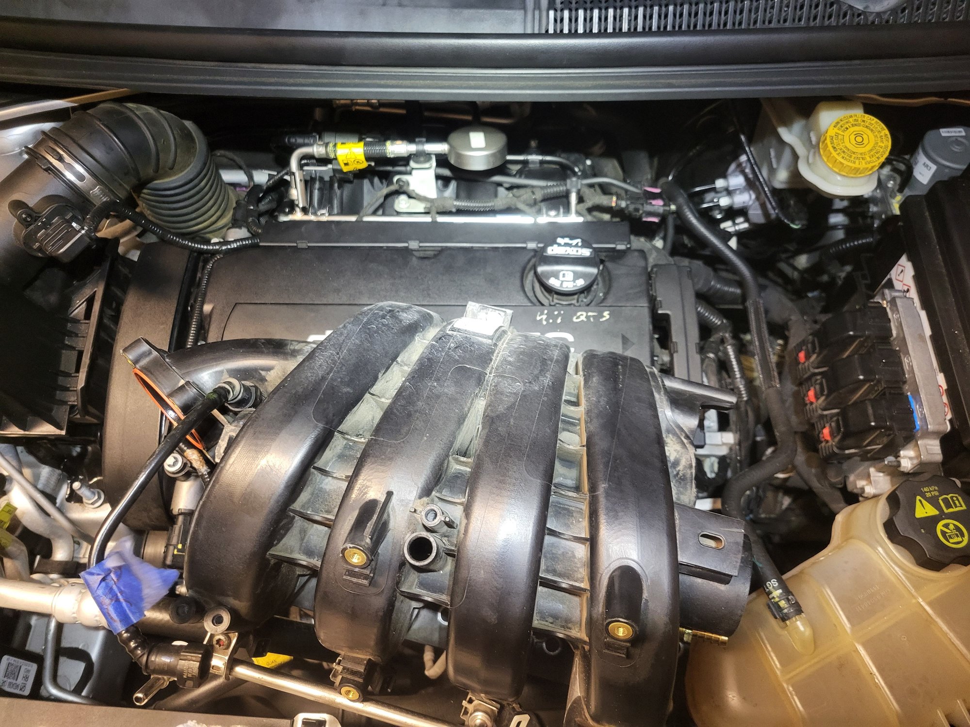

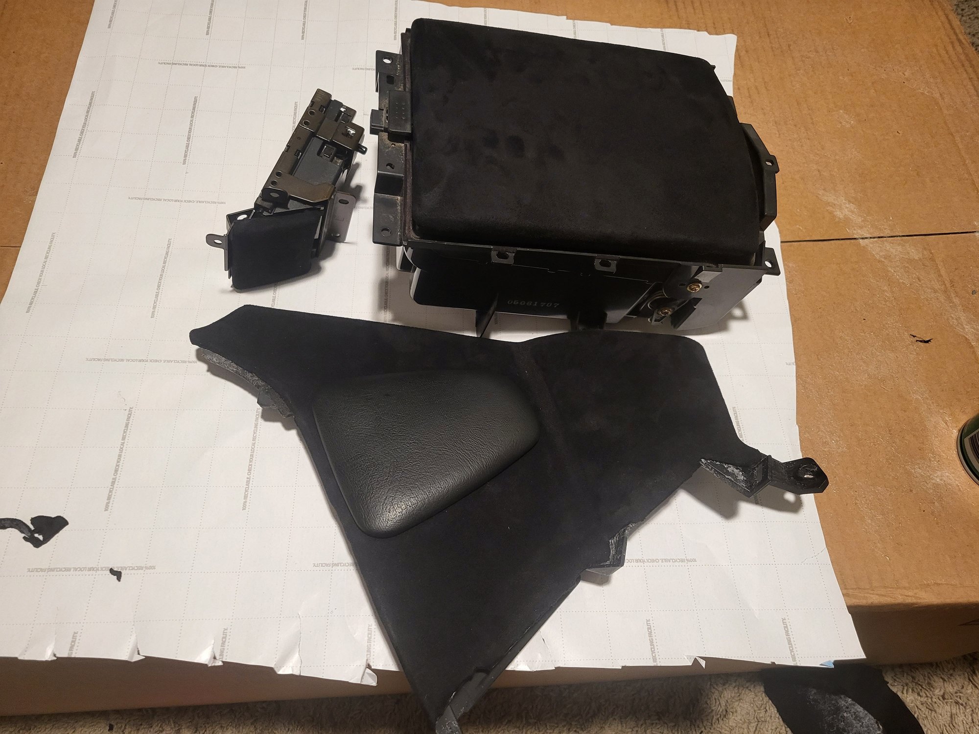

Small update.. Bought a 2015 Chevy Sonic Sedan 1.8L manual with 82k. Fun little weird looking car. Replaced clutch/flywheel, new tires, basic maintenance. Gotta do the timing belt soon..
Previous owner somehow broke the nipple from the intake manifold to the brake booster and JB welded it back on (leaking). I had to replace the whole manifold ($430 new, which was the best price I could find). WHAT A PITA! Had to disconnect coolant lines, fuel lines, so many different types of harness connectors, remove valve cover, remove 2 engine mounts and drop the engine, just to get it out of the engine bay..
Z has taken a backseat and have not done much.
Finished the subbox a bit ago, don't have any pics of it really atm, redid it in suede and got rid of the symbol.

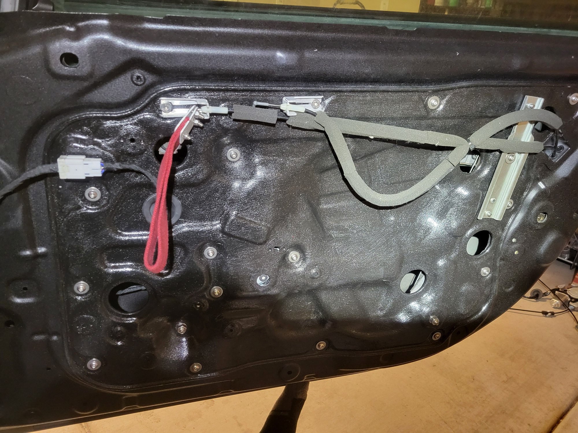

Got the window assemblies installed! Window tracks were cleaned and regreased (BIG difference in performance), new stainless hardware, bedlinered door panel, and newly wrapped door harnesses re-installed.

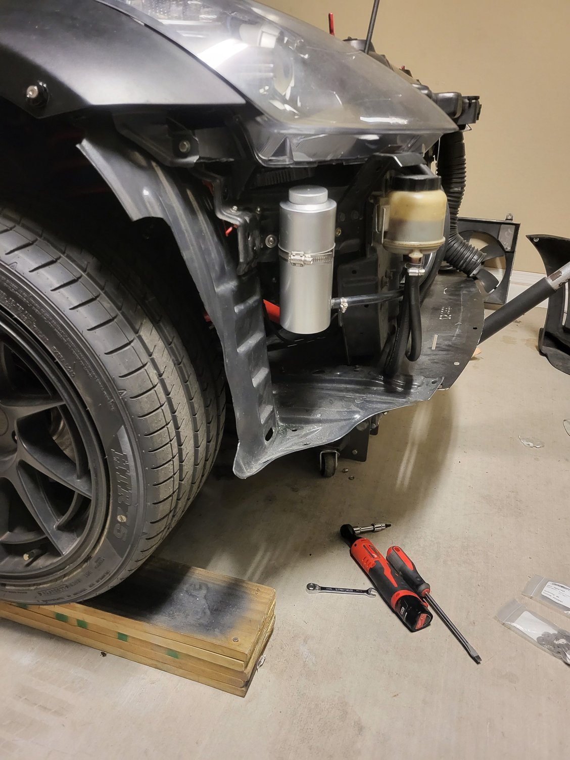

I had a Doorman plastic coolant overflow tank, which snapped the nipple off recently, so I installed a new aluminum tank for the coolant, should not have an issue with it now.
When dealing with my overheating issue, I noticed my fans never turning on. I did the test where the car runs through the electronics, including the fans. I had power at the relays and harness ends. Replaced with a Mishimoto fan shroud and works perfectly now.

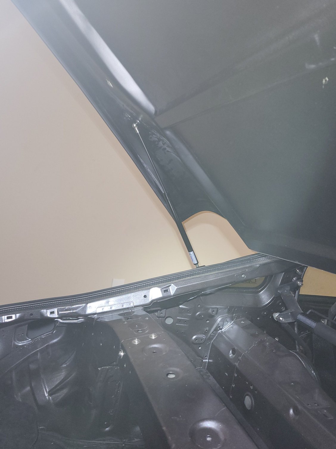

FINALLY got some struts for my carbon hatch. Here is the thread to the specifics of the struts... Also finished grinding away at the hatch side near the strut that was rubbing on the body.

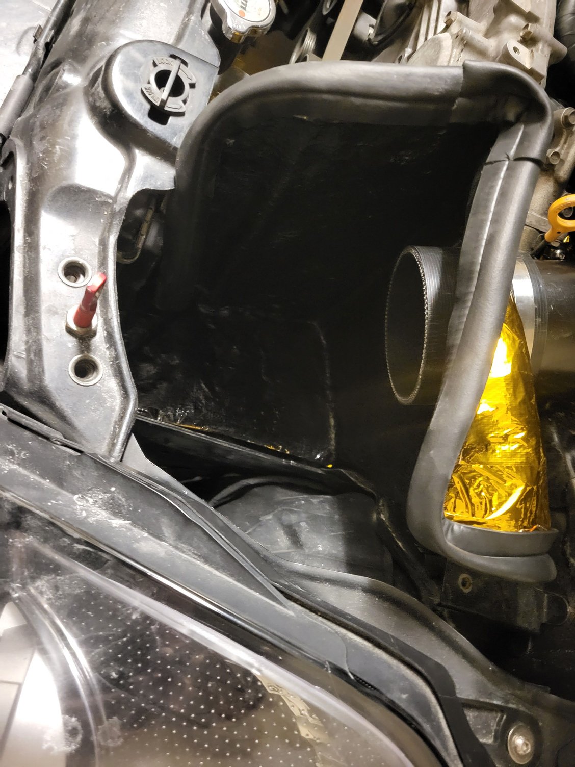

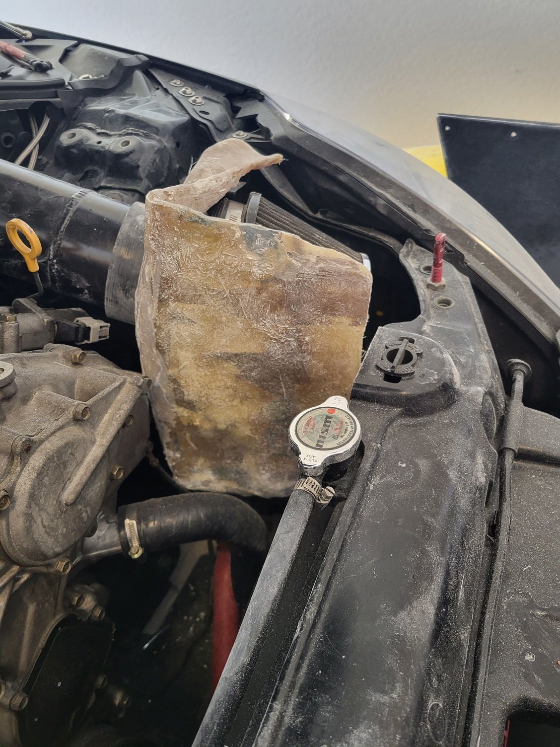

Got the intake heat shield all mocked up. Started to fiberglass it already, just gotta wait on more resin. It will seal against the hood.

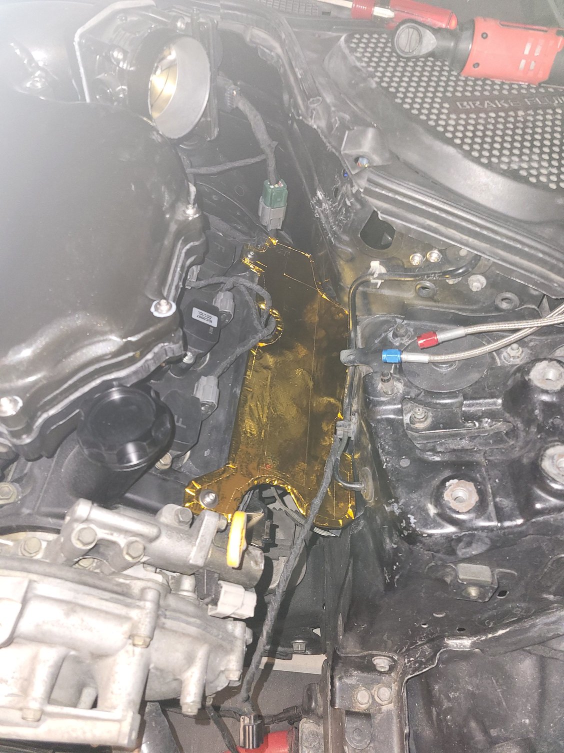

These were the only progress pics I took. Took a few tries to get everything fitting and sealing with the hood.

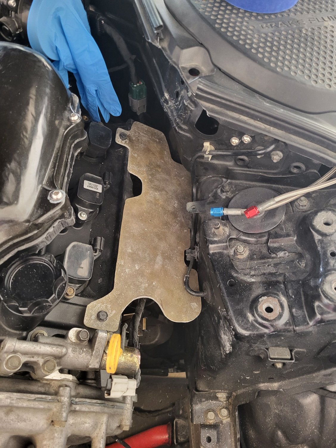

Wrapped the shield that goes above the headers. I have DC shortys that are uncoated/not wrapped; so hopefully this helps.
Finished the intake heatsheild! Here are some pics. Had to change up the design from the mockup due to the vented hood. Without the incline forward, it was popping through the vent and looked unfinished.
Both heatshields installed!

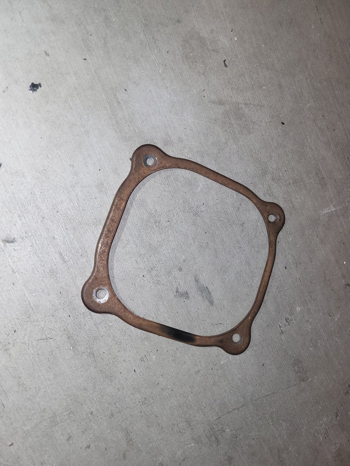

Cleaning up the exhaust and putting all new gaskets/hardware. The stillen exhaust is a pain... I have to remove the whole catback/w brace due to the U clamps. Had some Vbands welded on so this is not an issue again.
After Vbands.

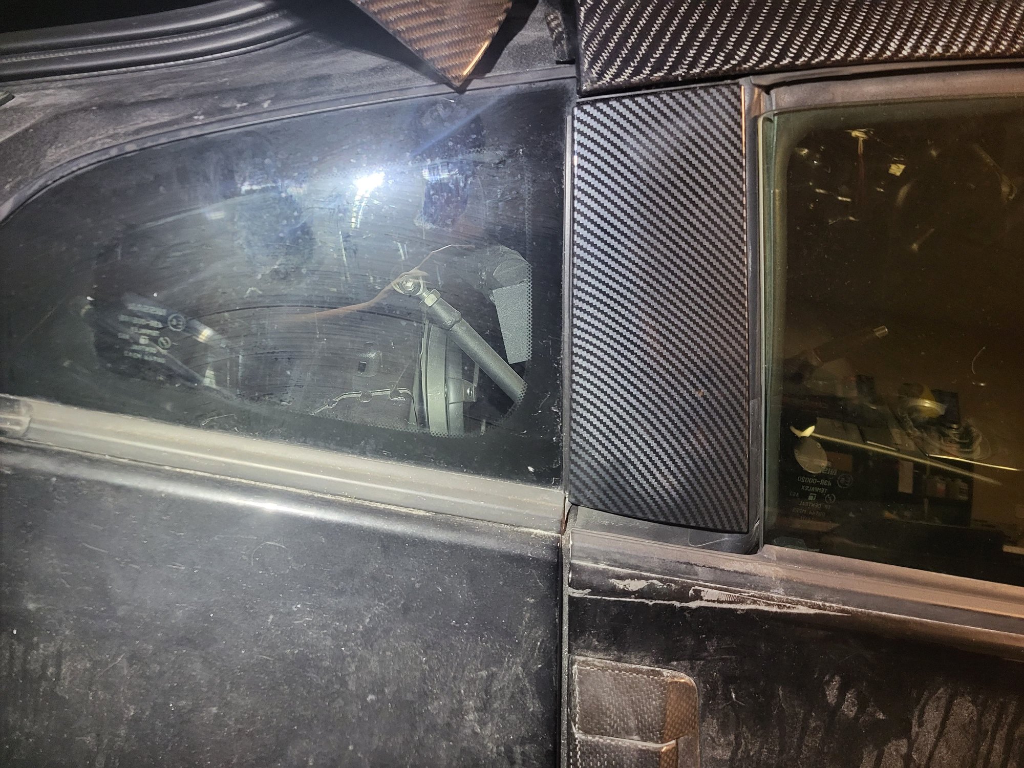

Misc - Also put on some hydrodipped B pillars that I will lay with carbon later on to match everything else. Removed all rivnuts on the sideskirts and hard mounted them, I never trusted the rivnuts in plastic and 2 rivnuts were almost pulled out. Got a used rear OEM crash bar and brackets, gotta paint them still... I removed mine a while ago with intentions on getting a bash bar, but have since decided OEM is the way to go for me.

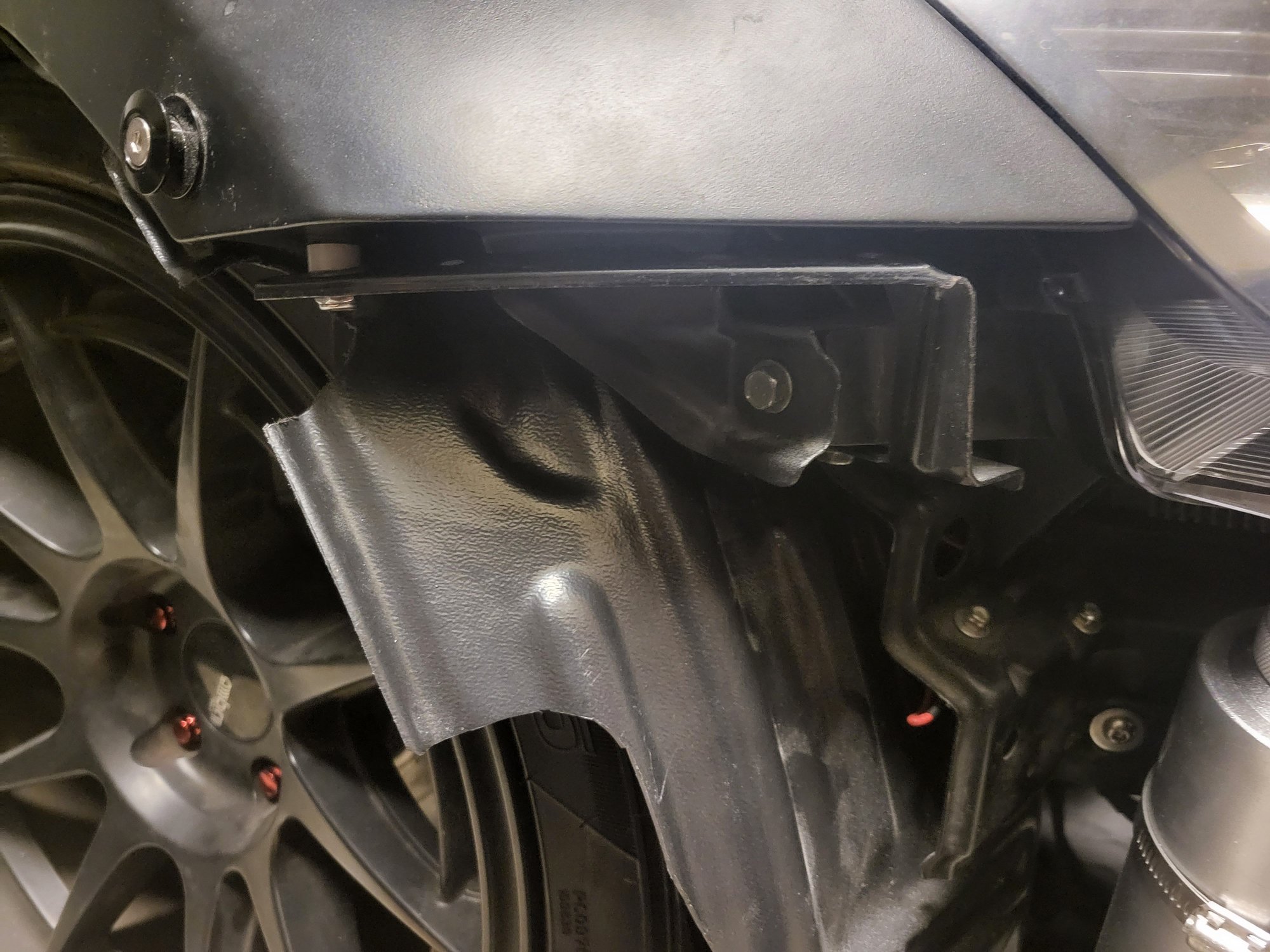

Everything on the rear...I made these foam blocks, wrapped with electrical tape (to not cut into it), to serve as a soft spacer.. Making the bumper light up nicely. Also adjusted the quick releases.... So, 2 bolts (at the op, under the hatch area), 2 zip ties, 2 quick releases, and the bumper is off without needing the tail lights out as well.

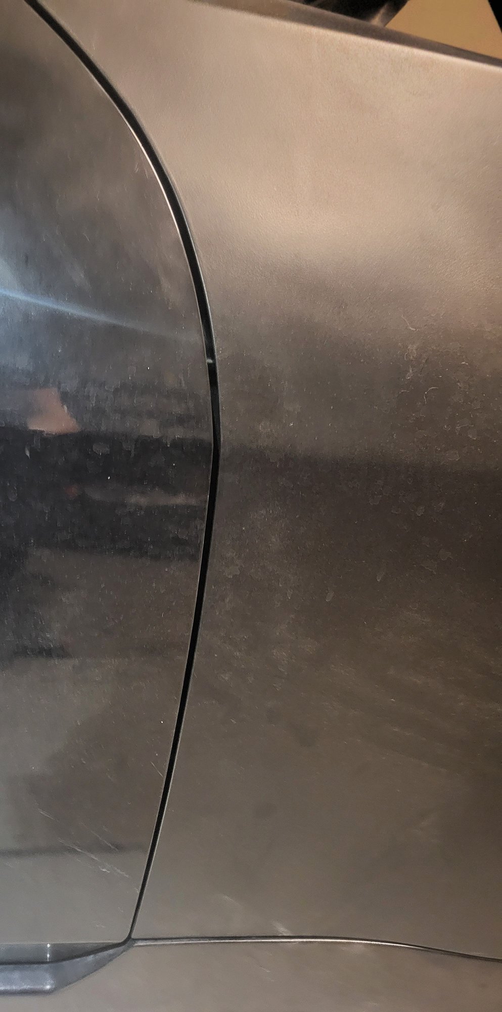

Body issues to be fixed.. Fenders need to be sanded (recleared), front bumper needs work for better fitment, fix a dent on the door edge, align passenger exhaust pipe better, and align doors better. Other than that, some basic filling/sanding/panting small areas that may need it.

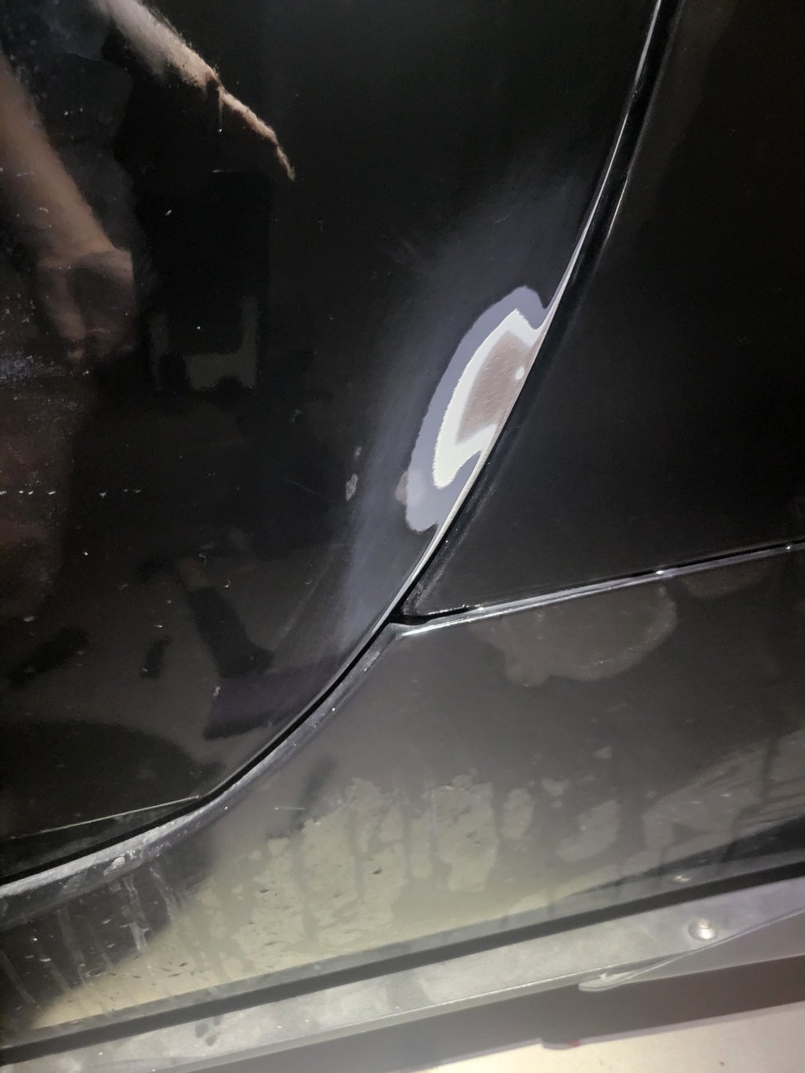

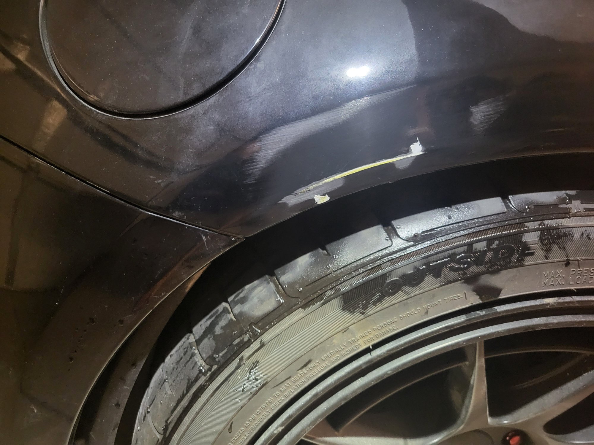

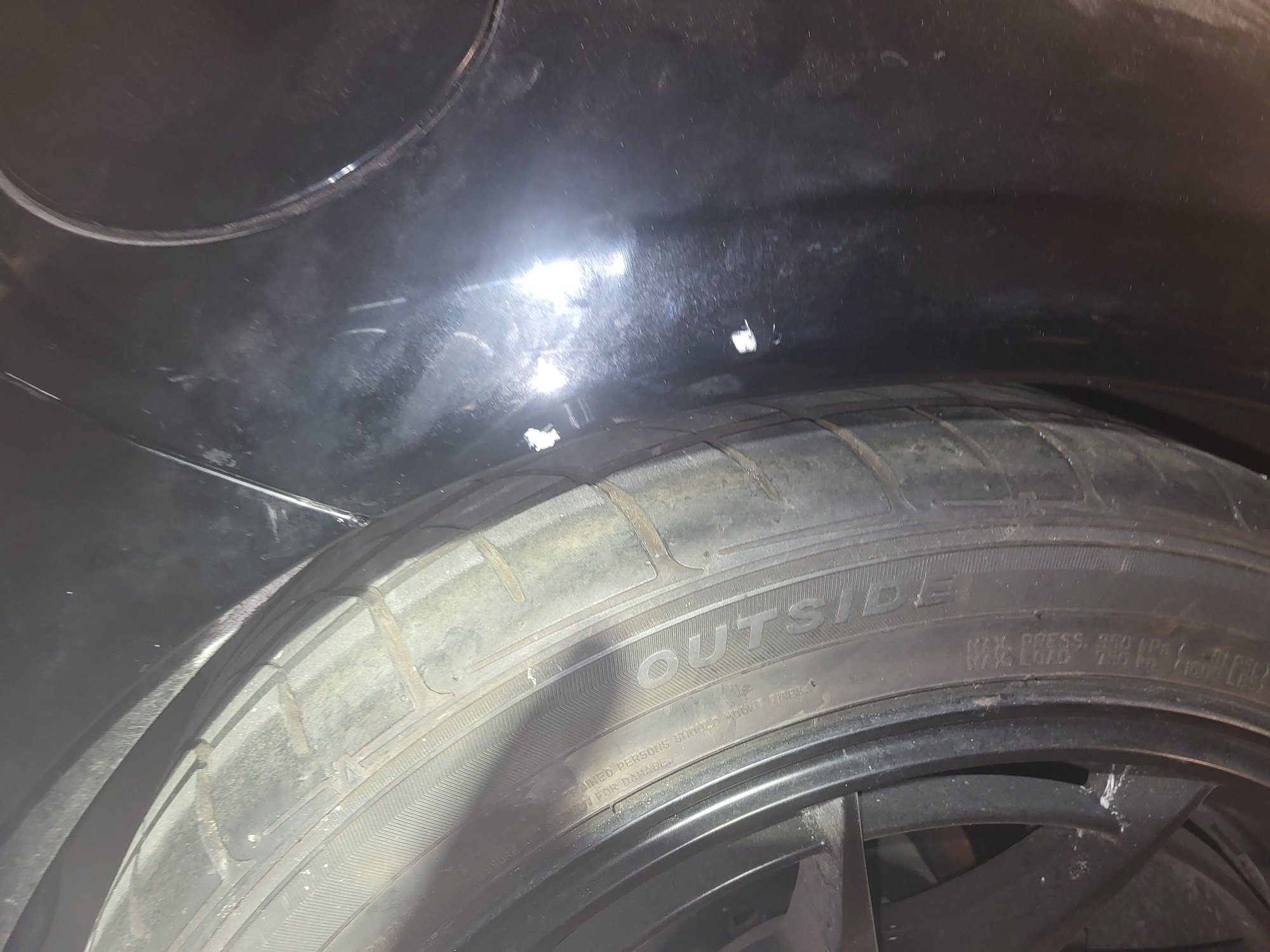

I had some passenger QP rust a while back. Got it repaired (new metal welded in before it got bad. It "LOOKED" like rust under the paint in these 2 areas... it was not thank fully, it was just bad paint (they had a good body guy, horrible paint guy).

Exterior wise, I'll be fixing the front bumper and adjusting the doors.
Interior, waiting on parts for the doors still. Hopefully this fits correctly....

Adjusted the passenger fender, door, and headlight .Below is the before and after. Much happier with it now.
AFTER
Started working on the front bumper. Decided to keep the side quick releases I currently have. Having fun witht he plastic welder, had to add some material near the passenger headlight and on both corners where the bumper meets the fender.
To fasten the bumper better and eliminate any need to go into the wheelwell, I mounted the bumper bracket to the fender directly with an added spacer, which the bumper just slides into place and gets sanwhiched.
Finished the door cards and installed them. The mirro switch panel came out great, as well as the speaker grills. The best part though is my leg/knee does not hit any of the switches and are no longer getting hit by my arm on accident.

Started the exterior work. Sanded the fenders.. Also adjusted the door/fender more on the passenger side after these pics and am happy with it now... The passenger door was slightly too close to the QP before and was unable to adjust it correctly as I forgot to unbolt the door strap.
Hammered out the slight dent and sanded the edge of the door.

Decided to start the center console and just be done with that area. Also wrapping the cup holder this time. Deleting the coin holder, switch panel, and rubber Ebrake trim, making the center console a lot cleaner

VERY happy with the center console. Deleted the ash tray, hazard button, switch pawnel, and the rubber ebrake trim.
