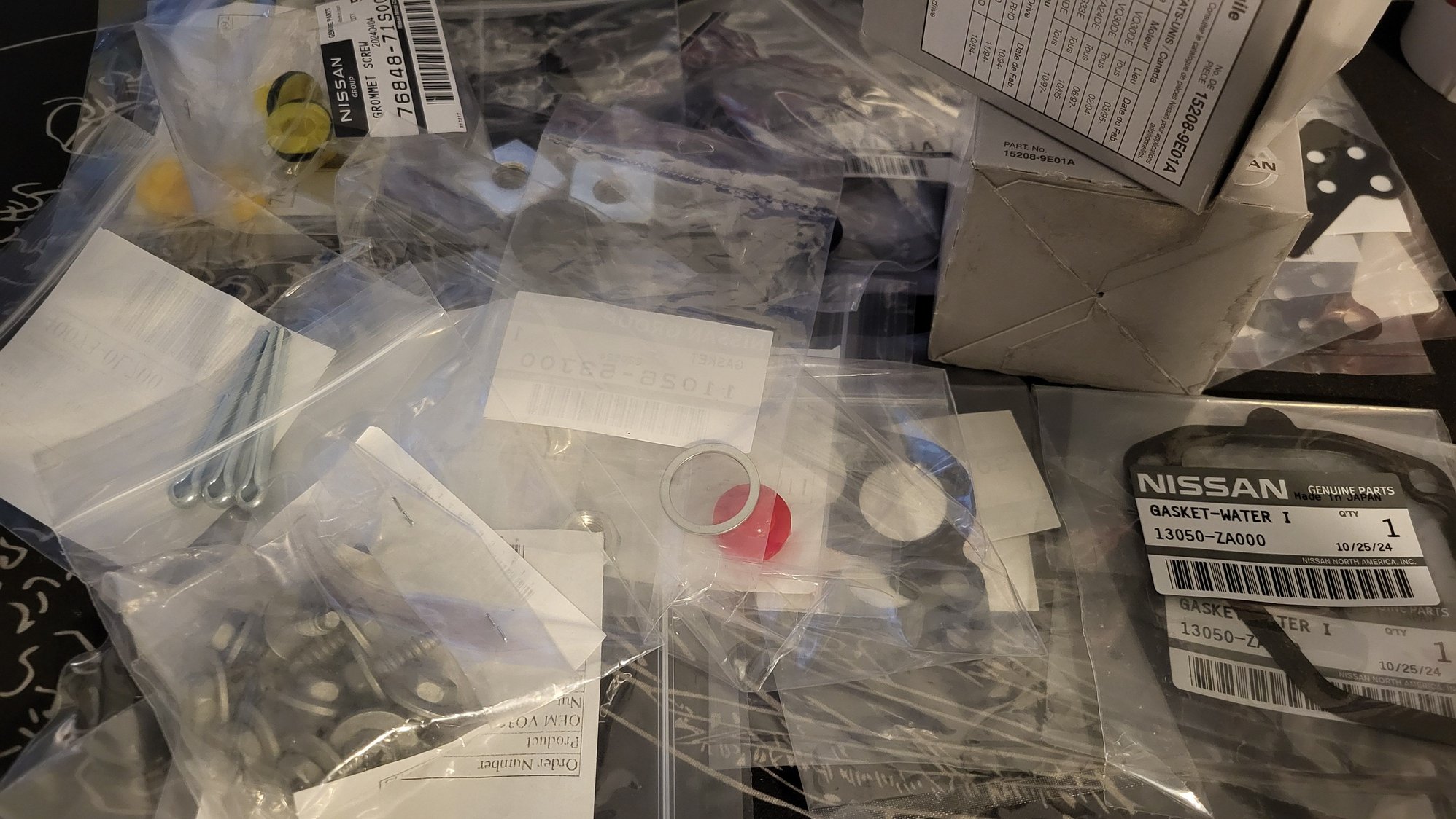

- Spent $150 on new oem/z1 gaskets/fittings for current/future use, as most aftermarket gaskers I have tried recently are horrible and leak still.
- Coolant Leak Saga.
Threw on new oem gaskets for the thermostat & cam solenoids. Leaks are now gone, and a new one is found... Turns out there is a pinhole somewhere on the thermosat, I can watch the drop form, guess it was 2 leaks, but I couldnt tell until now. Need to get it rewelded now.

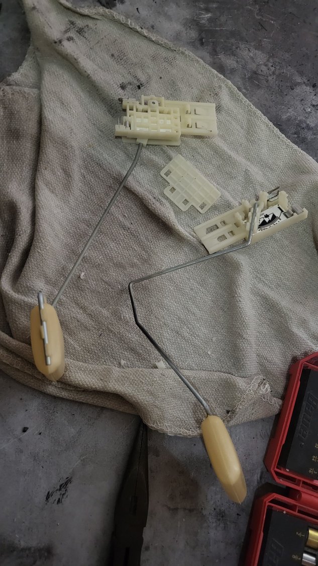

Got new fuel level sensors for $50 from ebay. Fuel gauge pretty much read only 1/4 or 3/4 full and would randomly change. Gauge is now showing slightly over a full tank (as the tank is overfilled, oops). Old ones below, was a bit tricky to remove the passenger sensor. I ended uup drilling the plastic tabs on the sensor to release it. Also, changed the driver side first, no difference on the fuel gauge really so guessing it was the passenger side that was bad.

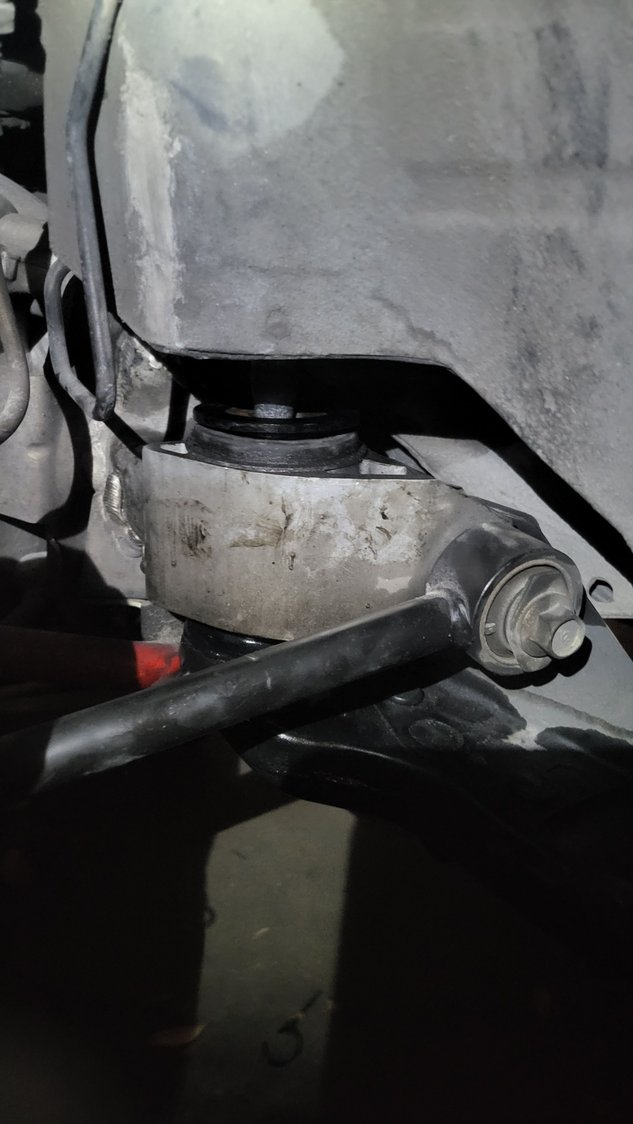

Installed the Z1 subframe bushing collars. Struggled for 20 mins getting the collars in and still couldnt. I left 1 corner slightly bolted to the car though. After i removed all 4 corners and dropped it a couple inches, everything slid in easily with lube.

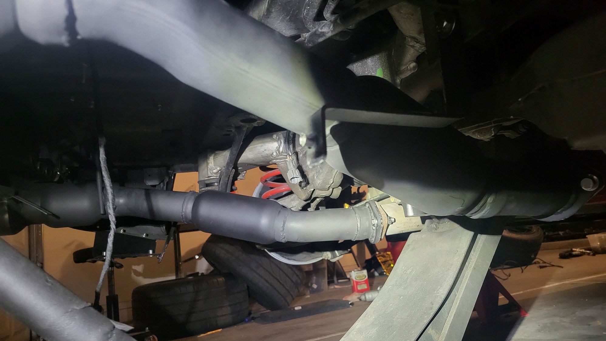

Took off the rear exhaust pipes, grinded the rust off, n painted. Not the prettiest, but the resonators REALLY help witht he sound.

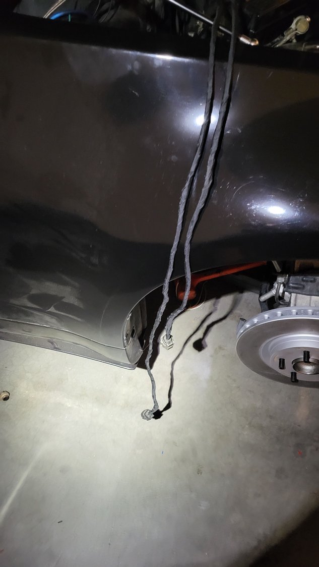

Started ewiring the rear 02 sensors.

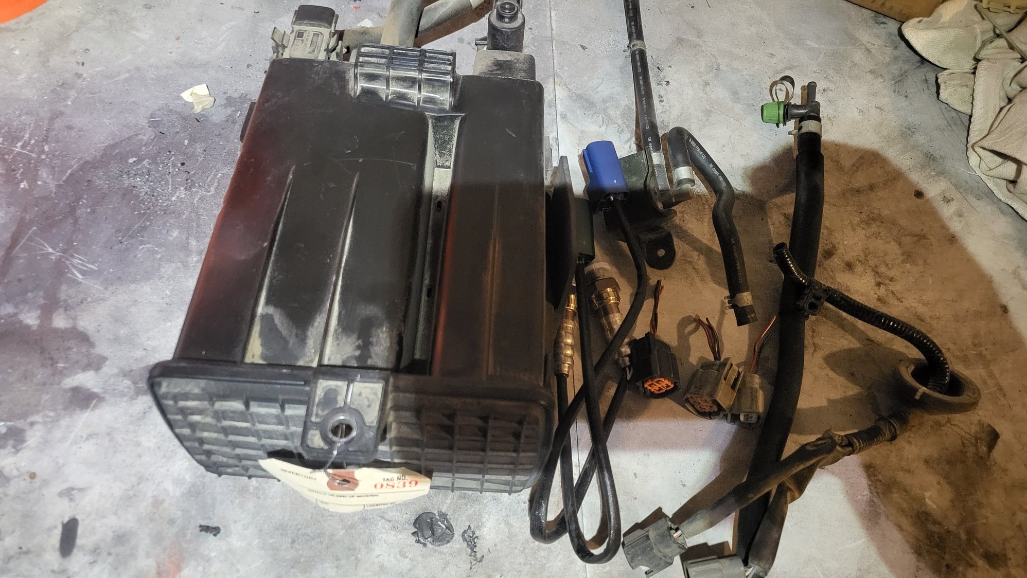

Charcoal canister installed. I could not find the bracket for sale for the canister and I don't believe it would fit either due to the exhaust now. Added some foam on the top to remove any slight wiggle room.. Use 1 pre-existing stud and bolt a bracket throuh the hatch floor.
Even though it seemed to be very secure, I added 2 eyelets with 3 zip ties just as a safety precaution. Used an existing bolt hole and bolted the other through the hatch floor.
Guess this is a way to hide it as well if you got a bumper cut lol.

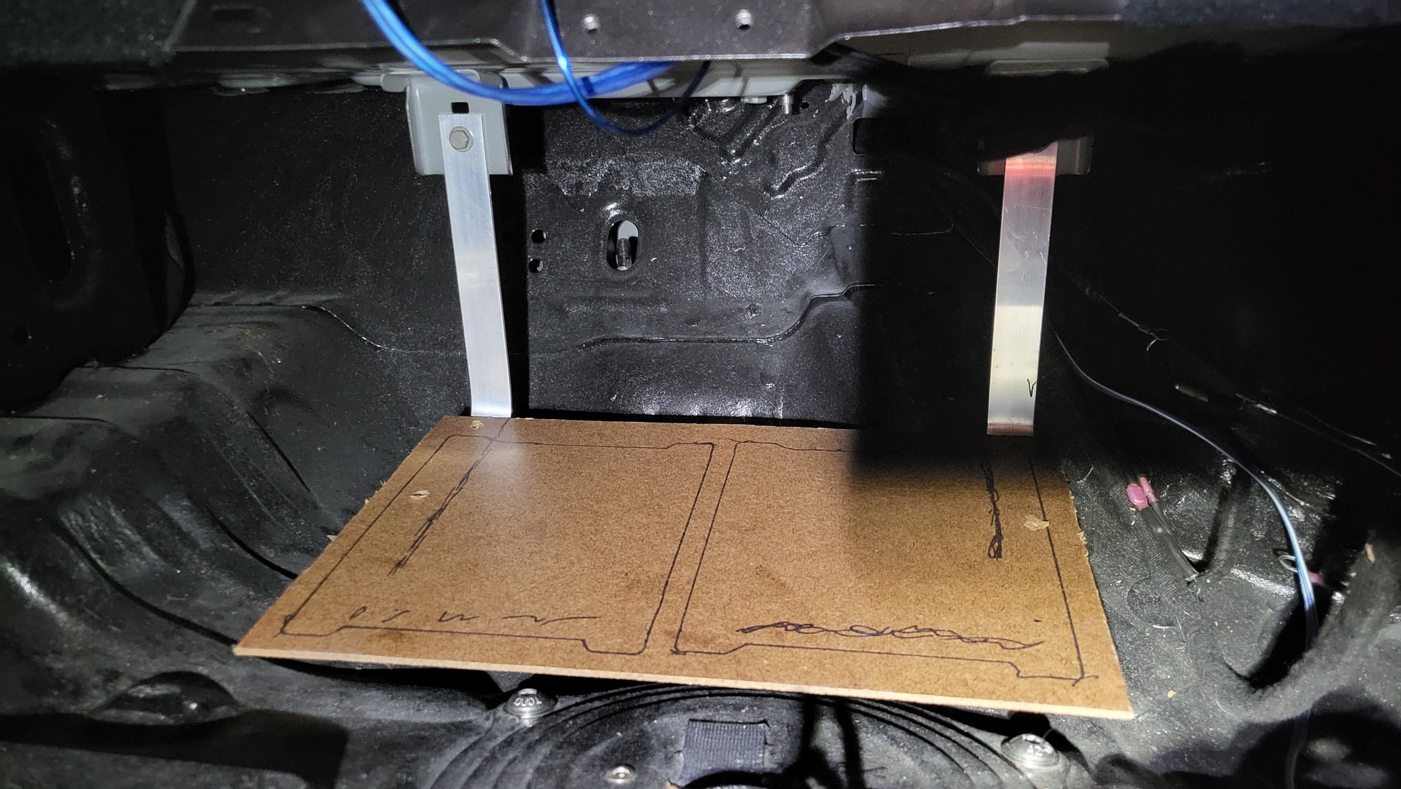

Calipers painted n stuck on the decals. Used the G2 kit, n honestly aint happy this time with the result... When I used the black G2 kit years ago, it went on great.. This time I swear the paint was so much thinner, dripped easier, coats didnt make the paint thicker by much... They work for now, but I will def be redoing them down the line.
Secondary 02 harness remade. Sensors n harness all done n installed.
Couldnt find much info on the evap vacuum delay valve. Seems like I spent $30 on a hollow piece of plastic lol.. Waiting on a barbed fitting to complete the evap system.
Also, put in some new clutch fluid.
Now - Remaking 1 of the rear floor pieces. Reinstalling oem driver belt system for street. Fixing the corbeau seat. Waiting on barbed fitting to complete evap system. Fully bleed coolant again... As long as there are no new issues, will be able to test everything this weekend.

4. The exhaust is amazing now ! No more horrible rasp below 3k rpm and the HORRIBLE decel rasp/fart is gone as well. Crazy how much the Totalflow resonaters did for the sound.

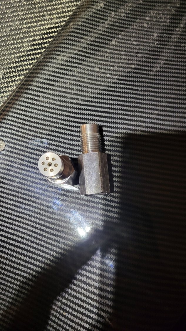

Installed these mini cat o2 sensors. Gonna try them first on the extended bung.. Hope they work. If not, I have an o2 sim on the way :P.

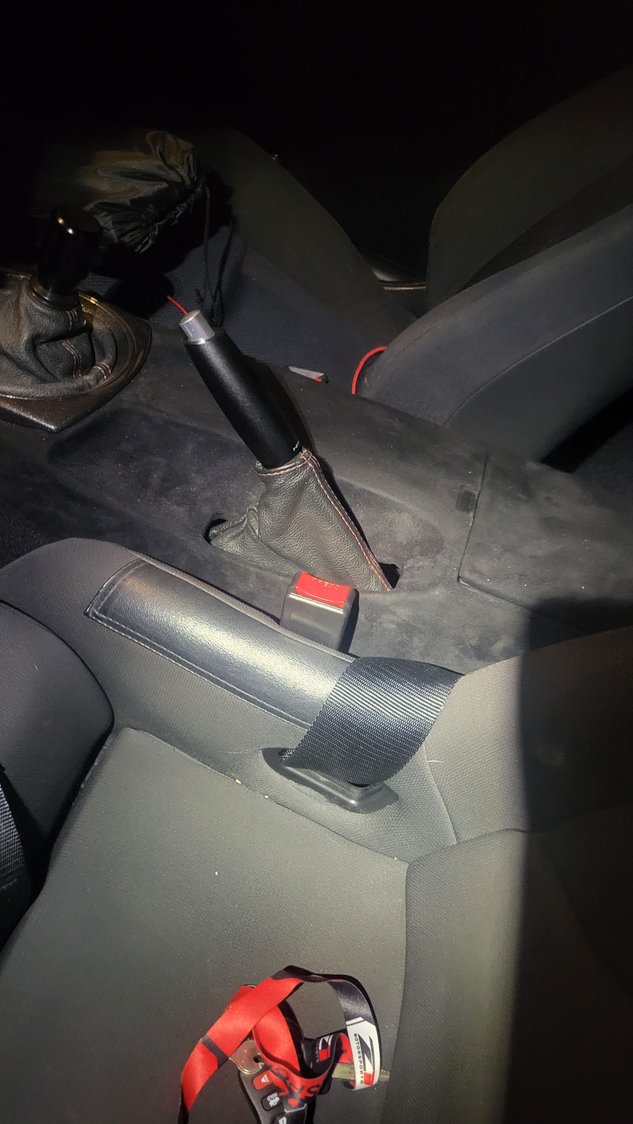

Since adding back the oem belt system, the buckle was way too far down... Never thought I would buy one of these unless I was old or 500 pounds. Got a buckle extension .

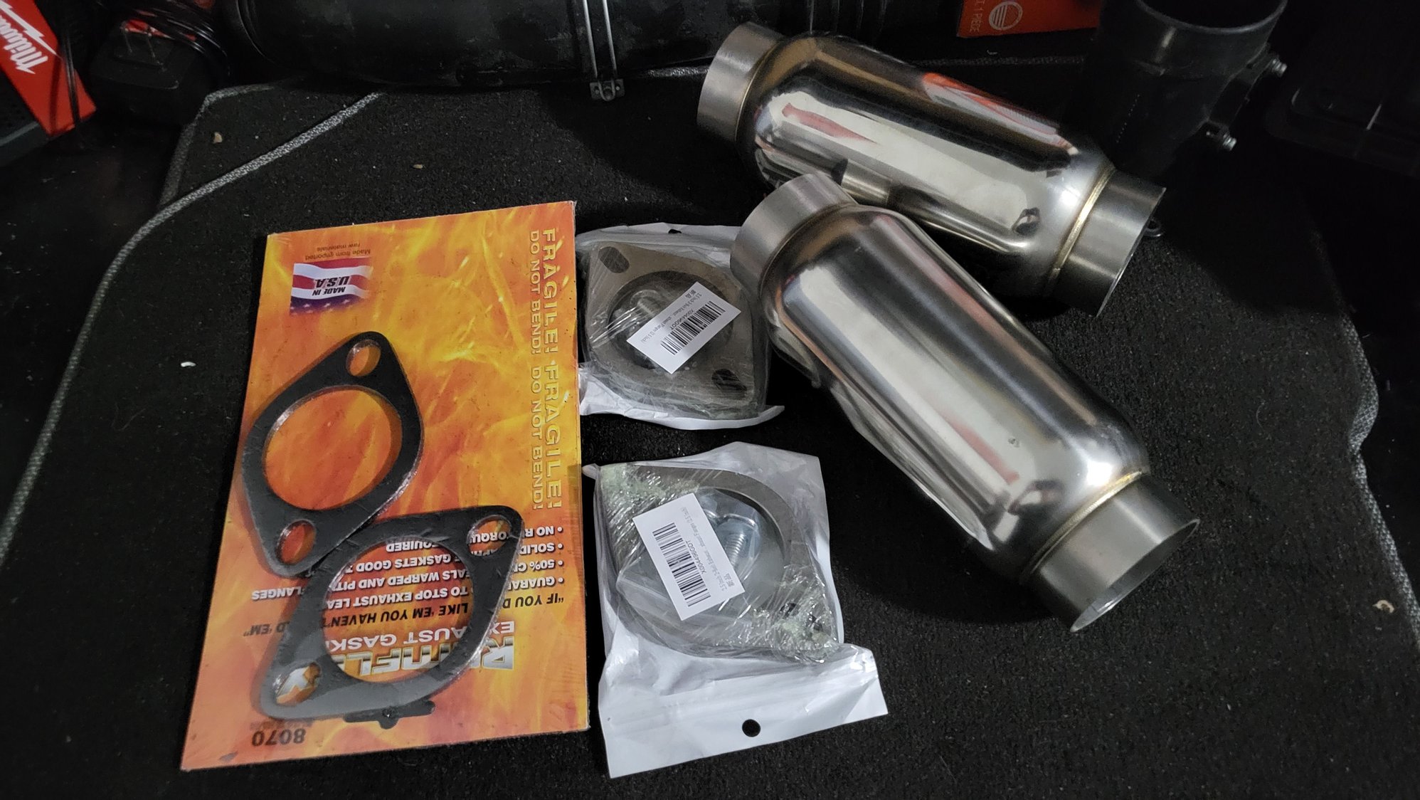

$5 for the exhaust silencers lol. They work great and fit perfect. I don't feel like an ******* when starting my car up past 7pm anymore.

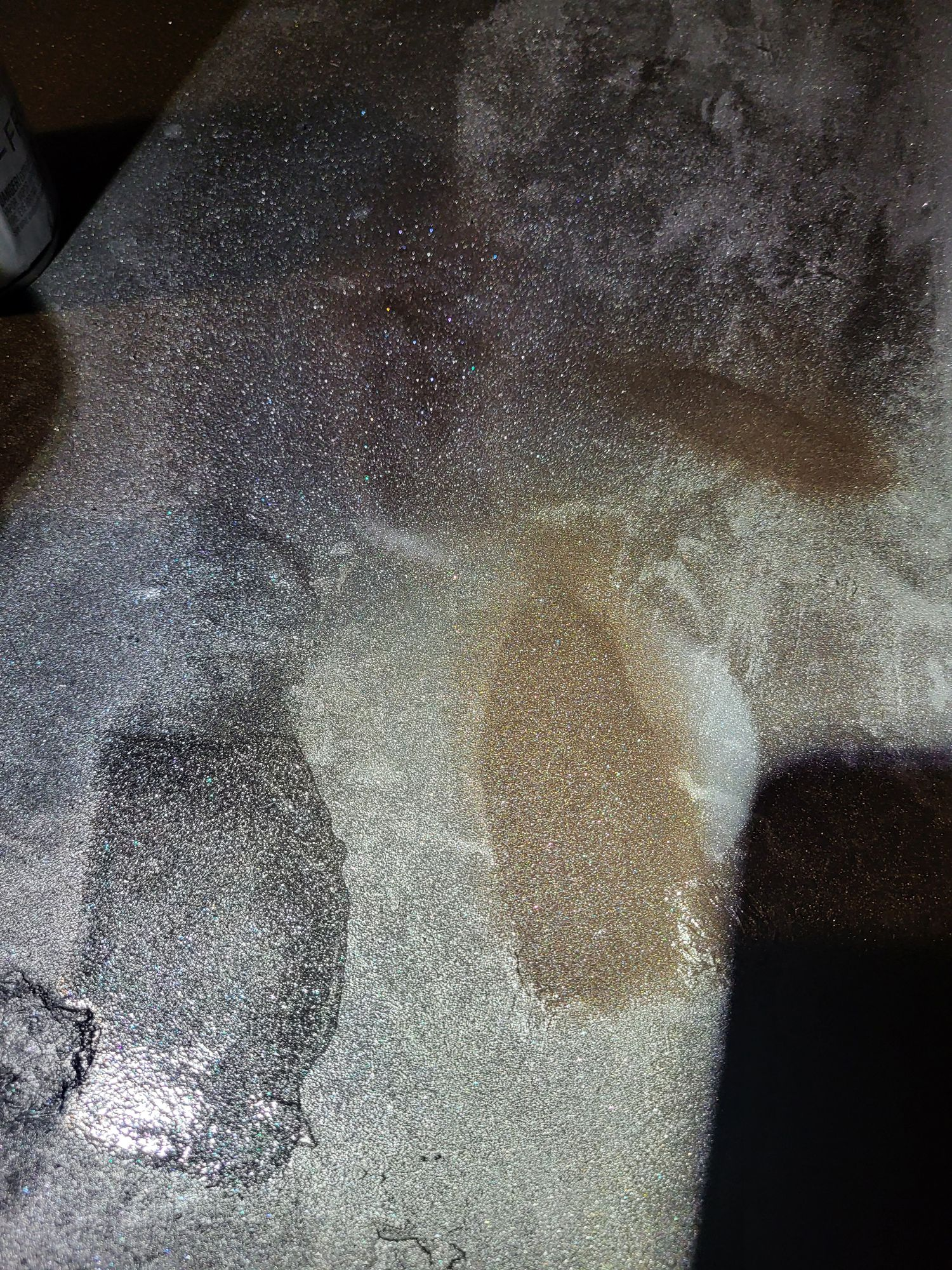

I ended up messing up the rear diffuser paint.. I forgot it was behind the table and got glue on it... Decided to try a new color on the diffuser and splitters (below) and was unhappy.. Gray just looks like primer to me, no matter what... Already painting back to the original color.

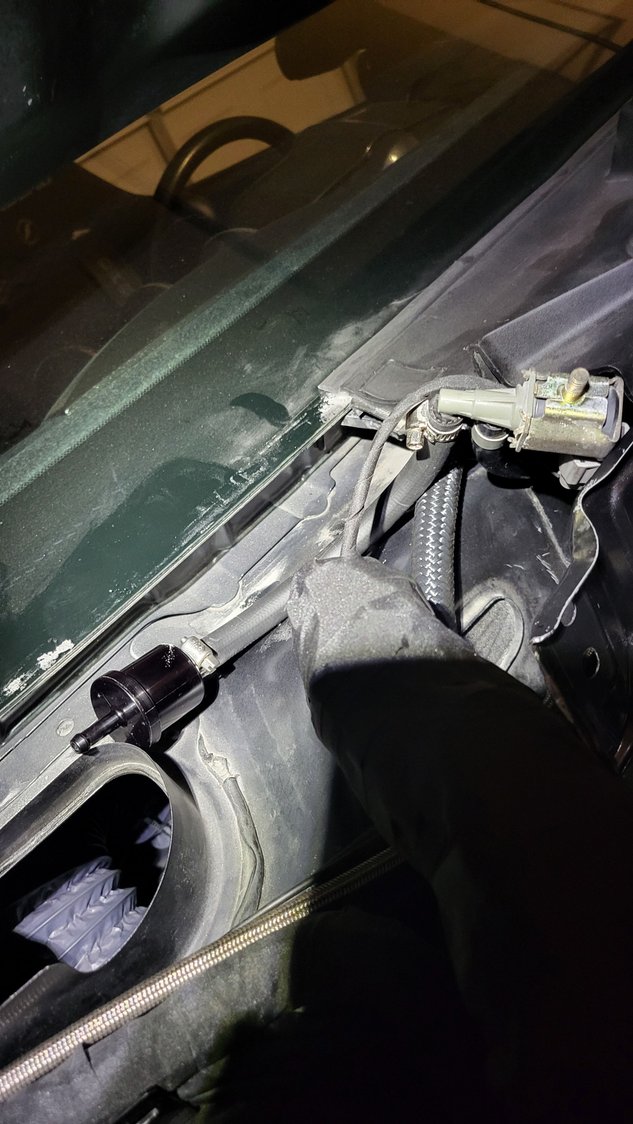

5. This is how I mouned the evap solenoid. I was gonna make a bracket but with the limited room, this works. Use the oem hole, flipped it upside down, n used a rubber washer. No longer knocking against the firewall.

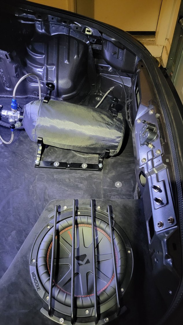

5. I remade the entire nitrous wire setup. Was the easiest way to wire in the Prog cont and fix all the issues (Correct gauges, color coded, less wire breaks, lengthed correctly, grounds to battery).. I could have moved the relays next to the fuse boxes, but I rather have everything together n deal with the extra wiring.. New in progress vs old wiring...
New wire harness, mostly wrapped up.
Nitrous panel all done... Removed the fire ex.. Wil remount in passenger area..
How I wired everything now. Prewired an opener as well.
Also, took apart the noid setup, inspected everythign, and rethreaded all connections.. Everything nitrous related works without issue now..

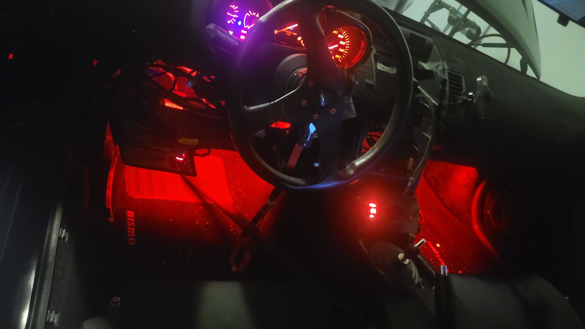

The rewiring of all accessories took a lot longer than expected.. All interior wiring is now done.. Pic was before cleaning everthing up a bit, but everything is now organized and safe. Also got the wiring for amps/speakers done. Need to get amps/make rack.

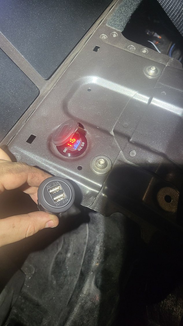

Small change lol, upped to a QC charger that also has a metal body, so no more loosening with time.

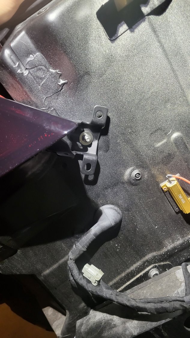

Added relay to the horns. Without a relay, they were not getting the power they needed.

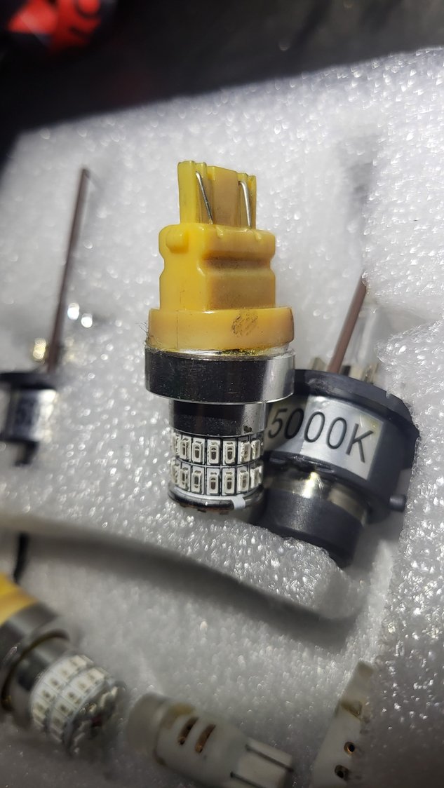

I'v read a ton of conflicting info regarding LED vs HID, mainly lght cutoff/brightness. The LEDs are defenitly way brighter in the garage though .
I ended up never going back and fixing up the wiring/resistor setup I had with the headlights. Wrapped everything up and added a harness for the resist, so easily removable.
So, PS pump is starting to make some noise.. The res was slightly below the pump, I'm gonna take a guess and say thats the reason thats its letting go (also had a PS leak on the hardline next to the pan). Put in a new res, ensuring its above the pump. Once I throw in a new pump, ill have AN fittings welded up to everything. Also changed coolers... Few years back, after switching to the open bumper.. I had a rock hit the cooler while on the highway and ended up losing PS with half the car covered in fluid. This one should be more robust..

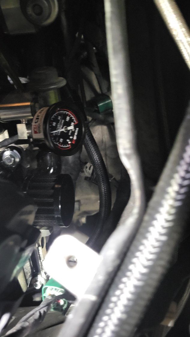

Added the fuel psi gauge in bay.
Got the new oil ttemp gauge working. Turns out there was a disconnct in the fenderwell somwhere.. But again, these issues should now be gone as everything is a full length wire now and not a single 12v wire having 3+ conns in it lol. Reocated the oil temp to the center for the future aem gauge in the pillar.
Since I'v taken away some of the tackyness/rice from the car in the last few months, I had to add some back. Added 2 simple red strips under the dash (both with a quick disc). ANDDDDDDDD
underglow.. Will I use it for not even 5 minutes in a whole year? Probably lol. I was always 'idk if i love or hate underglow' type... but the chasing effect made me buy em... Was contemplating making my own, but with the cost of this kit, it wasnt worth the hassle.
Got this Kanjo specD kit.. You pick your own lengths and it comes with everything + extras that you need for about $130. I'm waiting on 2 extra extenders I had to order, as I wanted to keep everything easily removable (panel wise). Basically Have extenders over the wheel arch that are perm and unplug near where the panels meet.. So, it will take only an extra few seconds to remove the bumpers/diffuser/sideskirts when needed.

I'd never use a LED bulb in a HID housing, let us know what you think tho.

Yeah, the main problem with those LED swaps is that the light output may be brighter or more lumens, but the LEDs don't scatter light everywhere like a halogen or HID bulb. The light only emits from the chip. They do their best to spread the light everywhere, but it's not exactly the same. That's why you get blinded by people swapping LEDs for their halogens bulbs in reflectors. The light doesn't focus properly and it goes everywhere. With an LED in a projector bowl, the light from the LED is focused through the lens, so this would eliminate blinding people since the cutoff is maintained by the cutoff shield inside of the projector, but I think you're going to lose some foreground light output.
I was able to get a small test drive in. It felt like I was in my 24 jetta (LED). A very nice upgrade compared to the HIDs, just in terms of lightput.... Not sure if I am blinding people, but the car barely gets driven at night and 50%+ of the crossovers/SUVs/trucks blind the living fk outta me in the jetta, so Ia int worried about tht.
Finished the underglow install. Was honestly way more time consuming then I thought it would be to get it all done. This is how the connections are done, easy to get to, but also secure.
Pic of it on. Underglow def looks better when it covers the whole car, n not just portions like the $30 kits give.
I forgot to mention when replacing the HIDs, I replaced the daylight n turn signal bulbs as well... These are the old ones from Diode Dynamics.. Not too sure on what is going on with em... But they are replaced anyways.
Started the mock up for the amps. I was trying to get ideas and pretty much was just stuck on threads frrom 03-07 here. Crazy seeing how much work people would put into audio installs and just DIYs back then... Not sure if people just dont care now, only go with premade parts, or maybe just are not as skilled in general? Early 2000's was just custom everything.
Bottom.
Installed before the cleanup. From indep testing, these amps seem to perm very well and not have bloated specs. like only $90 each.
Only have done a little tuning, and the music already is SO much better. I'm not sure if it was just being in cars with nice systems or if gutting the car just made all the noise drown out the music at reasonable levels... BUT, I can now make the music louder then the exhuast while crusing lol. Made everything easy to remove when needed. Rewired the sub for 4 ohms. While doing this, the loc no longer triggers the amps (didnt think of that), so I had to run a wire to the aux fuse box for 12 trigger.

While throwing the seat back in, hit the console.. There is a slight difference in color between the 2 center peices + this scratch + a clear drip... So I will repaint these soon.. ALSO! Turns out they are diff colors bc an issue with the paint, not my painting lol.. Below are 2 diff cans of the same color lol.
Should not be that brown.

Alllright.... Turns out, that sensor being pushed in all the way was 100% causing my issue :P. Car feels normal again without the brakes being constantly pushed down....
The first thing I fked up on this car was stripping one of the strut bar threads when I first removed/installed it a while back. I'm pretty sure I just forced a new bolt of the same specs into it with some oil to 'fix' the threads. Turns out, it was only being held in with 2 threads this whole time, as they decided o finally give up. First time using a helicoil.. Very easy and forgiving to work with. So thats fixed now..
I can't wait to refinish the bay...
Notes:
1. The headlight cutoff is high now, gonna see about adjusting it lower.
2. The purge solenoid is still loud af, its muffled now with the mount/bushing, but still, sounds horrible. Probably gonna buy a new one.

On tues, I got an appt for the exhaust. Adding in more resonators.. should be the last of it. Also gettin rid of the leaking vbands.

Update: Had the exhaust work done. Very happy with it. No more leaking Vbands (waste of $200) and exhaust once again sounds better than it did before. Contemplating putting on ONE more set or res test pipes lol... It just sounds so much better every time.

So the car is up in the air right now with every front suspension component removed, have some coolant leaks so I figured I'd deal with reverting back to rubber lines and doing the pathfinder mod. Shop that did my compression rods a while ago broke one of the bolts for the front crossmember so I need to try to extract that too.
By "off year" I mean a year where I don't drive the car.
I'm also removing the headers so I can get them coated, since it's basically the easiest time to do it. All that aside, there is a problem that I'm trying to figure the best outcome for.
I want to change the crossmembers up front, obviously steering rack has to come off and the enging needs to be supported. My A-frame is in the garage above the car, so I can't get to it without risking damaging the car, and the steering rack is also leaking.
So, do I buy another A-frame and then try to sell it, do I try to get it down, do I leave the crossmember and leaking rack on the car and have to deal with it at a later time, decisions decisions...
Car has oil leaks which I need to fix but one of them is a rear main, i have no desire to do it myself, but at the same time i have yet to find a shop i can fully trust with this car. Problem is when you wrench for a living, it's not as nice to work some more on your time off lol.

Gotcha.. I'm in the same situation with you with the rear main and rack lol. Engine has 124k - Not worth doin the main seal, at least to me with how much it is currently leaking. I'd personally pick the side where you can do everything at once, but selling **** local sucks. Finding a shop you trust is hard af honestly... At least they didnt snap the frame stud :P.
