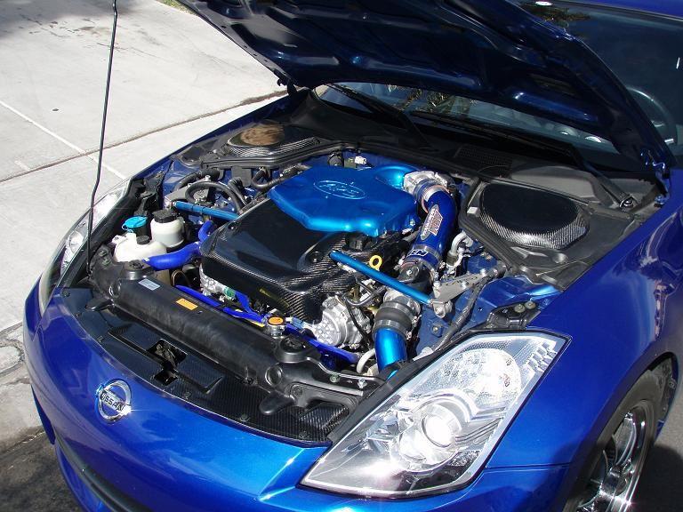

Some quick points... G35's have a longer wheelbase than the 350Z, so any G35 exhaust would have to be shortened to fit. The MREV2 makes gains by lowering peak torque in the rev range. HP is just a way of showing torque vs rpm. It's not actually measured, it's calculated by multiplying torque by rpm and dividing by 5252. I had an '06 Rev-Up and preferred the top end HP of my engine over the low end torque of the DE engine. If you prefer low end torque, do the MREV2. If you prefer keeping the revs up, don't spend the money. If you want a better plenum, and want to keep your top-end power, search out an old APS plenum. That's what I had. I also had the Borla because I wanted more power without that VQ35 buzz. The sound is very bass heavy without the treble. I made 281 whp with my set-up. I had just about every bolt-on (stock TB that I gasket matched and cleaned up). I was about to do cams, but sold the car. Here's what my engine bay looked like...
