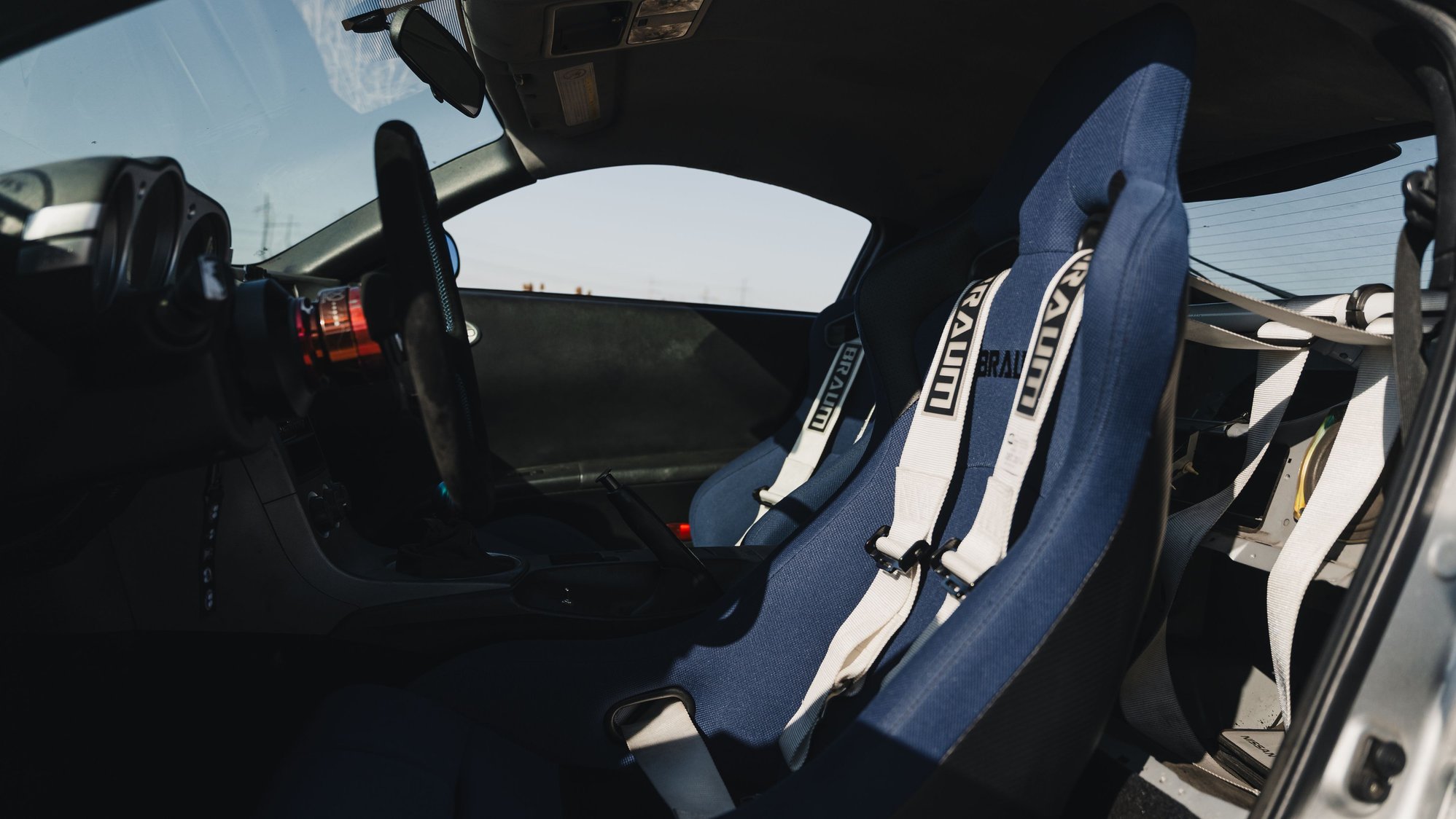

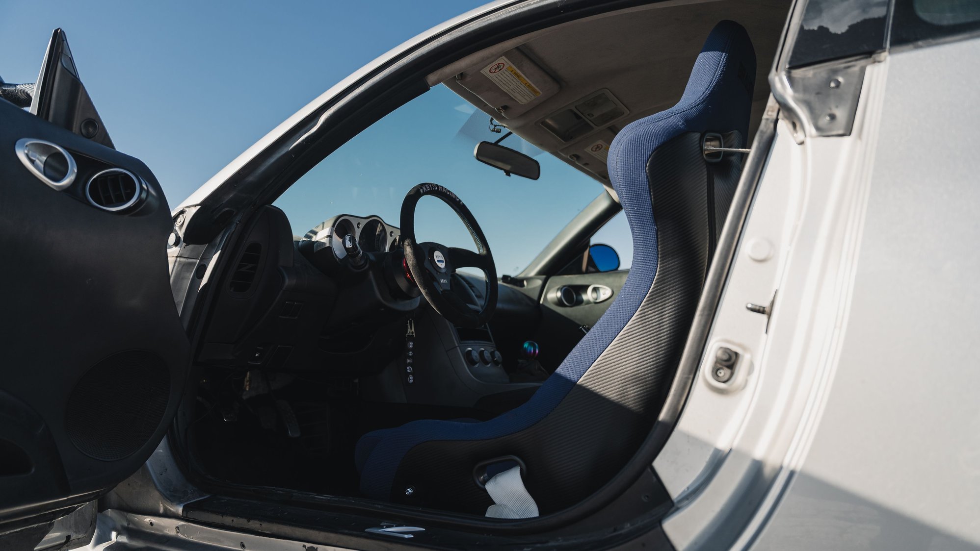

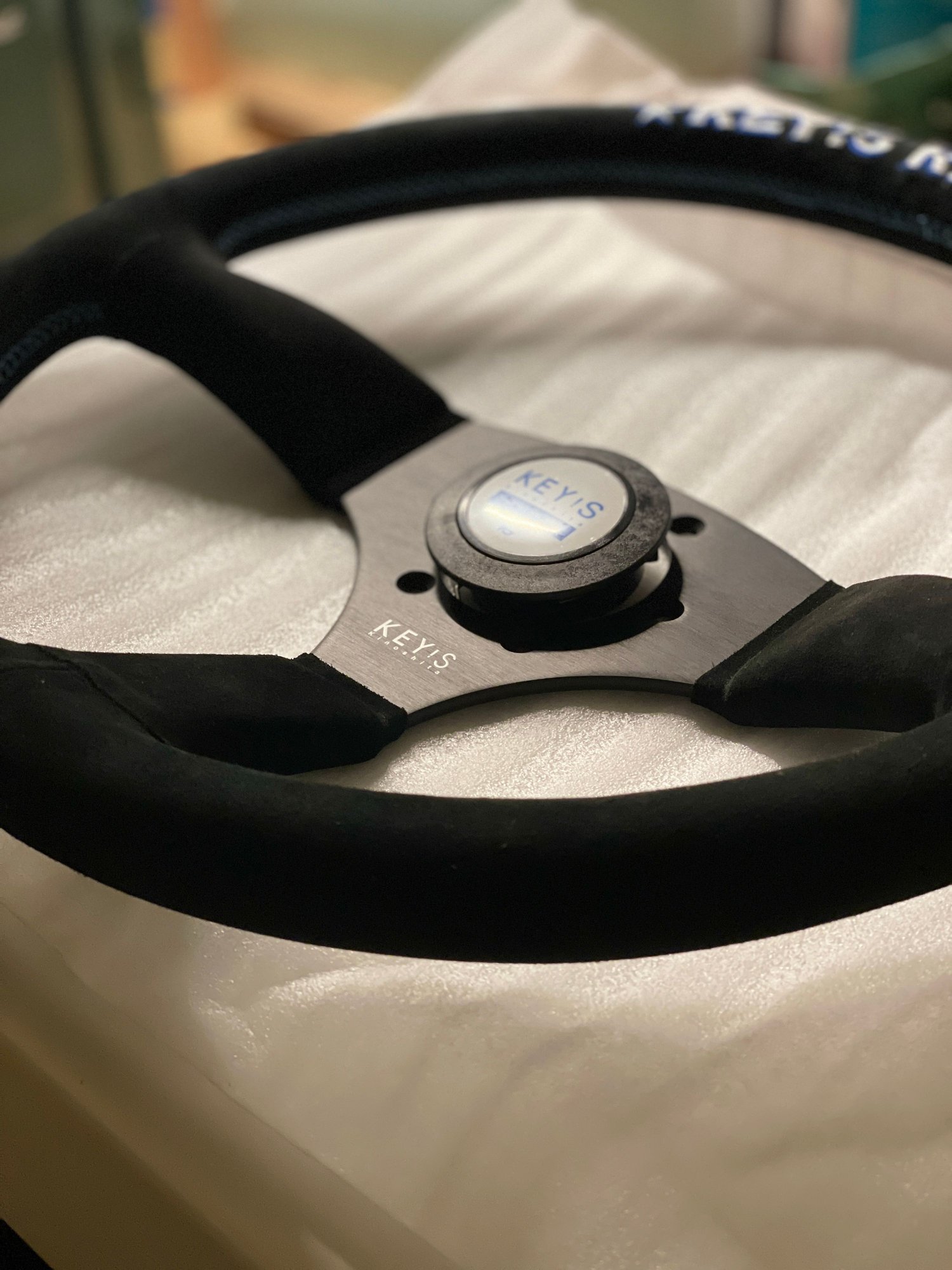

Interior
  • Removed all interior from seats back
  • Keys Racing Drift Type Steering Wheel
  • BRAUM VENOM-R Fixed Back Bucket Seat (Driver)
  • BRAUM Elite Series Sport Reclinable Seat (Passenger
  • BRAUM White 5-point harnesses
  • BRAUM Dual Lock Sliders
  • BRAUM White Harness Bar

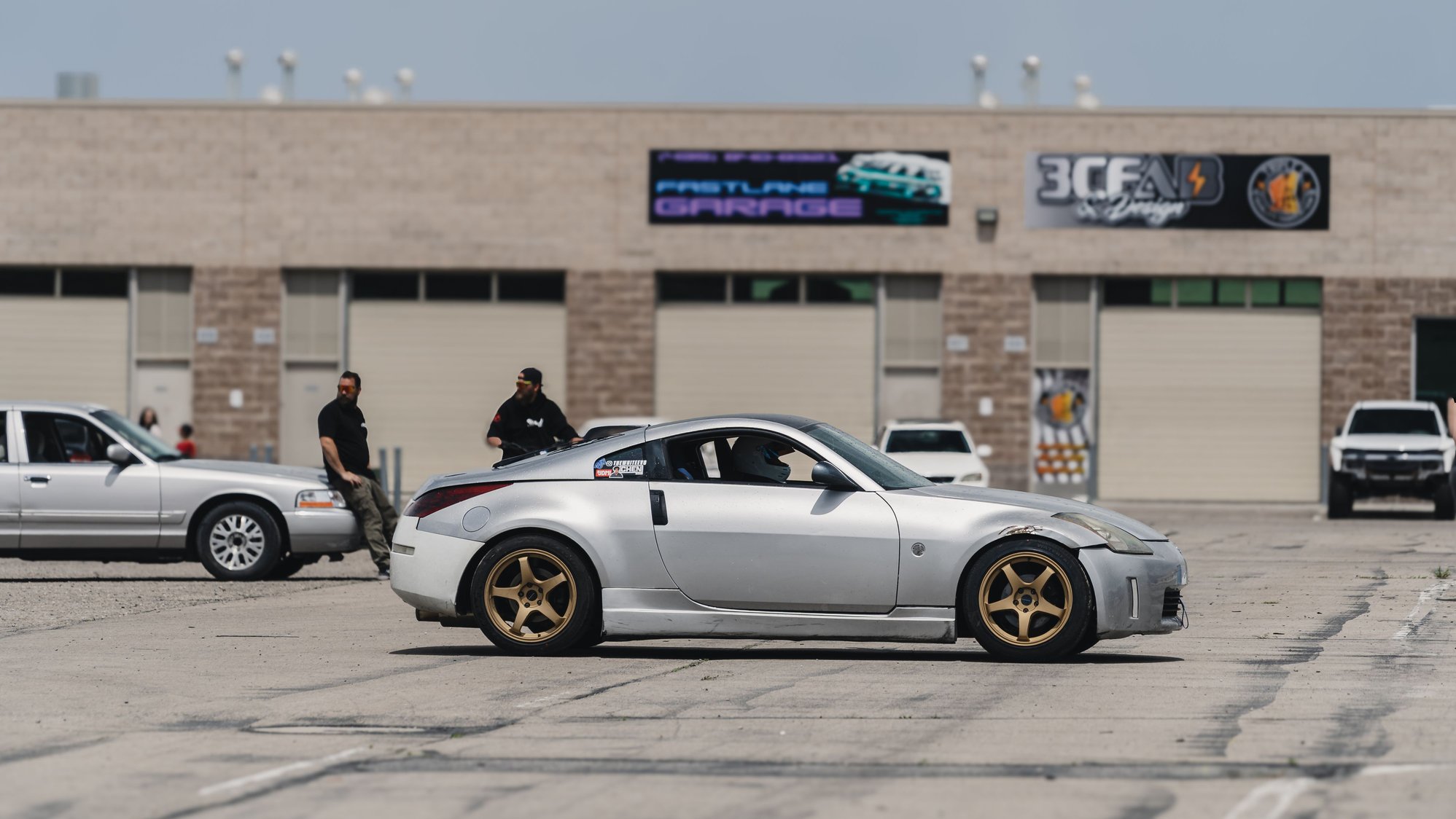

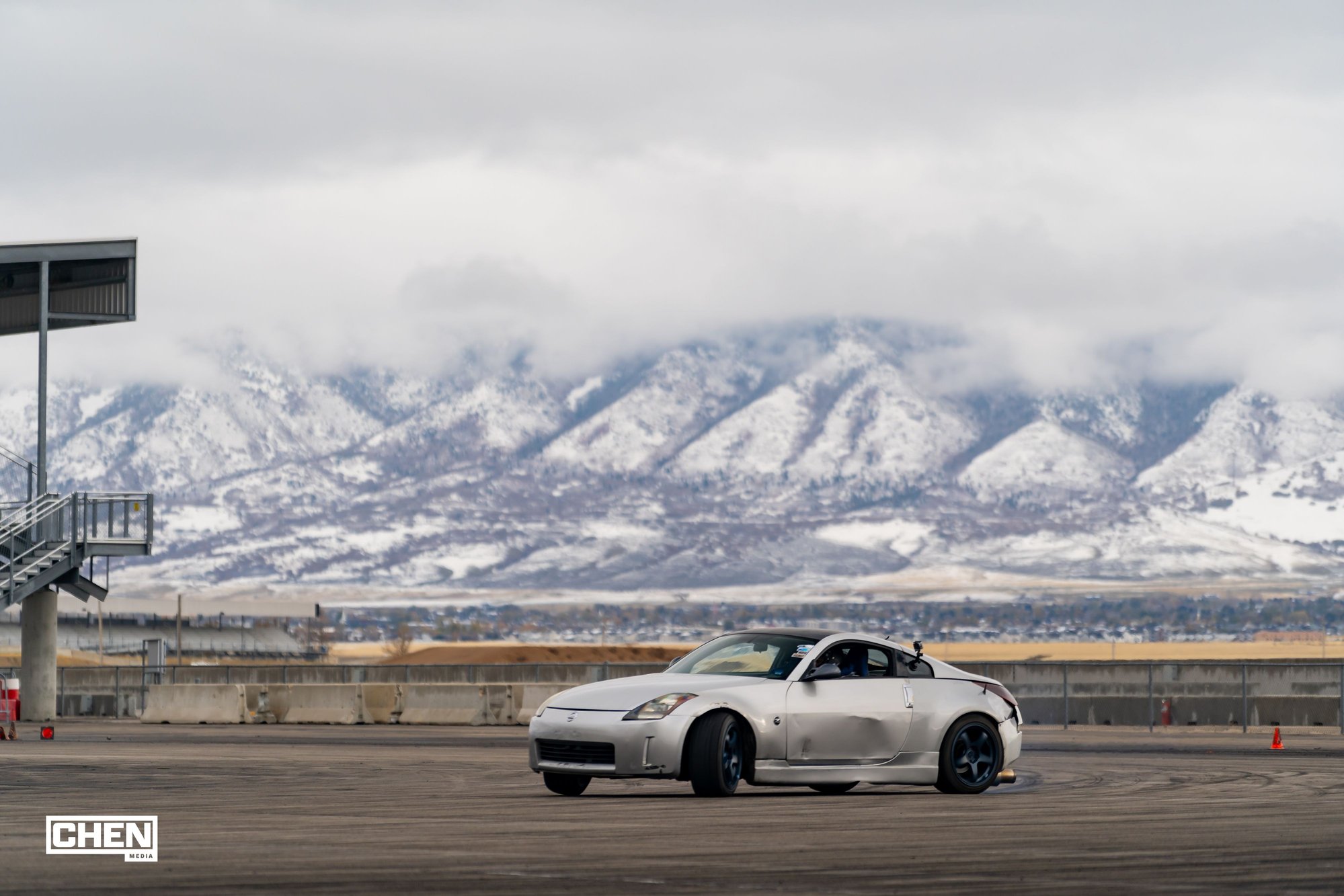

Since getting the car repaired and ready for the street I hit up a couple of our local drift events!
First event:
Second event:

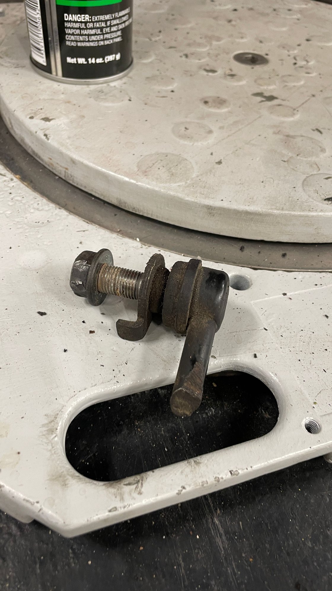

I did a local drift school but the only photos I have are from when I ate through my tie rods and had a bad hymn joint.
Third event: Halloween!
4th event:
Here is a video from my last event-
Definitely still have a lot to learn! There was an event on the kart track in January that I went to but after one session out the car started blowing the ecm fuse. I lose throttle on track and the car shut off. Its definitely a short and a bunch of guys tried to help diag it at the event so I could get back out. We got it started a couple times but ultimately it kept blowing immediately so I didnt get to run the event.
Ive fixed a lot of wiring since the event but unfortunately haven't found the short causing the issue. I dropped it off at my local jdm shop for them to work their magic and get a fresh set of eyes on it. Hopefully I can make the next event which is on the main track and should help me get more comfortable pushing the car!

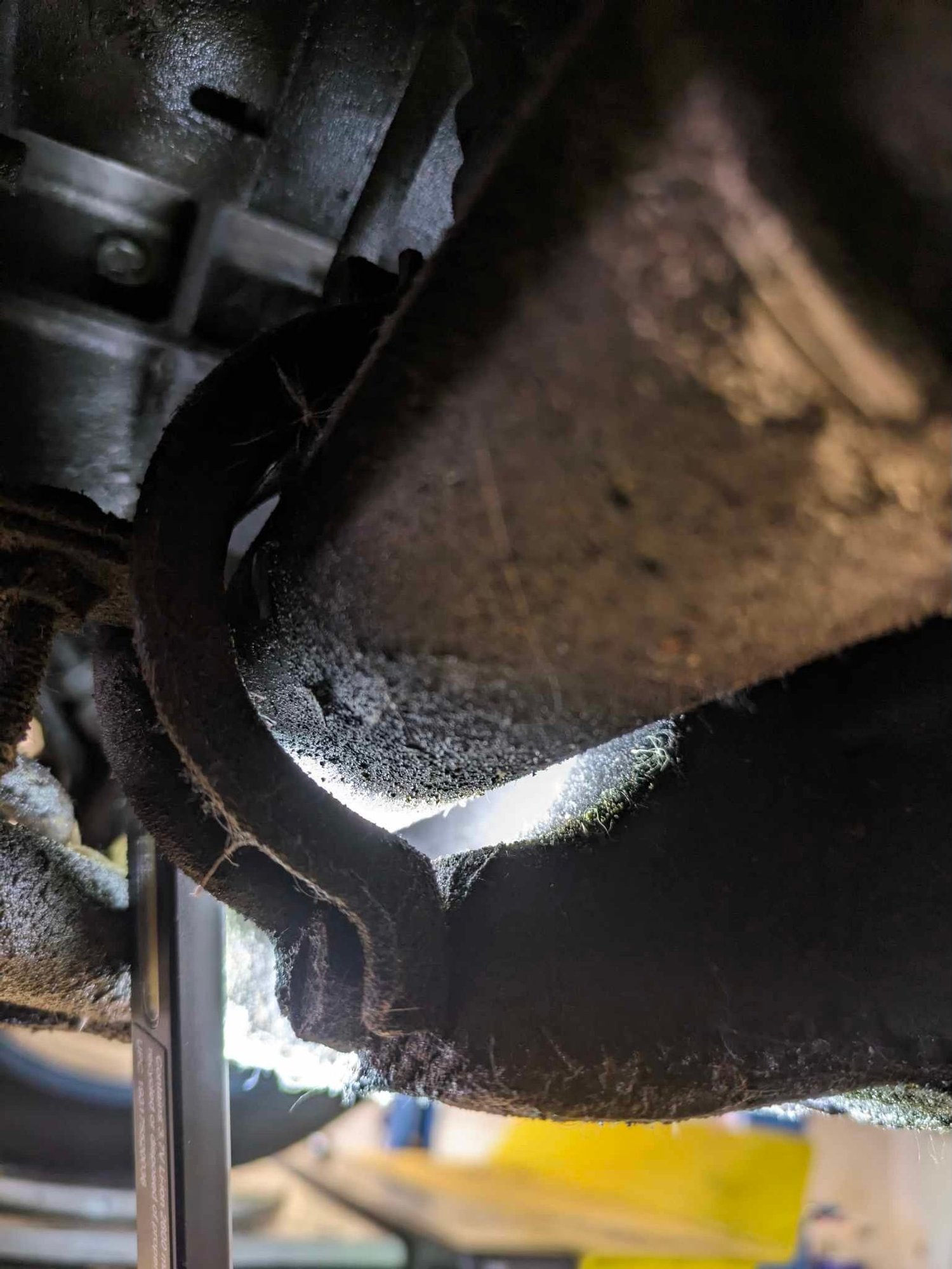

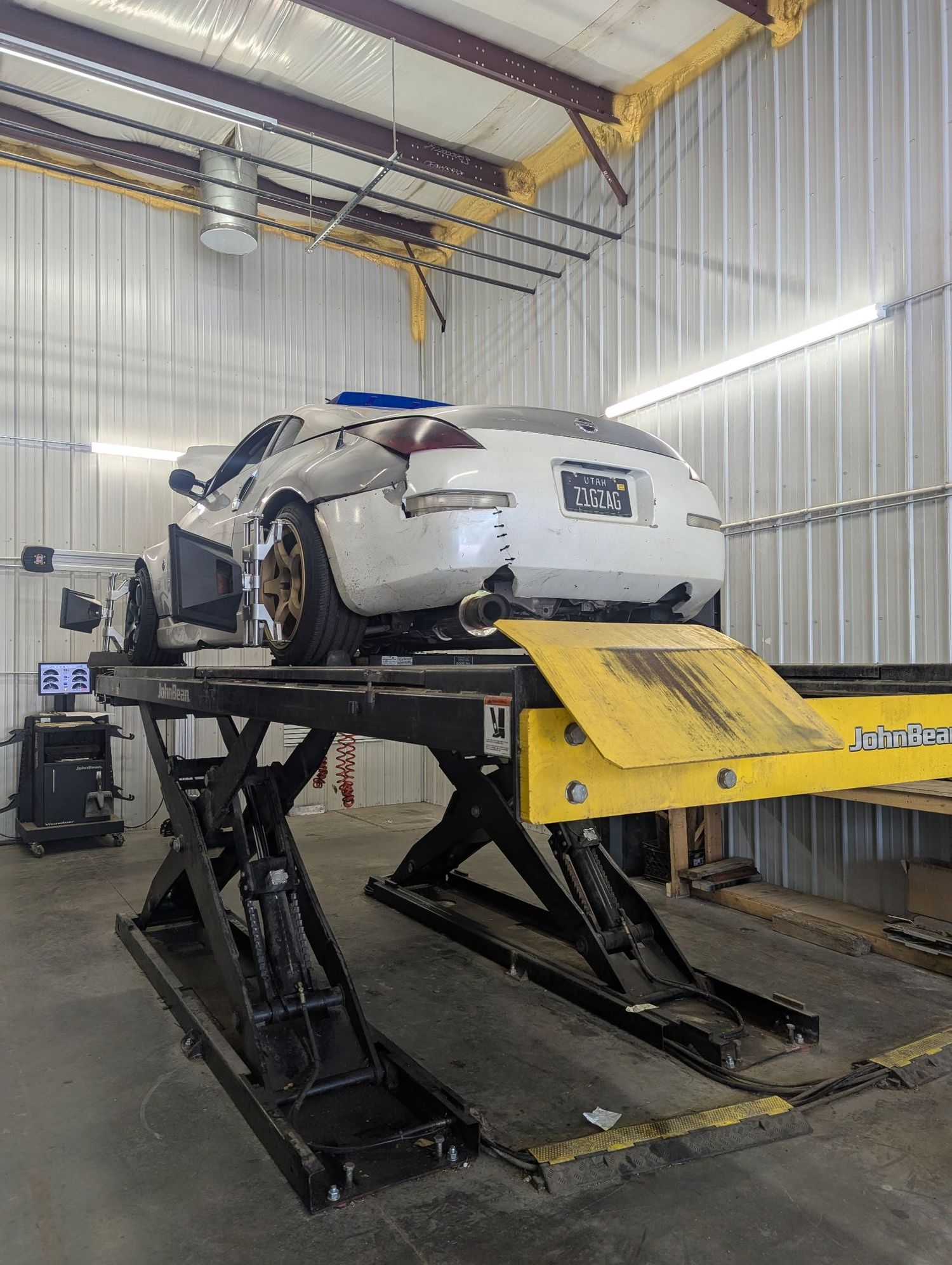

We confirmed we needed to start with replacing the passenger LCA on the Z as that was the only part we could see a slight bend in. I sourced a used one locally, GKTech V1. We got that installed along with front lower ball joints, top off coolant, top off engine oil, plug PCV on the back of the motor (the hose that goes to the stock intake), 4WA, better attached the exhaust in the middle of the car and test drove!
A week later I drove the Silverado from Salt Lake to Cheyenne to pick up the Z and towed it up to Sturgis in SD for the SD 2 day drift event.
The event was amazing! There were so many amenities, on site full gas station, two seperate track layouts, constant shade via the dome, and cabins you can rent that featured a shower, beds, fridge, microwave, heat and a/c! The event itself was well organized, including a 24 car competition, and everyone was extremely nice and respectful.
The Z felt great once I started to get the hang of the track layout, however it started puking engine oil out. We found the leak coming from the spark plug oil tubes. The spark plug holes were completely flooded and oil coming out the tops and running down the manifolds. The RTV used to as a gasket when I had the valve cover gaskets done in May did not hold very long. We tried a few temporary fixes just to get some more laps this weekend but none of them were holding. Im thinking of trying these seals out since my car has the upgraded aluminum valve covers, does anyone have experience with these?
