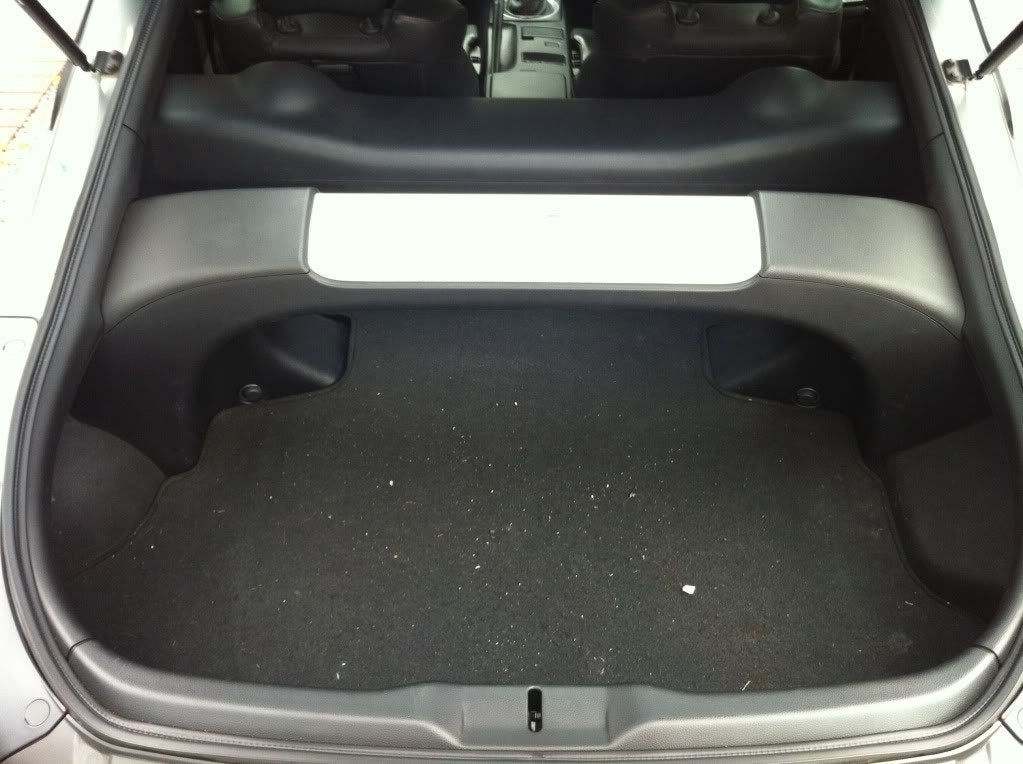

Trunk rattle driving me insane

he is talking about this
This thing is very noisey on these cars. Sometimes you just kind of have to slap it or move it around and the noise goes away
Are you guys talking about that big sway bar going across? Seems fine to me when I grab and shake it. Anything in particular I should look out for?
why wouldnt it.. it mounts below the rear strut bar in the trunk, and top of the arch in the wheel well, hence it will make the sound come from that area
Well I took a pic of it but not sure what I can tell from jaut a pic. My mechanic said they can check for $150

The black plastic piece with the 10mm hex heads (screws/bolts) is part of the rear tail-light assembly.
So once Again I just drove my car after jts been sitting in the sun for hours and rattling ans creaking is 100% gone.
I'm almost convinced its the suspension as mentioned above. What else could be so temperature sensitive?

The 3rd brake light & plastic shield will be heavily impacted by temperature changes. This is one of the 1st items I mentioned in your other post. A simple test for the shield/shade you can do is wedge something soft between the glass and plastic shade piece (obviously nothing so large that you permanently deform the piece or scratch the glass). Sometimes this will stop the noise. That being said, what I discovered in my case, was the 3rd (high mount) light itself or more specifically the plastic frame for the LED light bar was rubbing/tapping against the metal of the hatch. To test and verify you would need to remove some of the paneling on the hatch to gain access to the 3rd brake light.
-Icer
I remember checking the 3rd brake light like you said but the plastic cover doesn't seem to move around at all. But I'll try wedging something in it either way to test. Have to wait to next morning or tonight when it gets colder again

Update: I managed to reach back and hold the third brake light cover in place while driving and it wasn't the cause of the rattle. Bad news is I aggravated my bad shoulder doing that.
