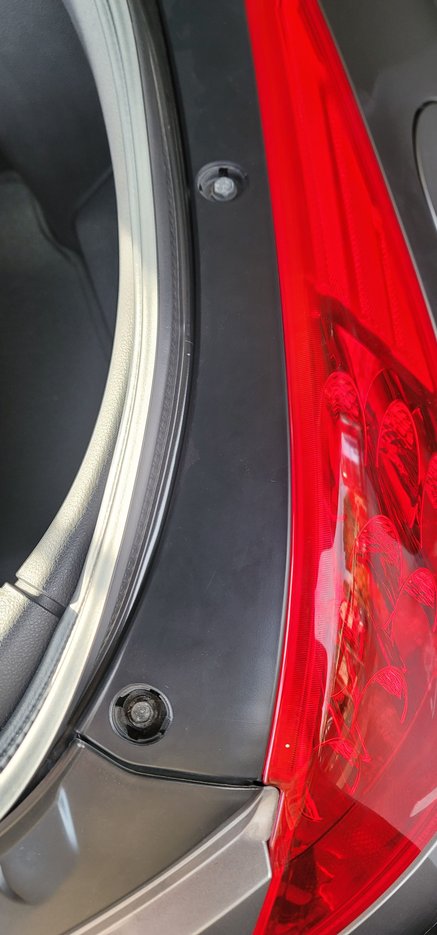

Thank you for the pic. Any way I can test this without having to raise the car?
My only thing is it rially doesn't sound like metal rattling. It sounds like plastic over plastic.
I just noticed this morning that this part squeaks and creaks when you press on it. It looks pretty tight but I can try to find a wrench and tighten it more.
I doubt your tail lights are the cause of the noise, as those live outside the hatch seal and are held tight when the hatch is closed. I wouldn't overtighten those either, you can easily break the plastic if you're not careful.

I'll check all that again and hopefully I identify those parts correctly..not.sure what the tower braces are but I'll look.it up.
Also I didn't mean the brake lights and meant the black plastic piece with the screws in my pic. It squeaks when I press down on it but other side doesn't
